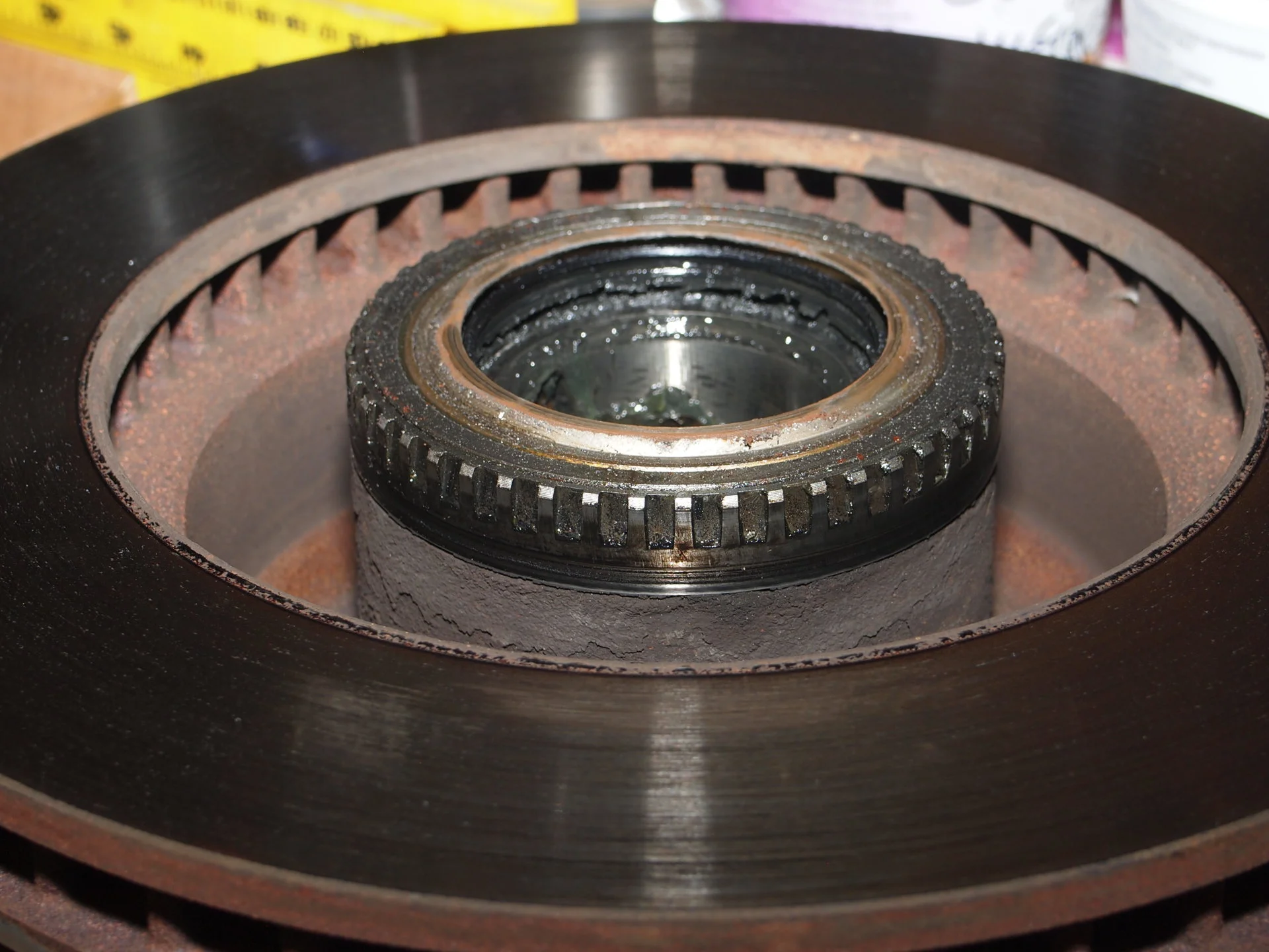

Wheel hub seal in backward, with metal lip out. Metal will grind down as you drive, and wheel bearing loosen very fast and become a great deal looser. This set up a dangerous condition. Where brake rotors may detach form wheel hub, than wheels can than fall off while driving. Earlier symptom of wheel bearings too loose, is hub wobble confusing wheel speed sensor into kicking on ATAC.
WRONG installation of seal.
Correct

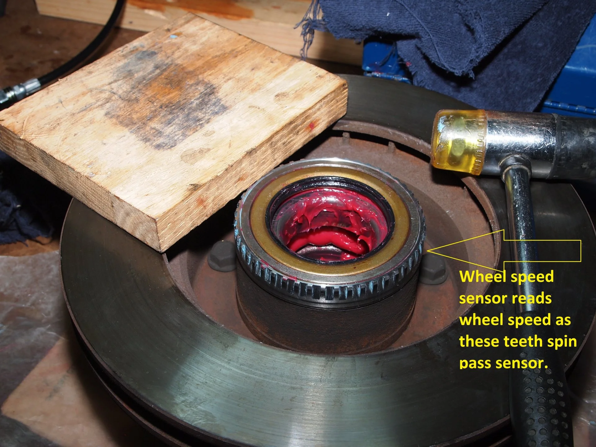

Removing Air Pockets
Pushing grease and air pockets out while mounting brake rotor hub on spindle
It was a snug tight fit to get the brake rotor with new oil seals seated (You're pushing against thick bearing grease and air pockets trapped in the cavity and both wheel bearings).
Some turns with a pushing force will settle it on the spindle. When its seated deep enough on the spindle, you can use the 54mm lock nut and its spindle threads to squeeze the rotor against the steering knuckle to get more air pockets out.
Rest of the air gaps (FDS to spindle to hub flange)
For getting the rest of the air gaps out, that's a job for one of those axle / hub flange puller tools (also sold by some mud members).

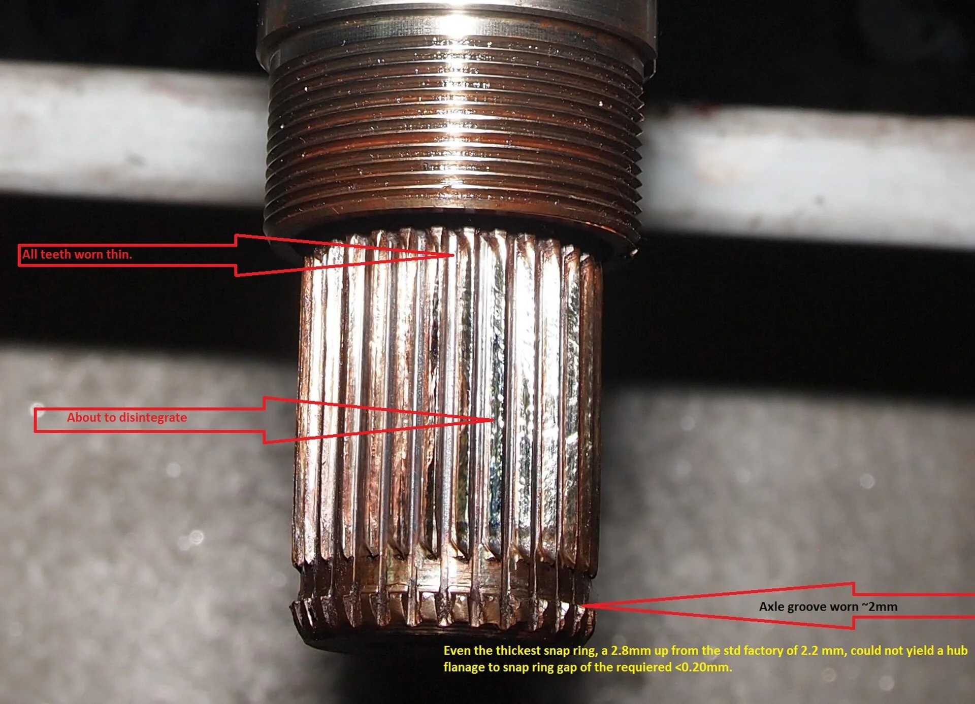

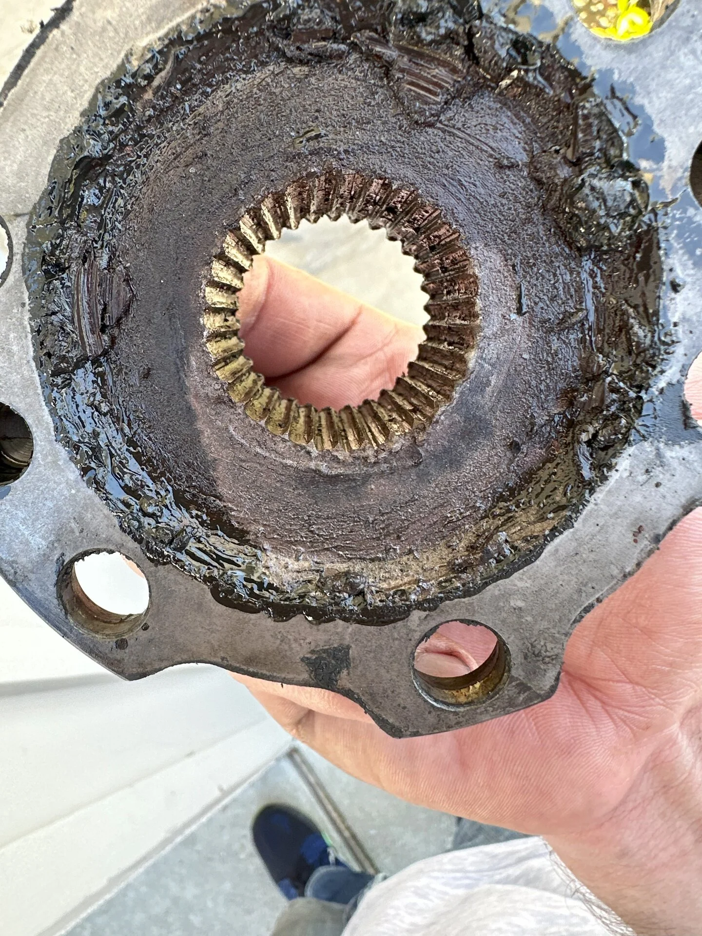

Just bumping this to say thank you to everyone who has posted the last ~150 or so comments. I tackled this today and ran through it pretty effortlessly. I re-used the bearings in there as they were fine, the whole assembly was just finger loose when I pulled the flange off. Took about 57lb ft to achieve a 10lb breakaway (thank you @2001LC for the fish scale video and some of the research on the matter). Did rotors and pads while I was in there because I don't plan to go back in any time for the next 30k mi or so. Tomorrow is the drivers side.
Also, check out how chewed up these flanges were. Replaced those too. The teeth are almost all to a point.
When hub flange splines chewed/worn down. Axle splines, not far behind.

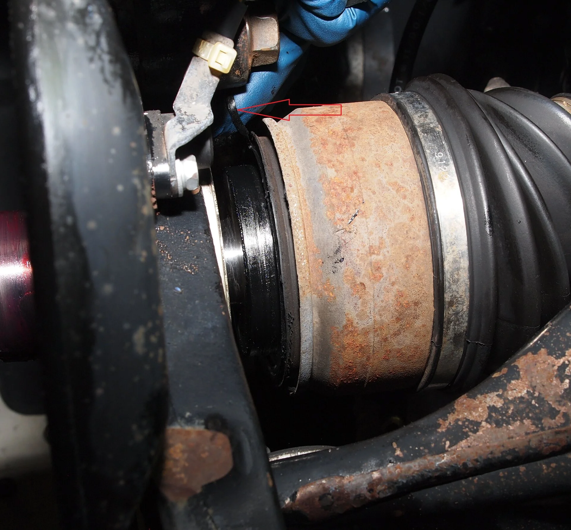

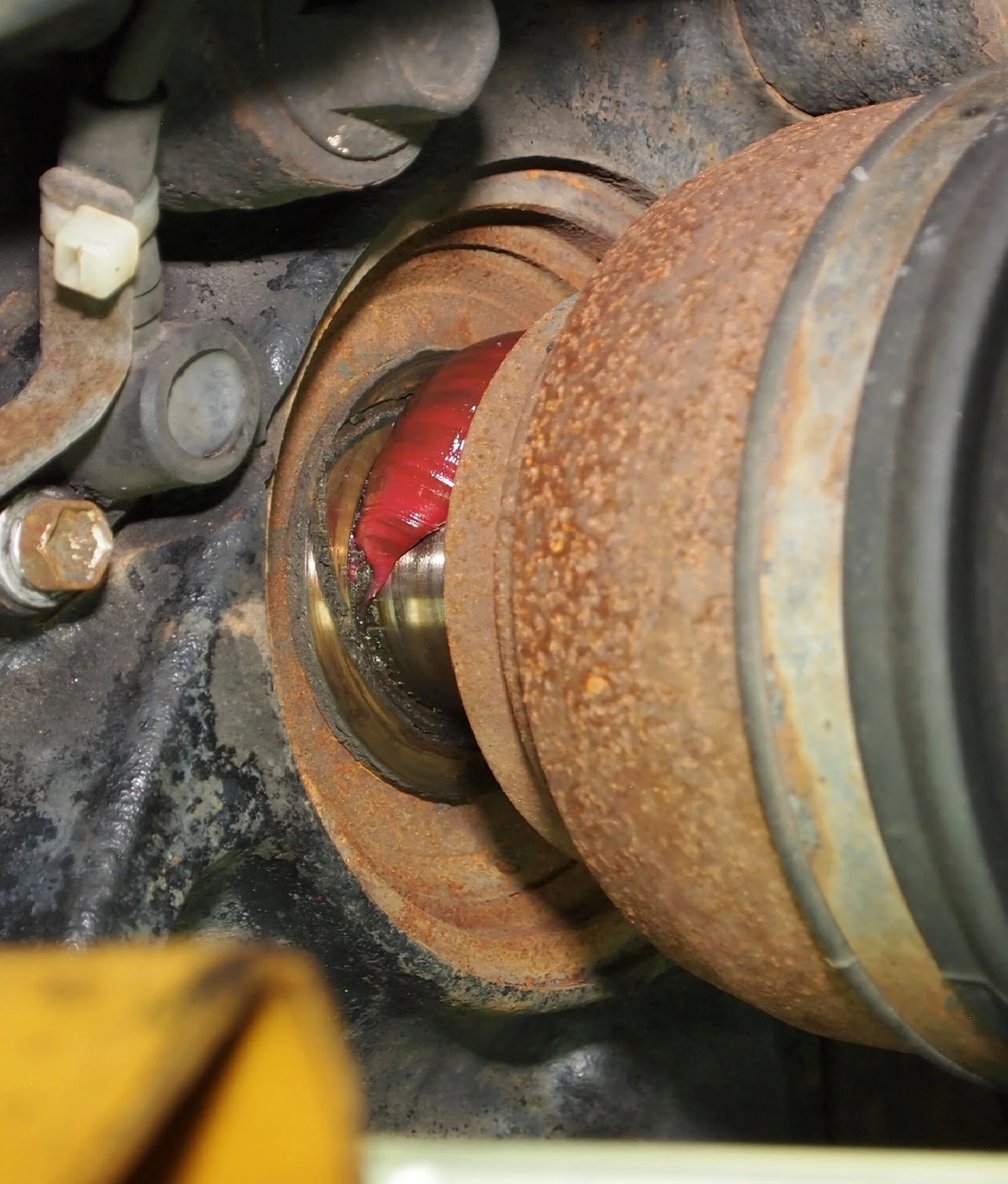

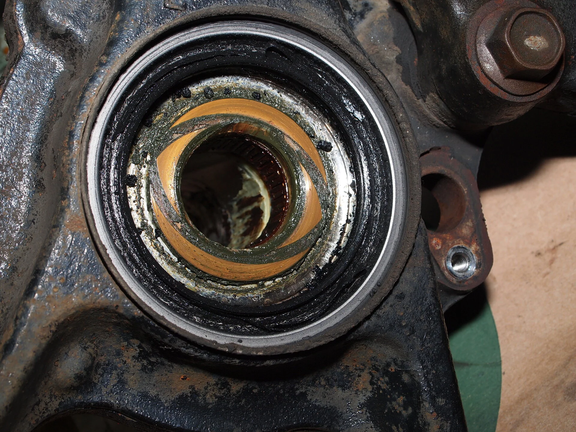

We also need to check for contamination in axle bearing & bushing, before lubing them. Along with condition of axle seal and knuckle seal.
Missing both the FDS outer axle seal and knuckle seal
It actually has had two new FDS done by the dealer in the last 40-50k mi. Not sure why no one ever looked at the flanges.
Though, by the quality of the repack job they did, I should check for those seals.

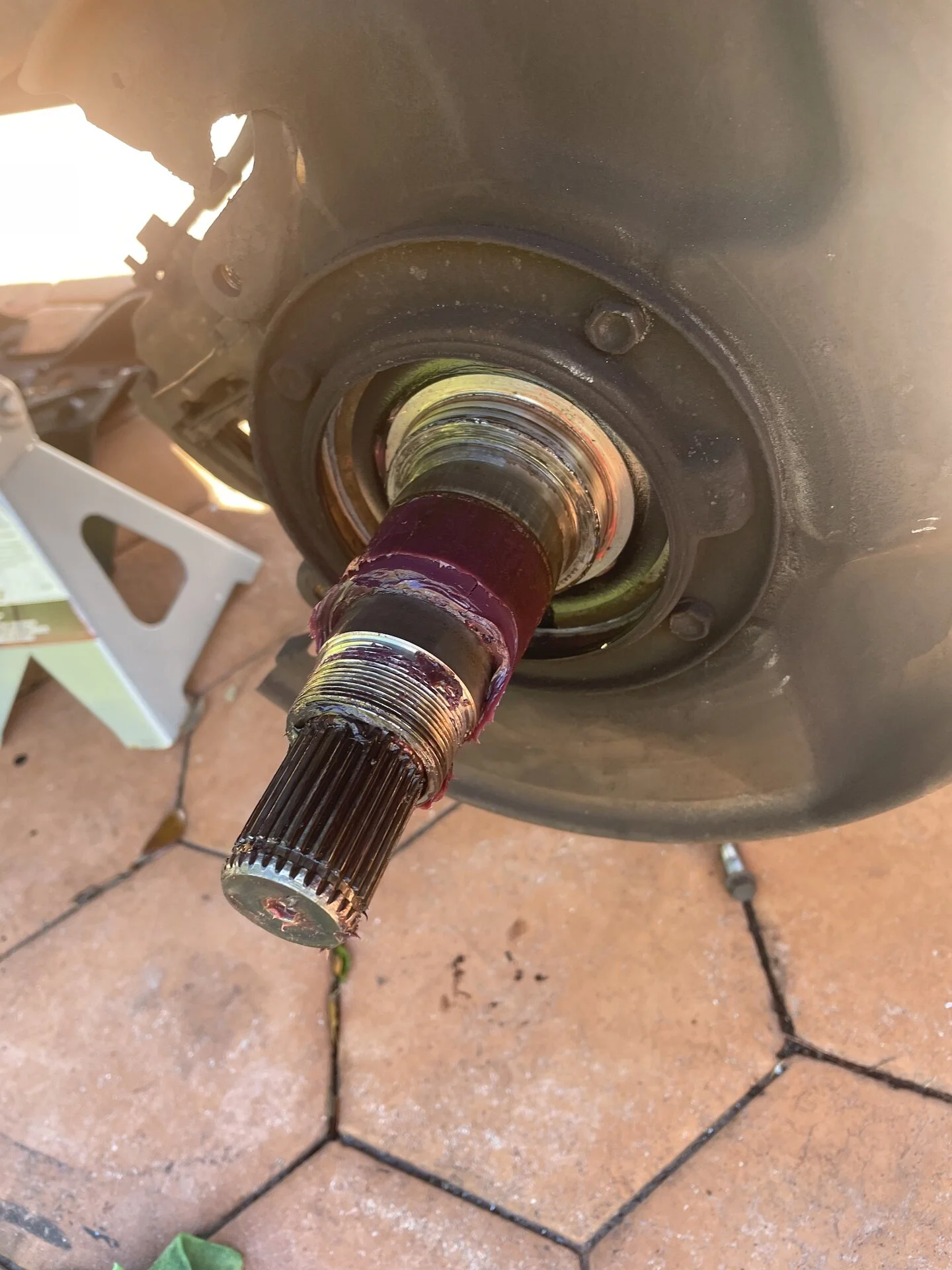

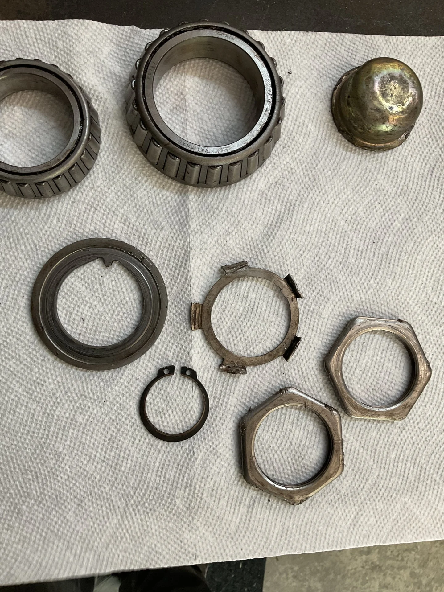

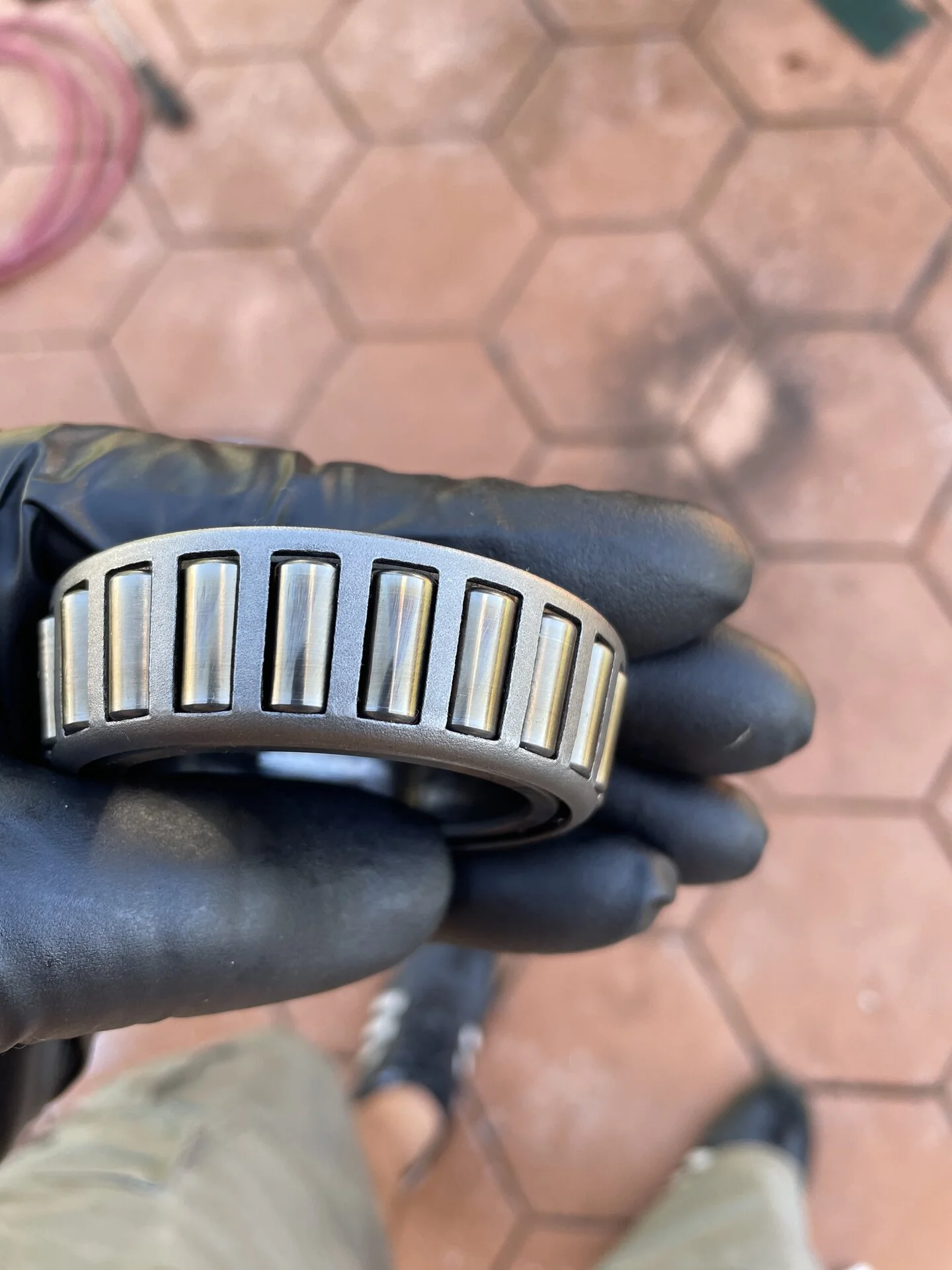

A question for the Gurus, did my passenger side bearing service this last Sunday, driver’s side will have to wait till my next time off since it got dark.
Together w the bearing repack I replaced axle and flange to fix a clunk originated there, and removed the complete spindle to check brass bushing and replace ball joint boots that had small cracks.

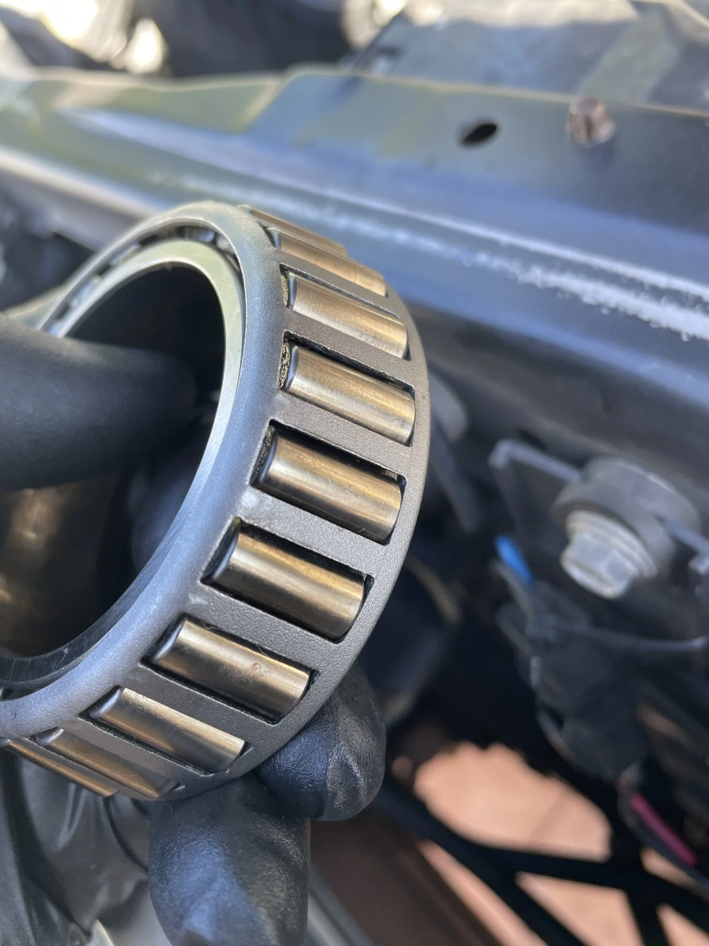

My question is about the bearings condition.

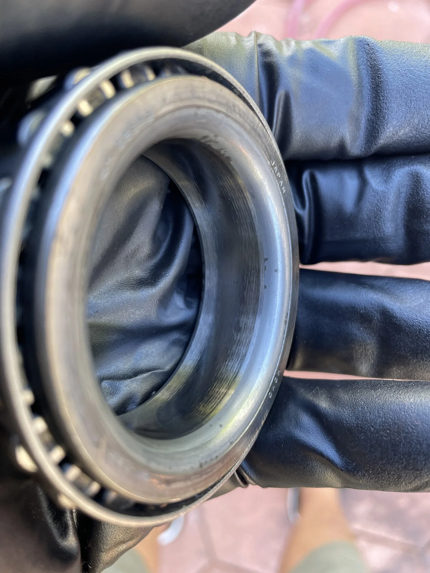

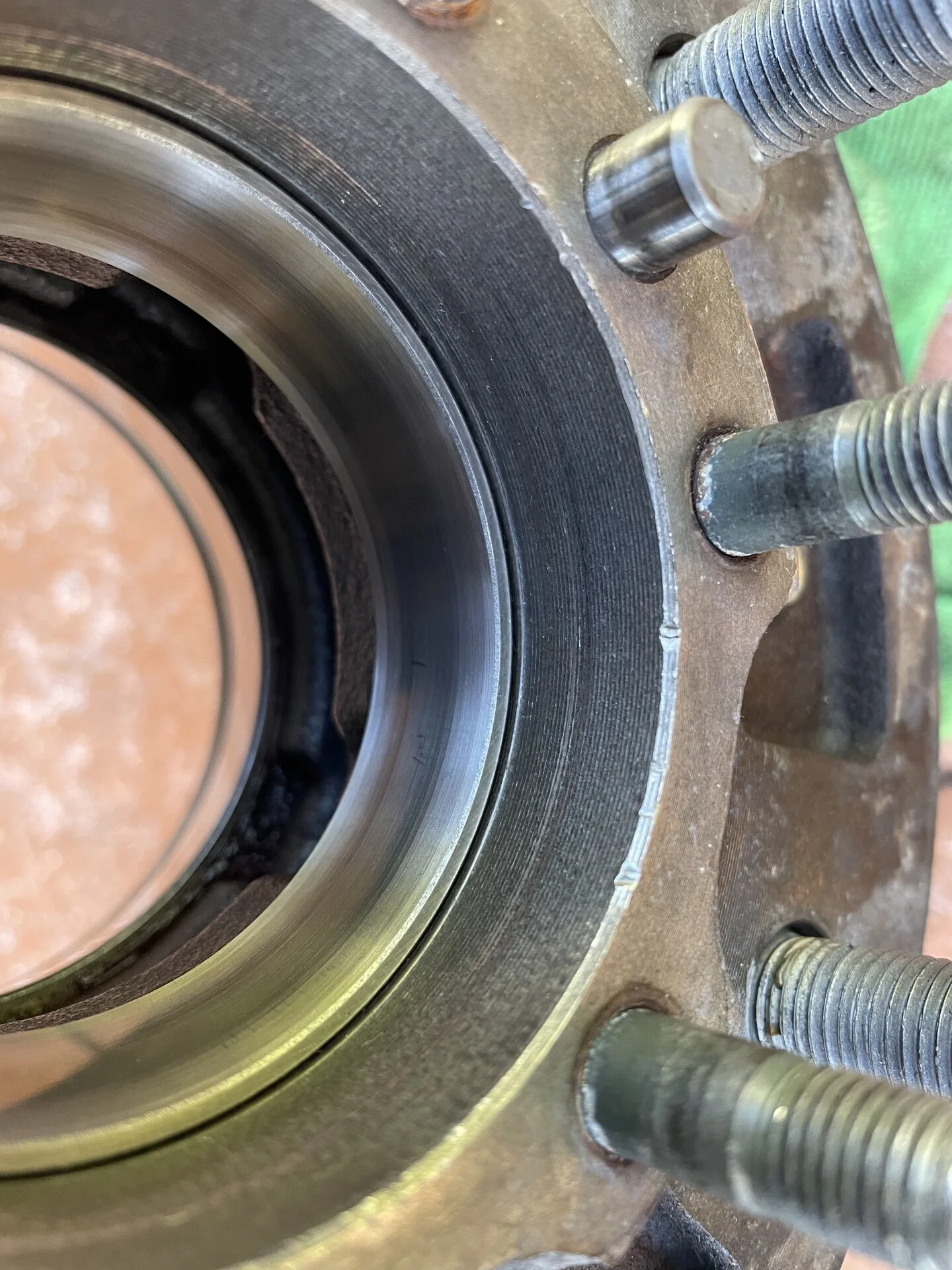

Here’s a few pics:
They look great for very high mileage bearings, but there’s some discoloration (even rust looking) on the inside of the racers, I have no idea how since I did the service last time and I don’t remember seeing that.
Here’s some of the outer racers interior face:

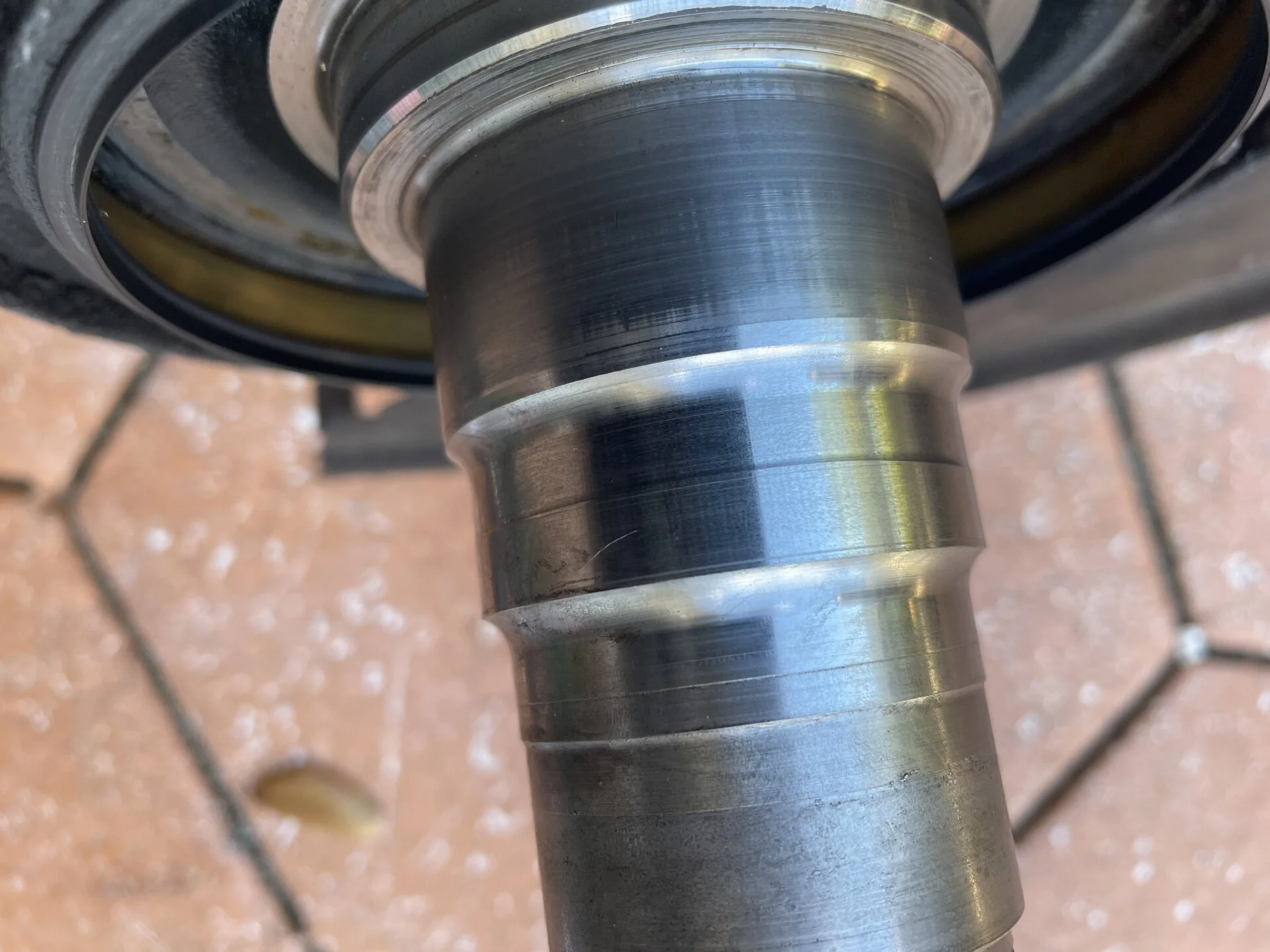

Here’s the spindle right after removing the hub:
Continued:
After cleaning:
Did I pack too much grease and it created a situation where the bearing doesn’t roll properly?
Am I overthinking?
This set will be in for the next 30k miles, but should I consider new bearings for the next service?
Edited to add that the claw washer was in great condition, very little wear after 35k miles, the torque on the nuts was a bit looser than when installed, but not finger tight. The brass bushing looks good to me, no mess, and cleaned up great without scuffs or nasty grease.
