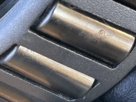

I would replace bearings, next service!
The bearing may just have dust/dirt, or it has pits IDK!. I use micro fiber, to wipe and inspect. Top roller bearing. may be dirt or is it a pit. Bottom roller I'd ask the same.

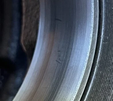

Race looks a bit scored (black, brown, silver). You can sand in a cross hatch, with fine emery cloth. But replacement is best.
I would have given a failing grade, on this race.

I'll see what's the condition of the driver's side next week when I tackle it, I'll try to take some better pics as well. I think the rollers are in very good condition, most of the stuff on them are from lack of cleaning before taking the pic. But the racers are kinda worrying, and I agree that I should be changing by next service. It's gonna be expensive, since I'm also planning to do brakes by then.
