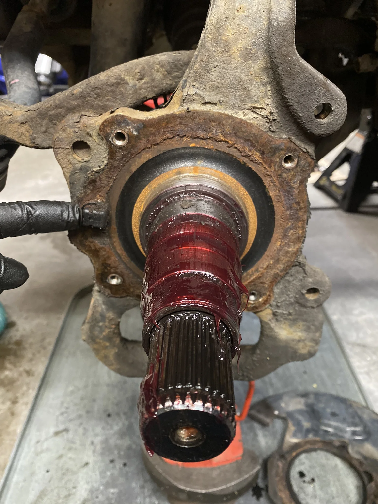

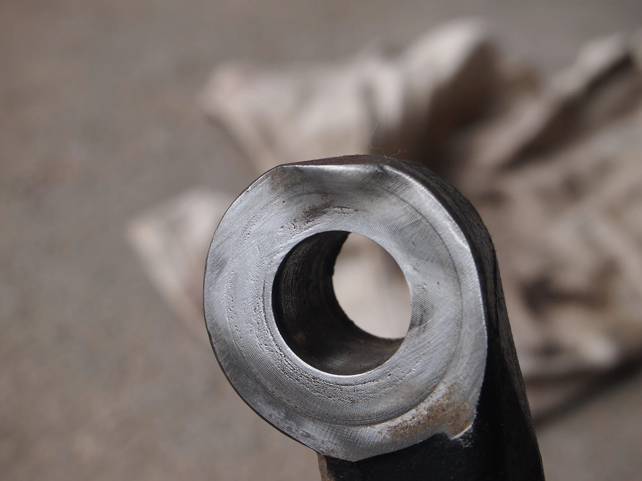

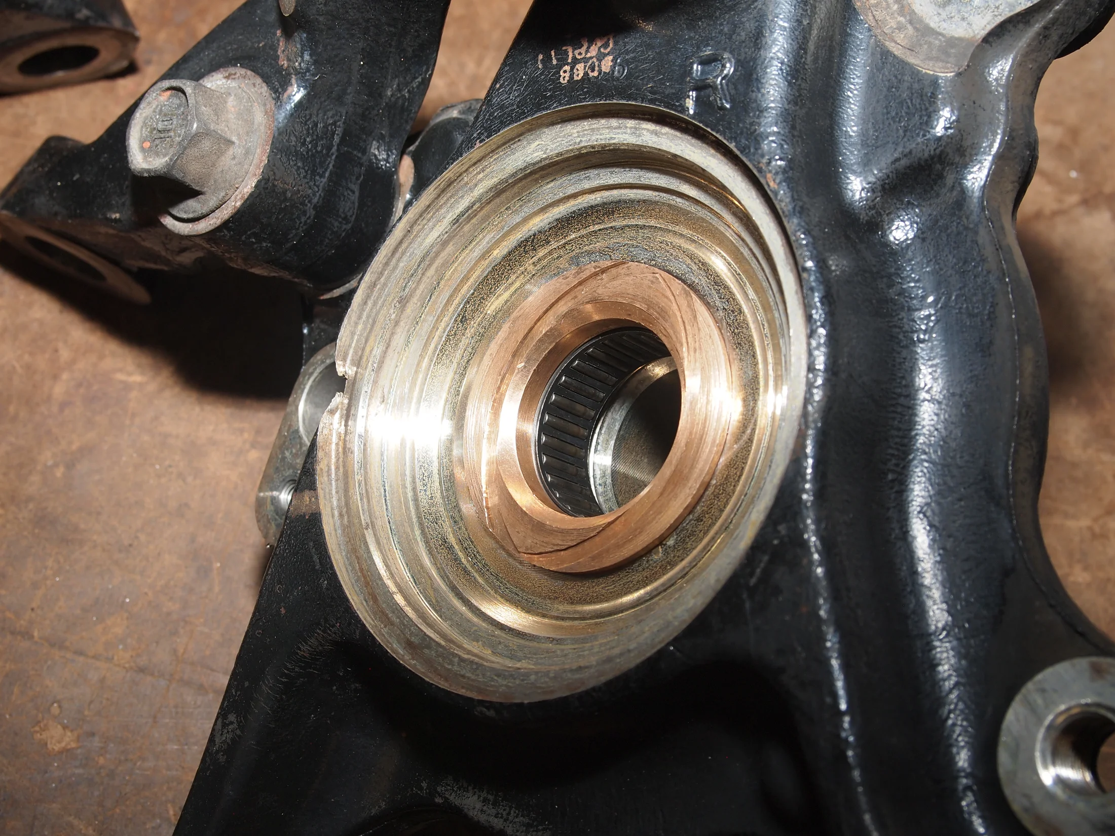

IMHO: Aftermarket Front drive shafts (FDS, AKA: CV's) are a waste of time and money. Most, high mileage OEM FDS, arent worth rebooting. I'll grade the FDS, to make the call:
1) Any play in CV's rotational or in-out of outer.
2) Any rough feel moving inner CV in and out.
3) Condition of outer axle splines. (This one fails most FDS)
4) Snap ring groove condition
5) Condition of outer axle, where needle bearing rides.
6) Condition of FDS outer axle seal. The one that mats to knuckles seal.
To remove axle needle bearing. I use a brass dowel/chisel (as shown in FSM), mostly. I'll, flatten one end of my brass dowel, on my bench grinder. As it, tends to get rounded with use. The flatten end, catches edge of race well. If rusted in, as bad as yours is. I'll soak knuckle in Evapo Rust. Or a penetrating oil, old ATF works well.

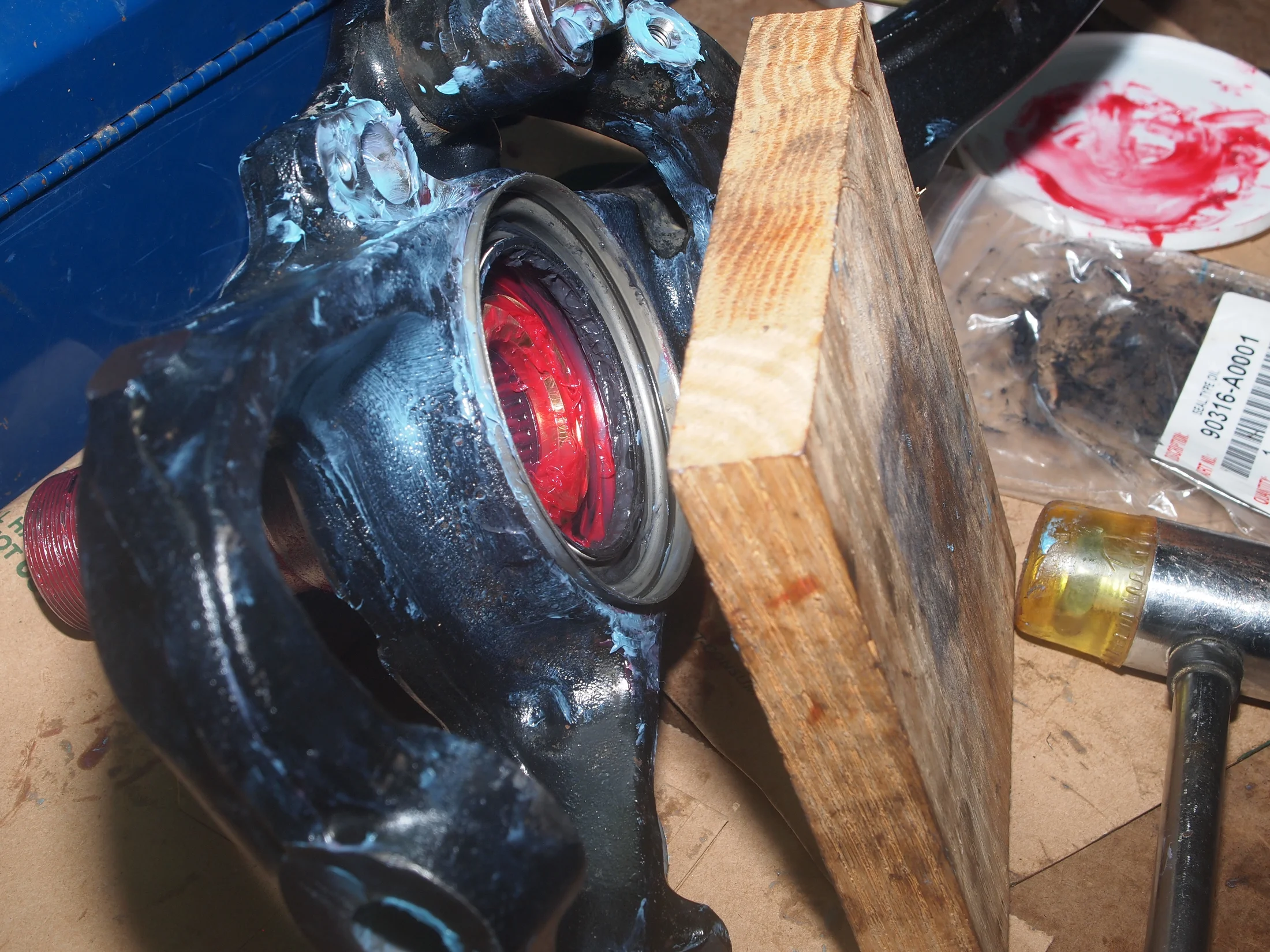

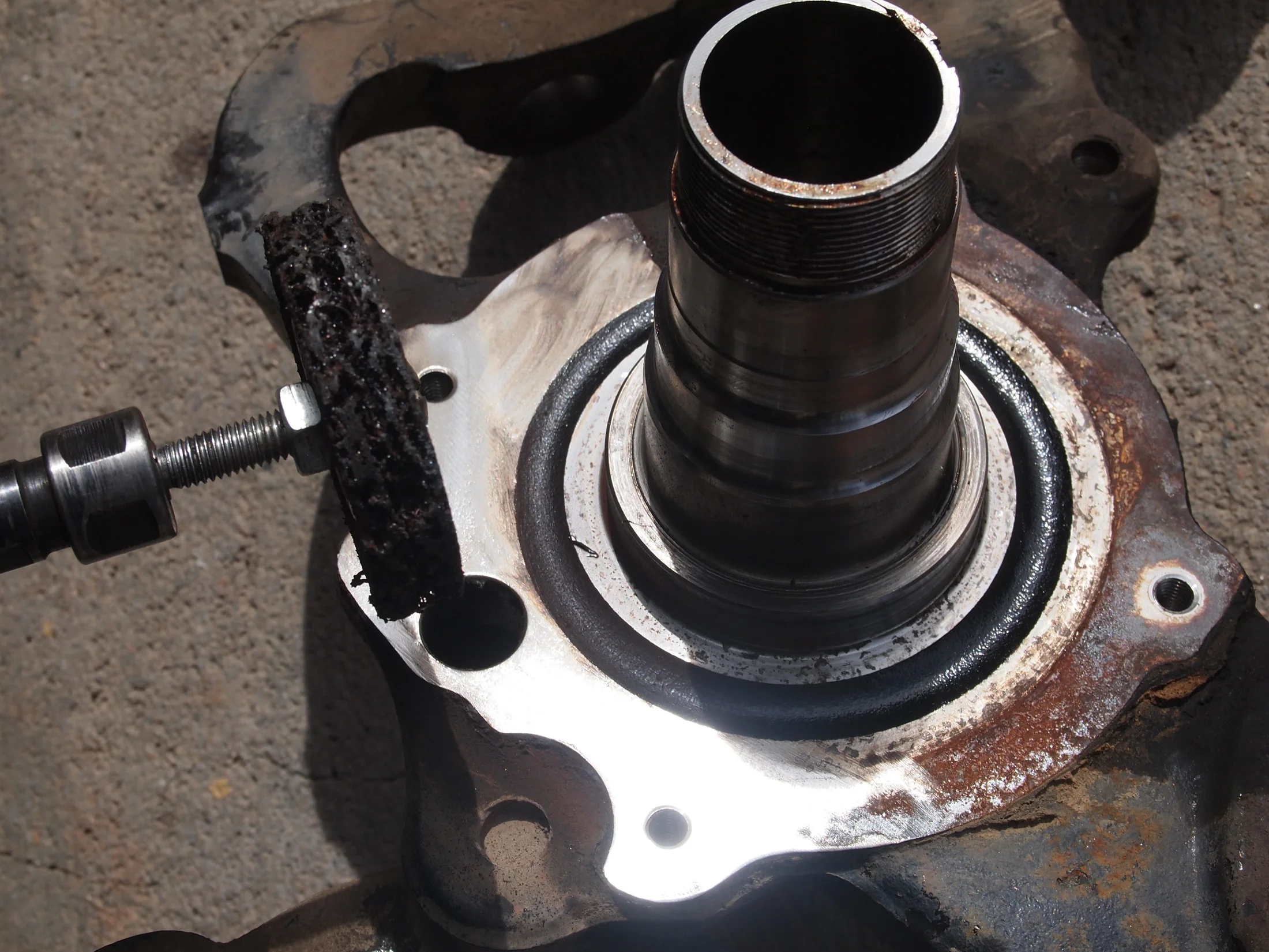

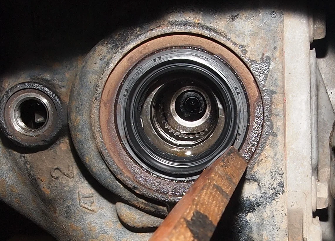

If I've a stuck wheel speed sensor. I clean inside best I can. Then I use, either soft wood like pine (3/4 round) or a rubber mallet, to pound out. I de rust the sensors port, and either add marine grease or paint and add grease.

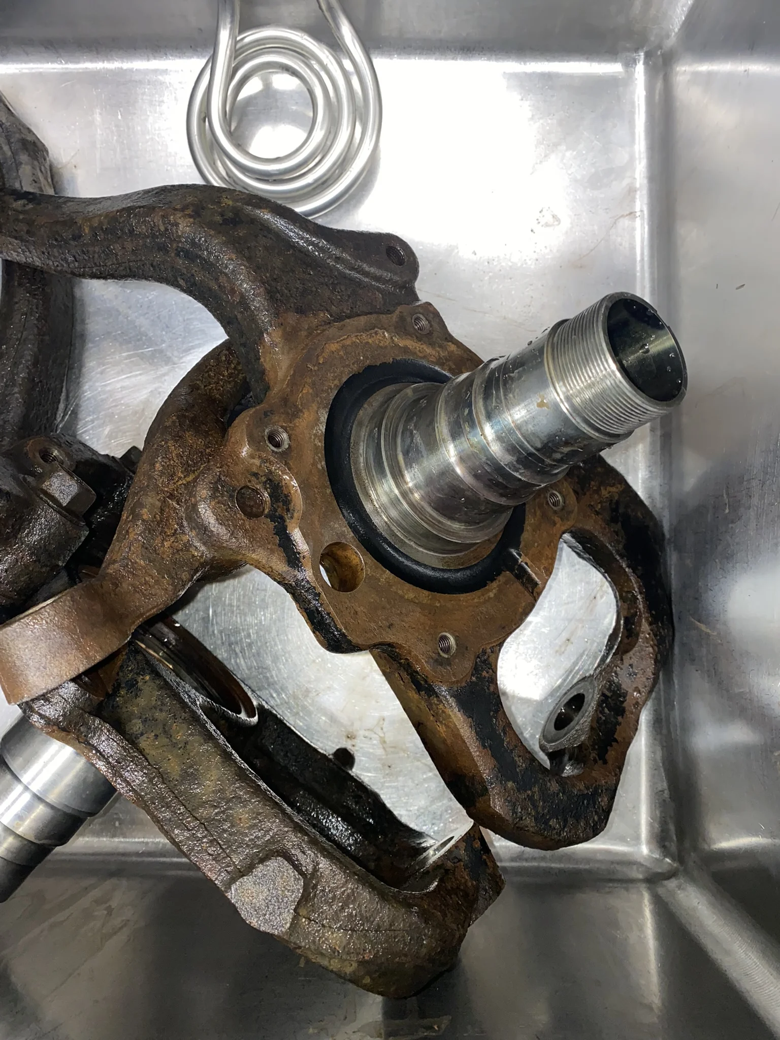

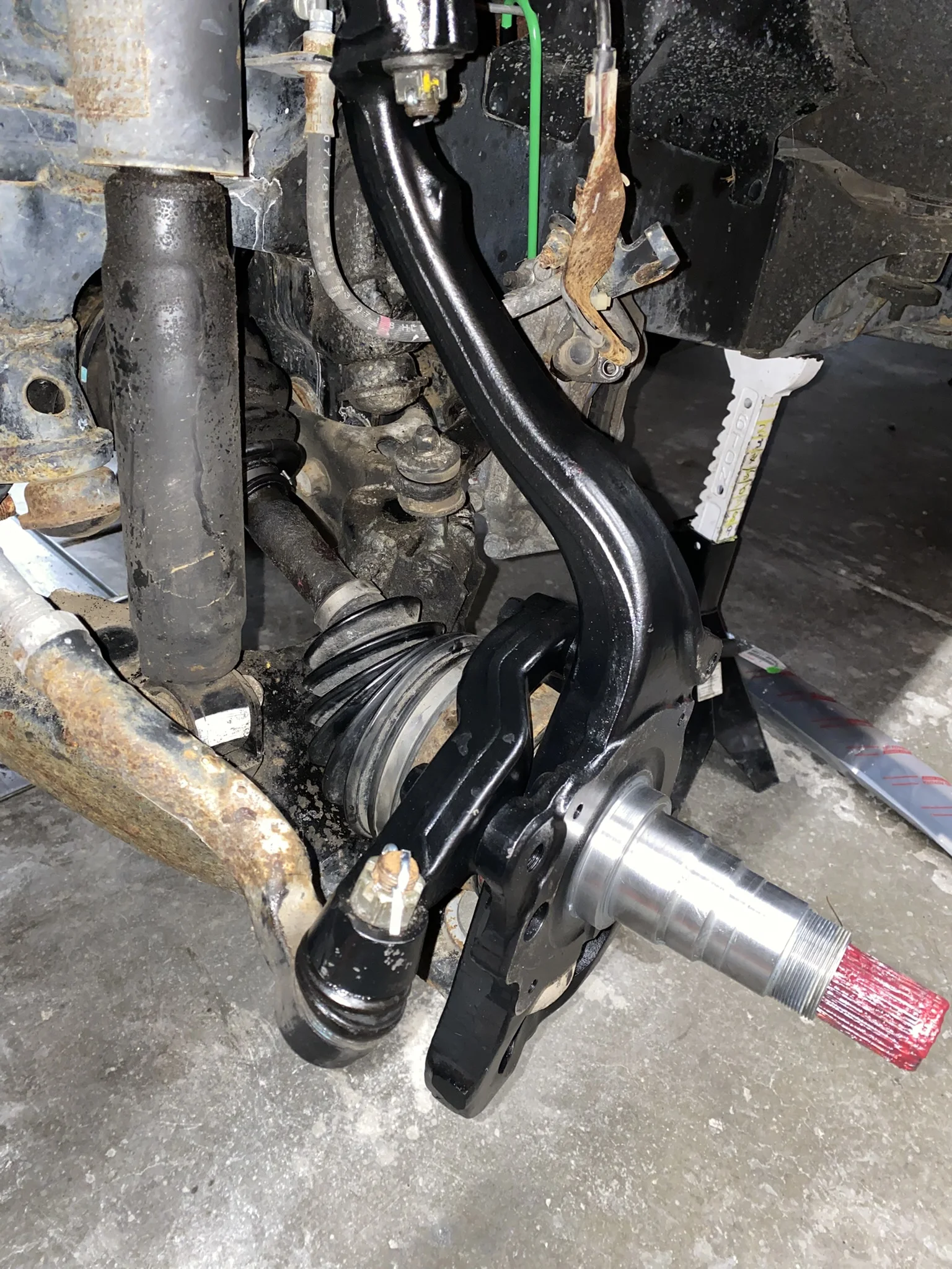

If knuckle not badly rusted, in need of painting. I use derusting brushes/polywheels

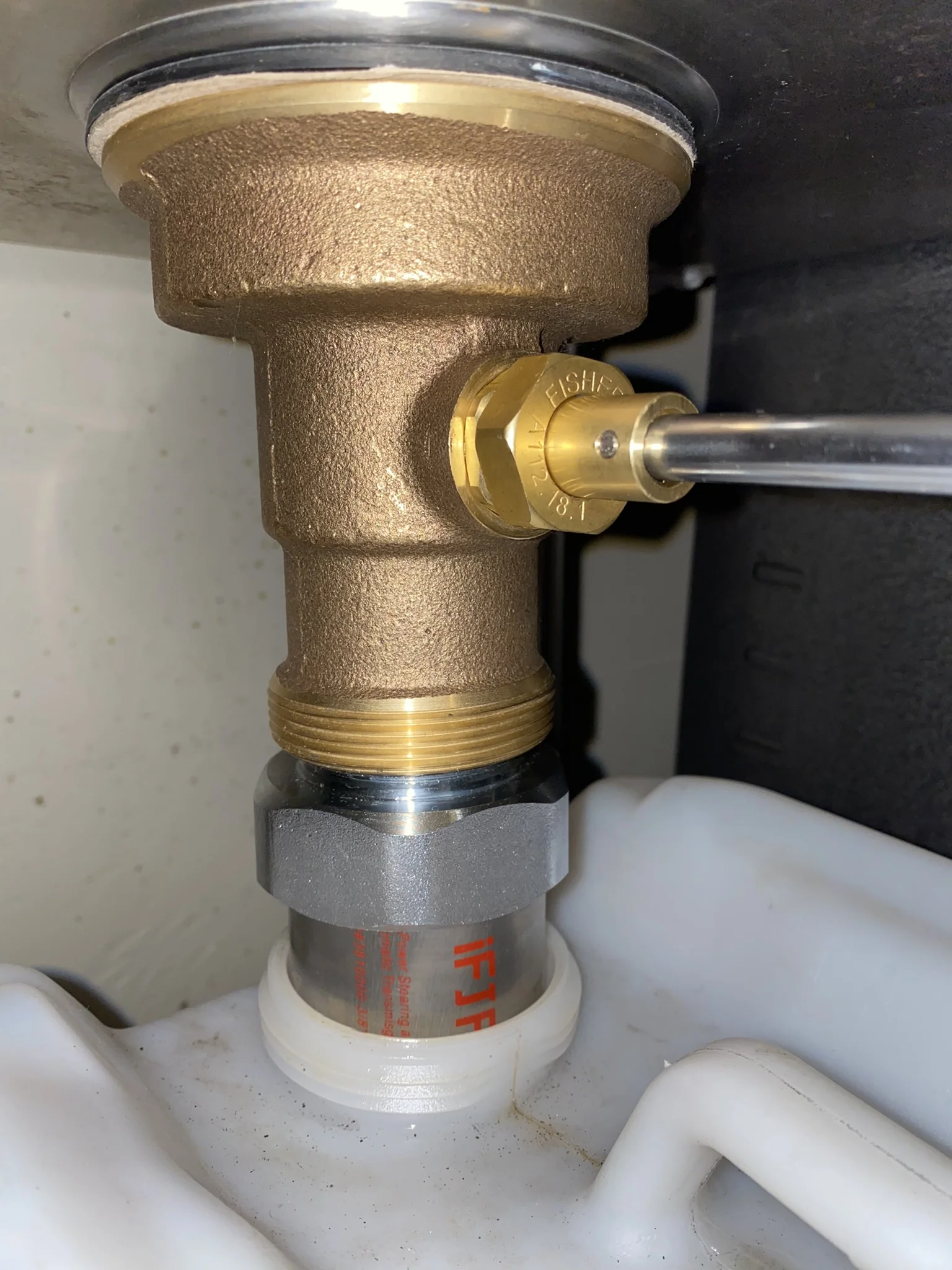

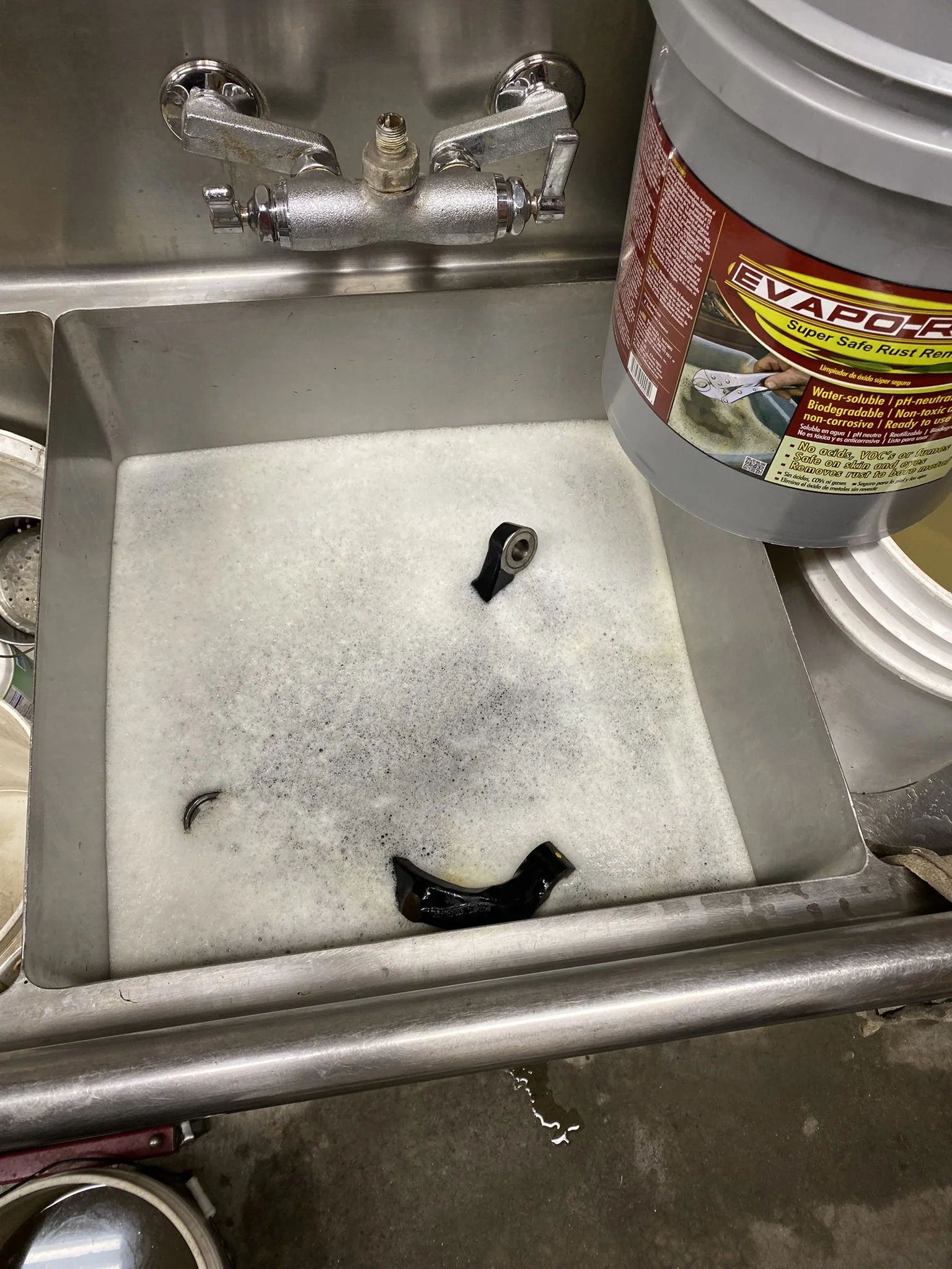

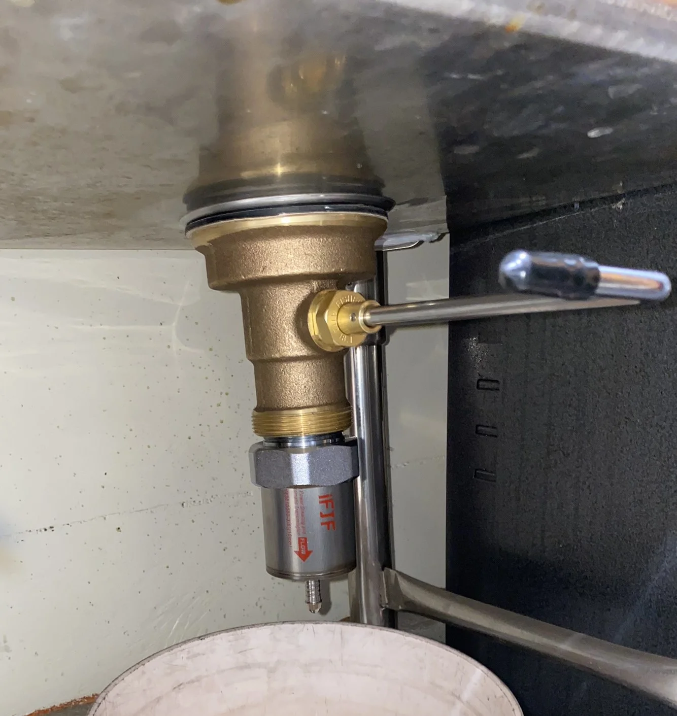

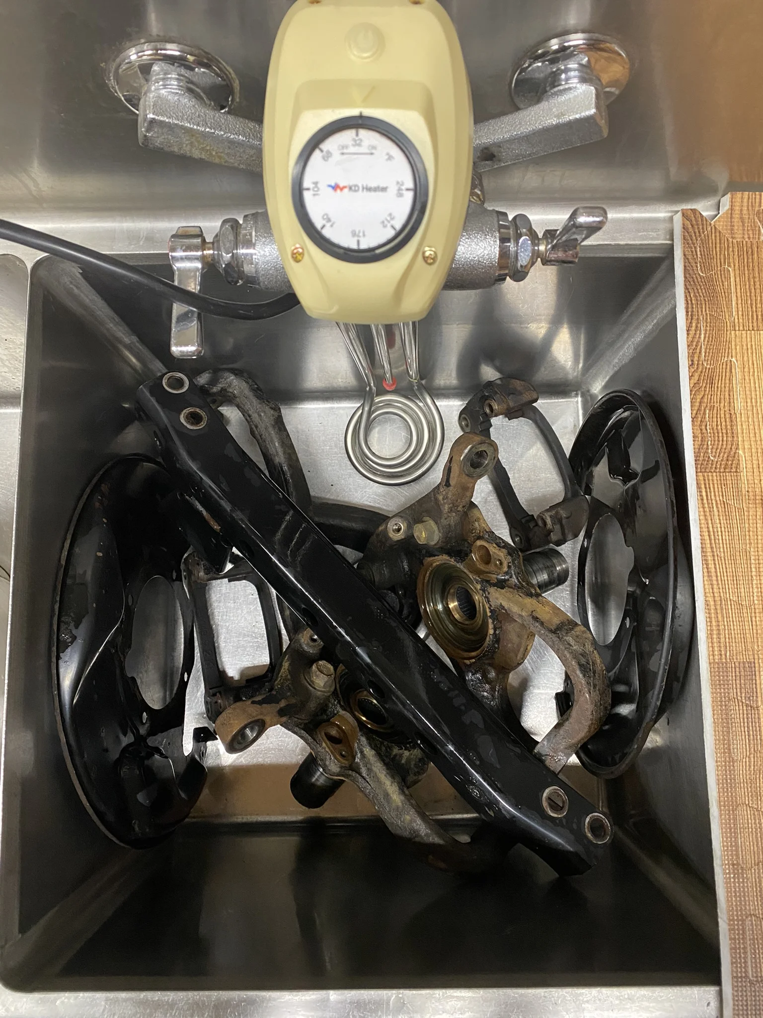

These days. I've a tank (sink) I use to soak knuckles in, to remove rust. Before that I used a 5 gallon buckle, as my soaking tub. Before that or if not badly rusted knuckle in need of painting. I use derusting brushes/polywheels^^^.
I found I

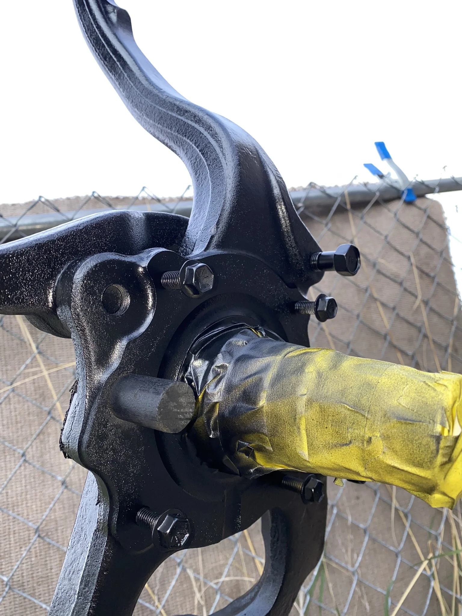

I've found, I do not need to protect (as shown) wheel speed sensor port or threads, from over spray of paint.

Interesting about hammering out the speed sensor with a piece of soft wood. Have you ever damaged one with that method?
If stuck I've always just cleaned them well and left them (assuming they're operating properly).
Nope! Clean it, add a little P oil and tap.
The only time I've seen damaged. Is when pried out, from outside.
I found I View attachment 3979174I've found, I do not need to protect (as shown) wheel speed sensor port or threads, from over spray of paint.

@2001LC If you're buying Evaporust by the gallon (or 5–gallon) bucket, I can save you some cash.
In one liter of distilled water, add 100–g of citric acid and 40–g of washing powder. If you want a little stickiness, add a squirt of dishsoap. This, and some green color, is the recipe for Evaporust. Pro tip: mix this in at least a 2–gallon bucket/container. When you add the washing powder to the citric acid, it "boils" when the excess oxygen is released. The soap makes it even more bubbly. After 5 minutes, it'll be flat again.
IME, this works better than the commercial recipe, and reuses much longer.
I mix it 2 quarts at a time, because I don't have spare 5–gallon buckets lying around when I mix my batches.
Buy the citric acid by the 2– or 5–pound bag. It stores, closed, forever.
FWIW, you can use baking powder, but you have to use 65–g/mix, to make up for the lack of calcium, which is replaced by the hydrogen in the baking powder.

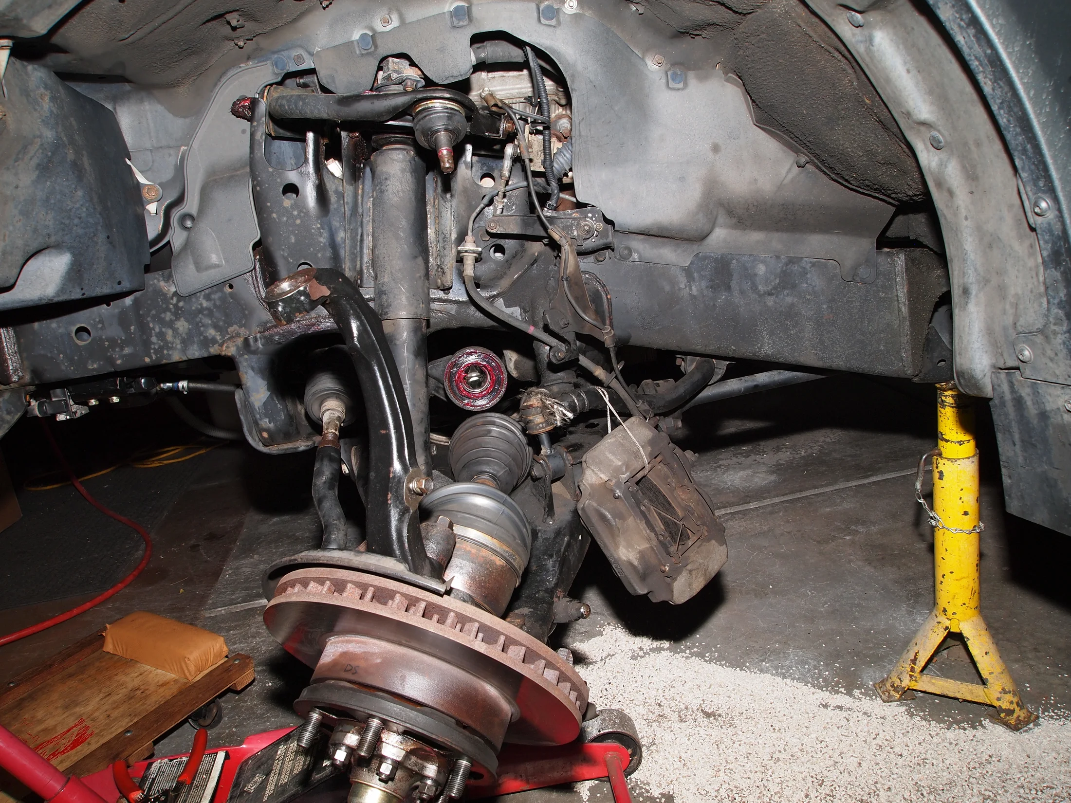

No way in hell.you are replacing CV without removing steering arm and popping lower ball joint.
I’ve done it several times popping tie rod end and upper ball joint.
This must be an analogous activity to removing an 80 series brake booster, w/o removing the intake. I can't do that either.

Over the years. I've evolved from harsh solvent, that are hard to dispose of. To environmentally friendly cleaners and systems. But it does cost a lot more.
I should add: I've learned to really care for my Evapo-Rust (ER). Also had to get max benefit. I use a bucket heater, to keep ER above 68F, which is minimum activating temp. I'll sometimes, take up to ~220F and boil parts. The higher heat, really speed up the process and gets deeper into pores. I take parts out of my tank, each morning and power wash. Doing so, while parts are hot. Thus, removing the loosened rust & paint. More rust chunks and sediment, I get out of ER solution, the longer it last.
At the same time, I filter out the Evapo-rust. Using some cut OZZY mat filter medium inside bottom of sink drain, and a ATF inline filter with magnet.
I avoid putting brake parts in my Evapo-rust. Brake dust/iron, I believe was killing my Evapo-Rust fast. So I clean off brake dust, best I can first. I just tried CLR (calcium, lime, rust) on brake parts in my sonic cleaner. Work well!. But I do clean those parts first, as good as I can, before CLR bath also. So that, I don't waste the CLR. Perhaps your solution, will work well for brake parts as well?
The OZZY-juice, is not only a degreaser. It's also, the medium that supports health OZZY's microbes. The bad part about the system: CRC states; matts must be replaced every 30 days. That is to add back in, fresh OZZY microbes to the tank. Also, OZZYJuice evaporates. So it too must purchased and add regularly.
So the cost runs up to $225/mo plus electricity for heater on pump. (OZZY mats $25, OZZYJuice W4 $130 or X1 $200)). Average about $2,000/yr., if I don't push the time intervals, and keep use of CRC Smart Washer pump to minium.

Most times, I'm doing wheel bearing services at same time as knuckle service. But if just going in to replace a needle bearing or perhaps diff side seal or FDS. I prefer pulling off knuckle. Whereas I showed above; FDS can be pulled, by only releasing upper ball joint. We can also remove knuckle with wheel hub/bearing as one unit. But it is heavy, when time come to install.

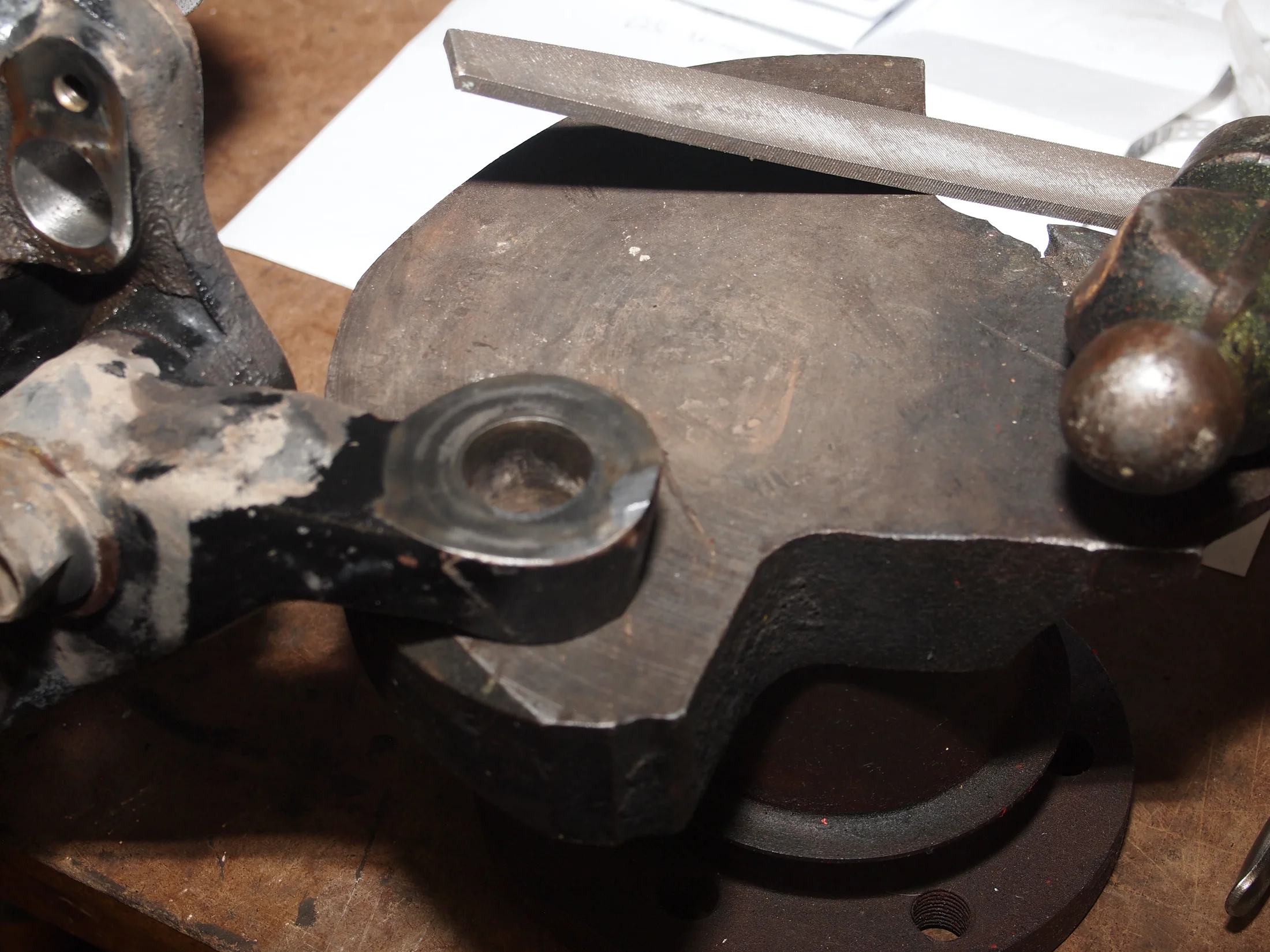

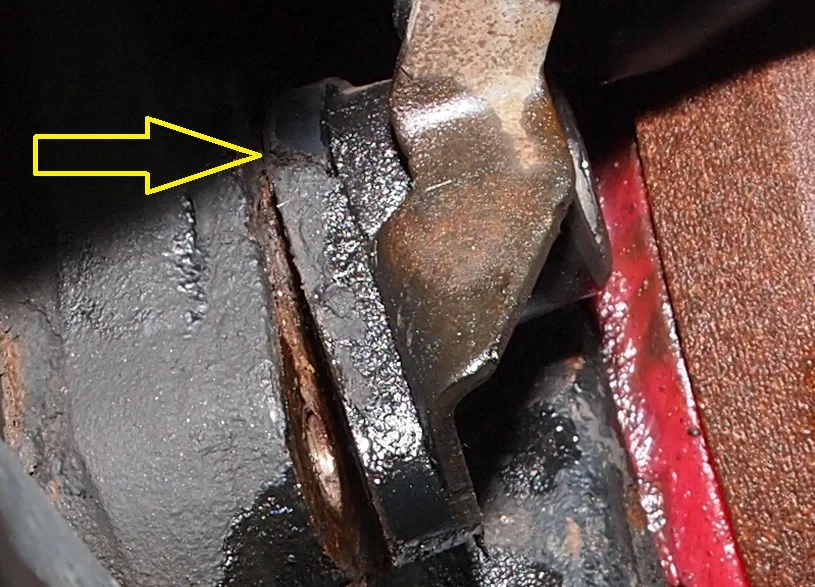

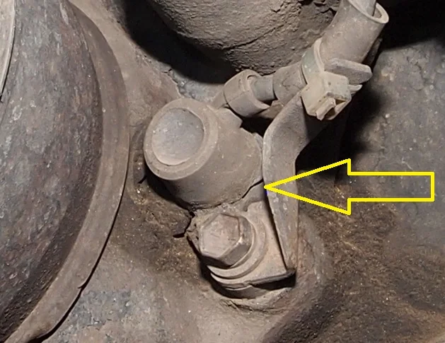

One of the issue pull knuckle/wheel hub as a single unit other than weight. Is release lower ball joints & TRE. The brake dust shield is in the way of most pullers. I've pullers, that work with brake dust shield on.

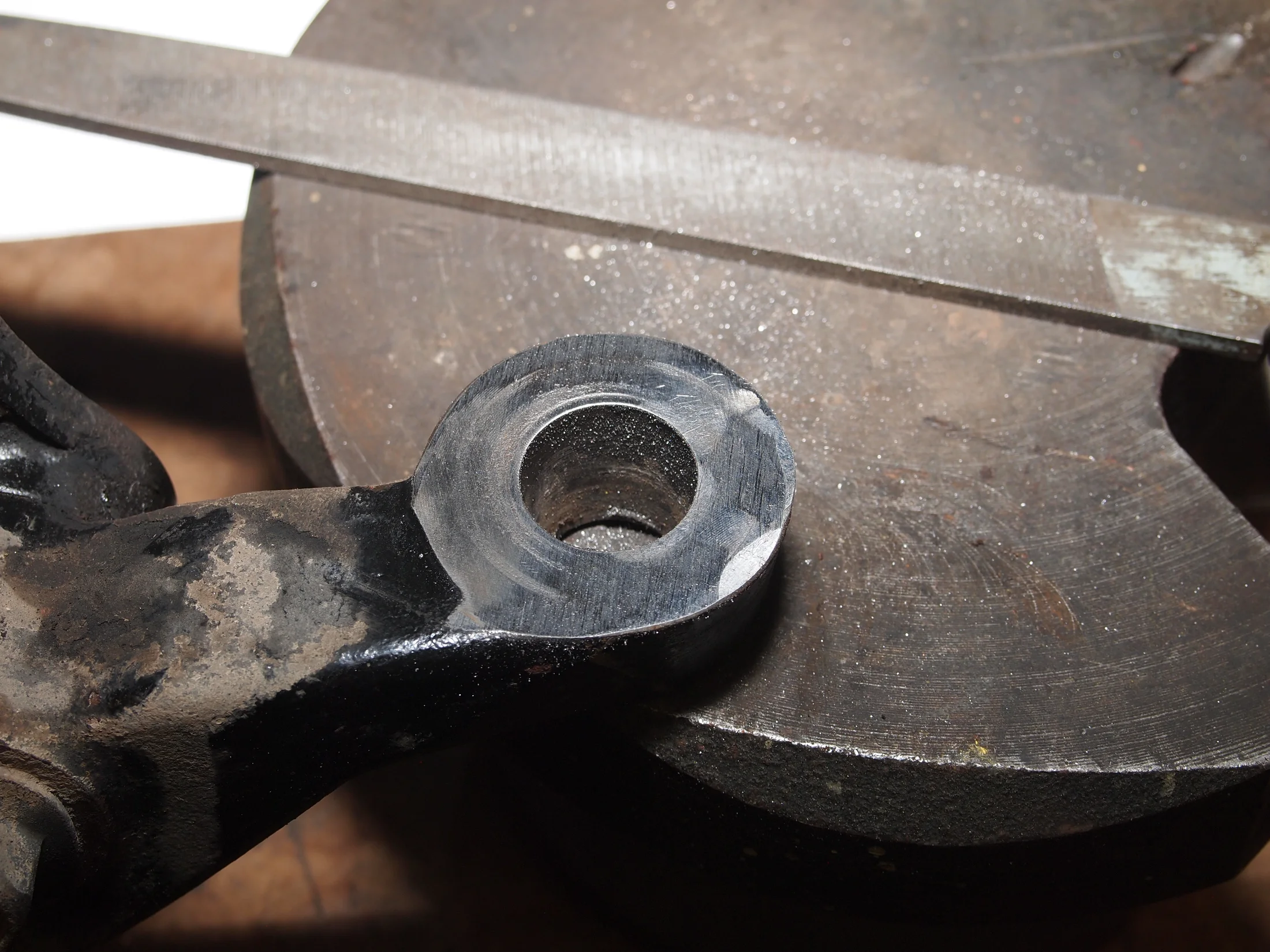

Most mechanics and DIY, get a a Big F-ing Hammer (BFH) and beat off ball joints. I never do. I use pullers. Why, beating off, warps the surface where ball joint boot needs to seals.
Just one more thing, that takes my time, during knuckle service. Due to improper releasing of ball joints and TRE from knuckle. I restore many, where someone beating off with BFH has damaged sealing surface.
Pounding and filing flat, so boot will seals properly.

I chased a rotational scaping sound, at low speed. Used a go-pro to isolate as to area. It was FL FDS/wheel hub/seal area.
I had cleaned, inspected and lubed axle needle bearing and brass bushing. Also installed new OEM FDS. Thought perhaps, I'd set hub flange snap ring, gap to tight (not measurables tight). I was tight, but brass worn down and it then had a .03mm gap. Clean it up re lubed, but still rotational scaping sound.
Thinking it must be my new (2K miles now) OEM FDS. R&R it again with a different new OEM FDS. But still rotational scaping sound.
I went back and review pictures I had taken. I spotting just the faint sign of scoring on 2K mile FDS axle, where needle bearing rides. Pulled and R&R needle bearing Rotational scaping sound, final gone.
Condition of FDS outer axle where axle needle bearing rides. Is our best indicator of condition of needle bearing.
This scoring on axle, was after 2K miles. Needle bearing, look good, it was not.
