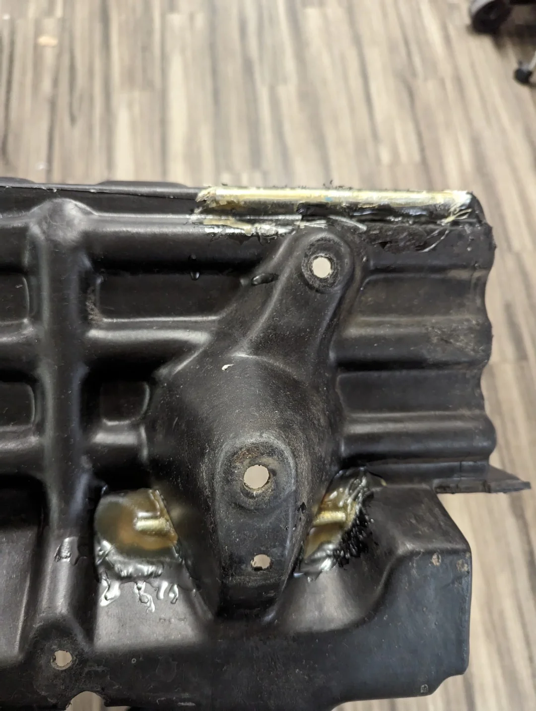

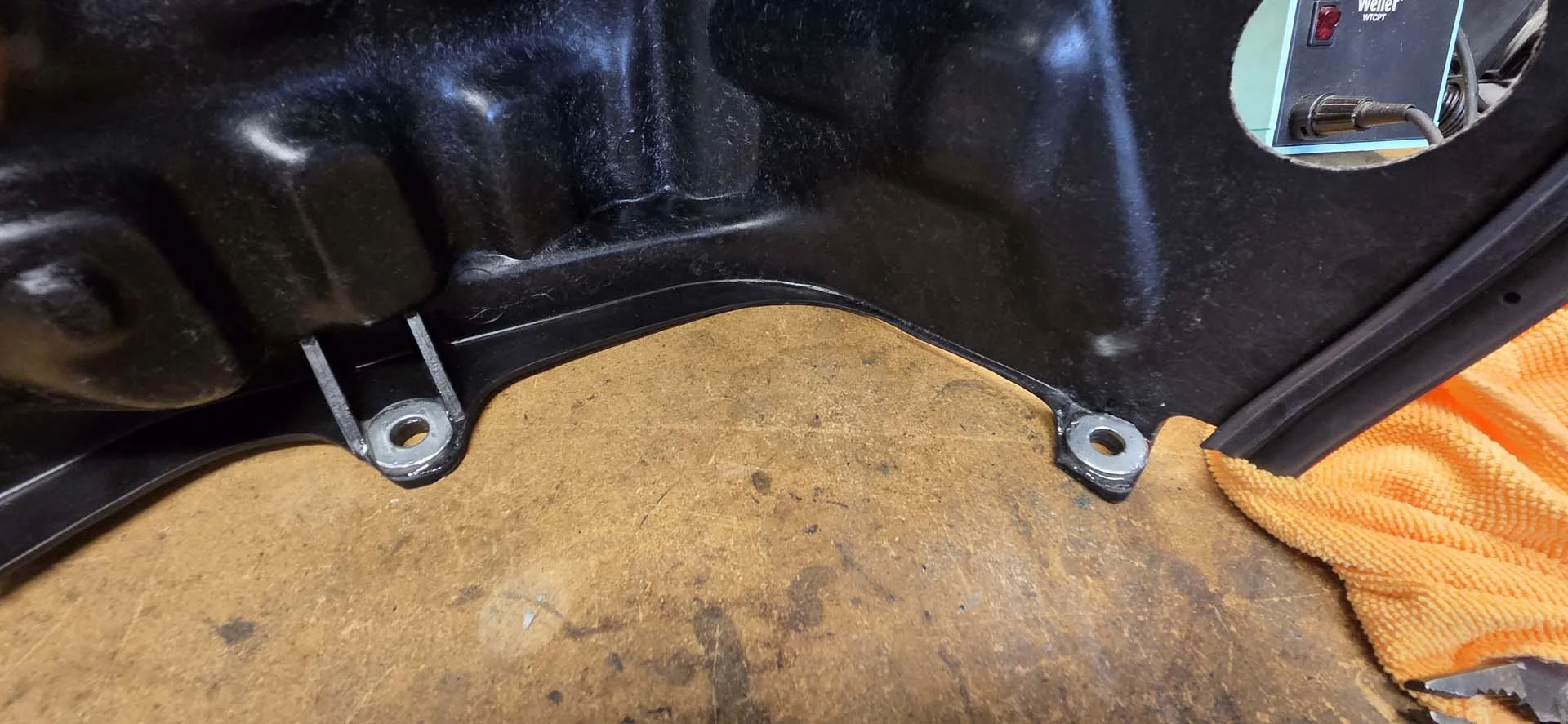

We all know that the OEM battery box for both the FJ80s and FZJ80s are not the best design for off road activities.
Mine had broken tabs where it bolts to the inner fender, the J-hook slot was elongated and tearing into the fiberglass on the radiator side, and it just wasn't holding the battery as tight as I wanted.
I purchased a new OEM box and added a metal support to the outside of the J-hook slot using an EMT strap cut and shaped to fit properly and epoxied in place. I hit the fiberglass with some Scotchbright followed with 90% isopropanol and did the same to the strap.
I used 3/8" washers ground down and shaped for the 2 fender side tabs and front side support.
I'll let it all cure overnight and install tomorrow.
I'm hoping this will hold up better and give more support when flogging around in the woods.
BTW, anyone know how to get epoxy off skin?

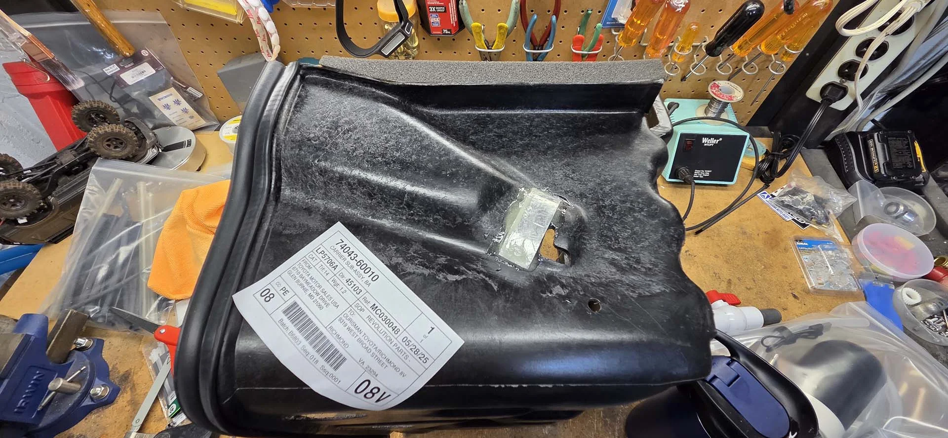

Yeah, the j-hook scheme toyota went with using only the box is daft. I've posted these pics before, this is what I did on both the main and aux batteries.
Steel rods held in place with fiberglass resin and fiberglass cloth (used to repair a bunch of tears and damage on the aux side box too.

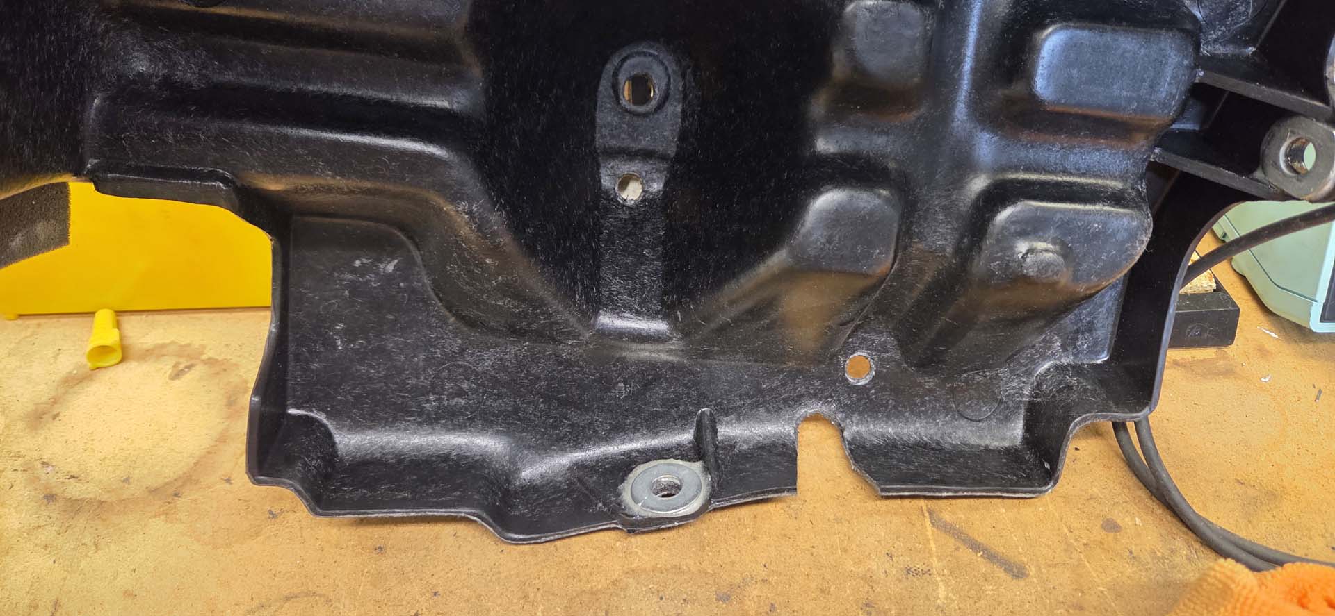

Working on mine now it’s a new box. Reinforcing the side and front mounts with 18 gauge sheet metal pop riveted and JB welded
Rods like George tic set up but different reinforcing in the bottom.
My approach wasn't as fancy. I took a metal battery tray and sandwiched the it above factory battery box and below the battery. I bolted it through the fiberglass box into the inner fender. So far so good. It is firmly mounted.

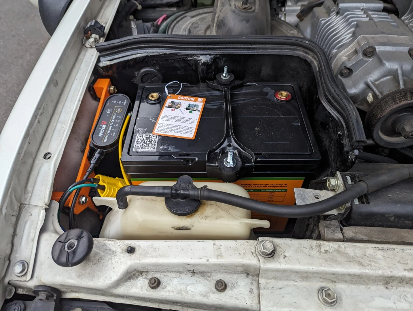

New battery box installed.
I took the time to run a tap through the bolt holes, cleaned up mounting points, anti-seize, etc.
Added 2 larger 3/8 washers for the bottom bolts to spread the load.
I really want to say that the battery is more secure, but it could just be that the fiberglass is not 30 years old anymore.
The j-hooks are nice and tight and the battery is very snug against the rear wall.
I'll have to see how it holds up over time. Certainly better than it was.

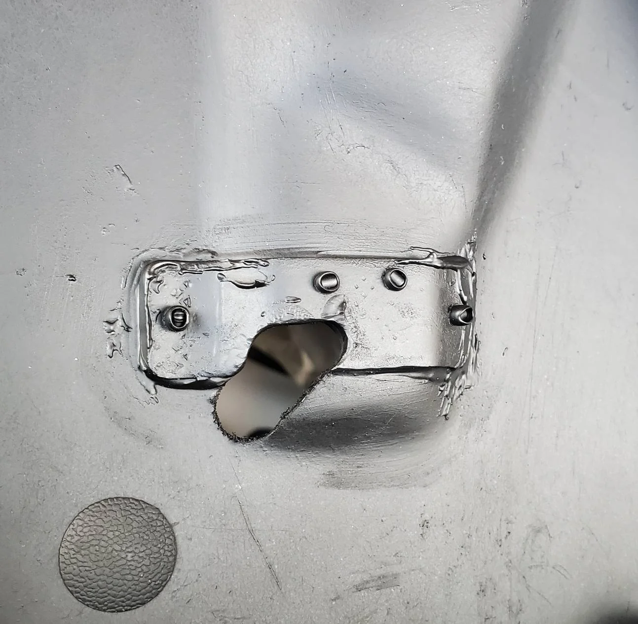

And I here I thought I was the only one. I used 1/8 steel and formed it to profile the battery box.
Attached with rivets and JB Weld. Has held up for 10 years now.
