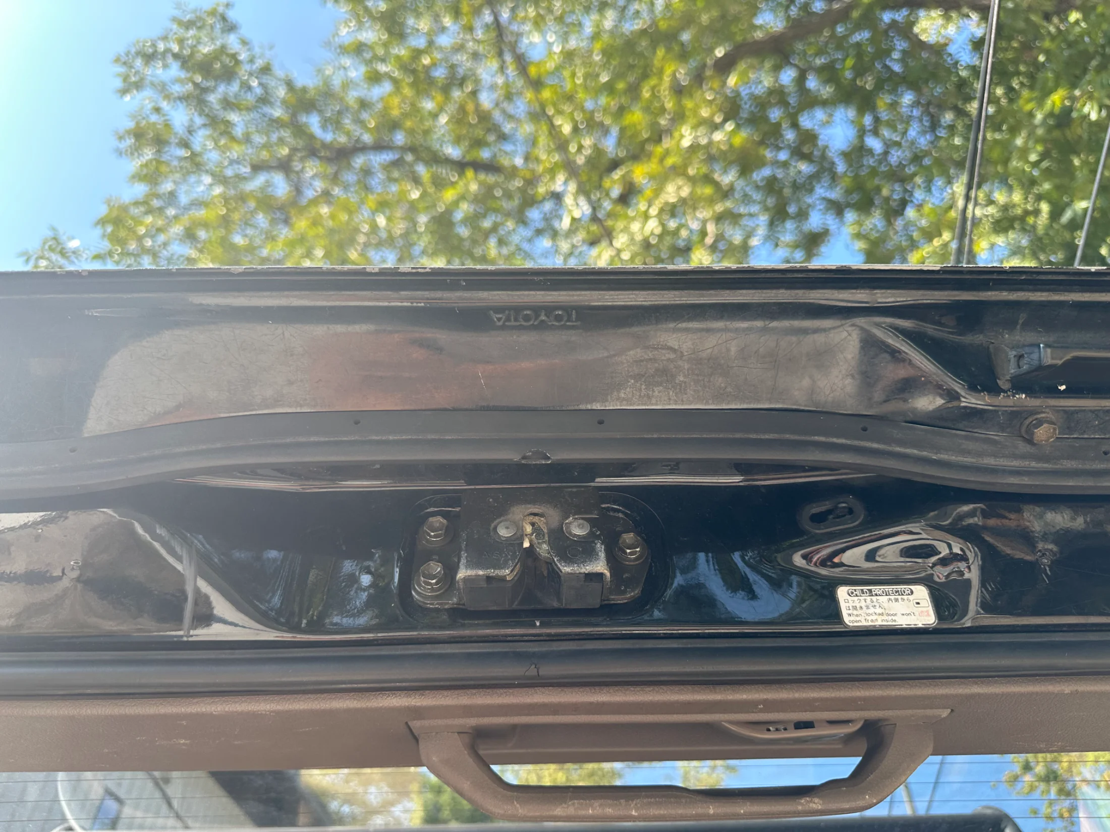

the other item here is i drove for a year with a damaged upper rear hatch. it seemed do latch but since putting in the used replacement it doesn't seem to latch very well.
also i've had a handful of moments where i open the rear hatch at night and like the rear taillights and sidelights and the headlights go on. i aaaumw this has to do with either the mechanism in the drivers side door not recognizing it opened and closed (?) or that there is some issue with the "new" wiring in the upper rear batch or in how they connected it to the harness? anyway i realize this last one is a bit gnarly i just needed to mention it.

B. any ideas on how to pull apart the upper rear hatch connector at the harness so i can inspect it? i guess i just remove the trim on the upper rear hatch or is there more to it?

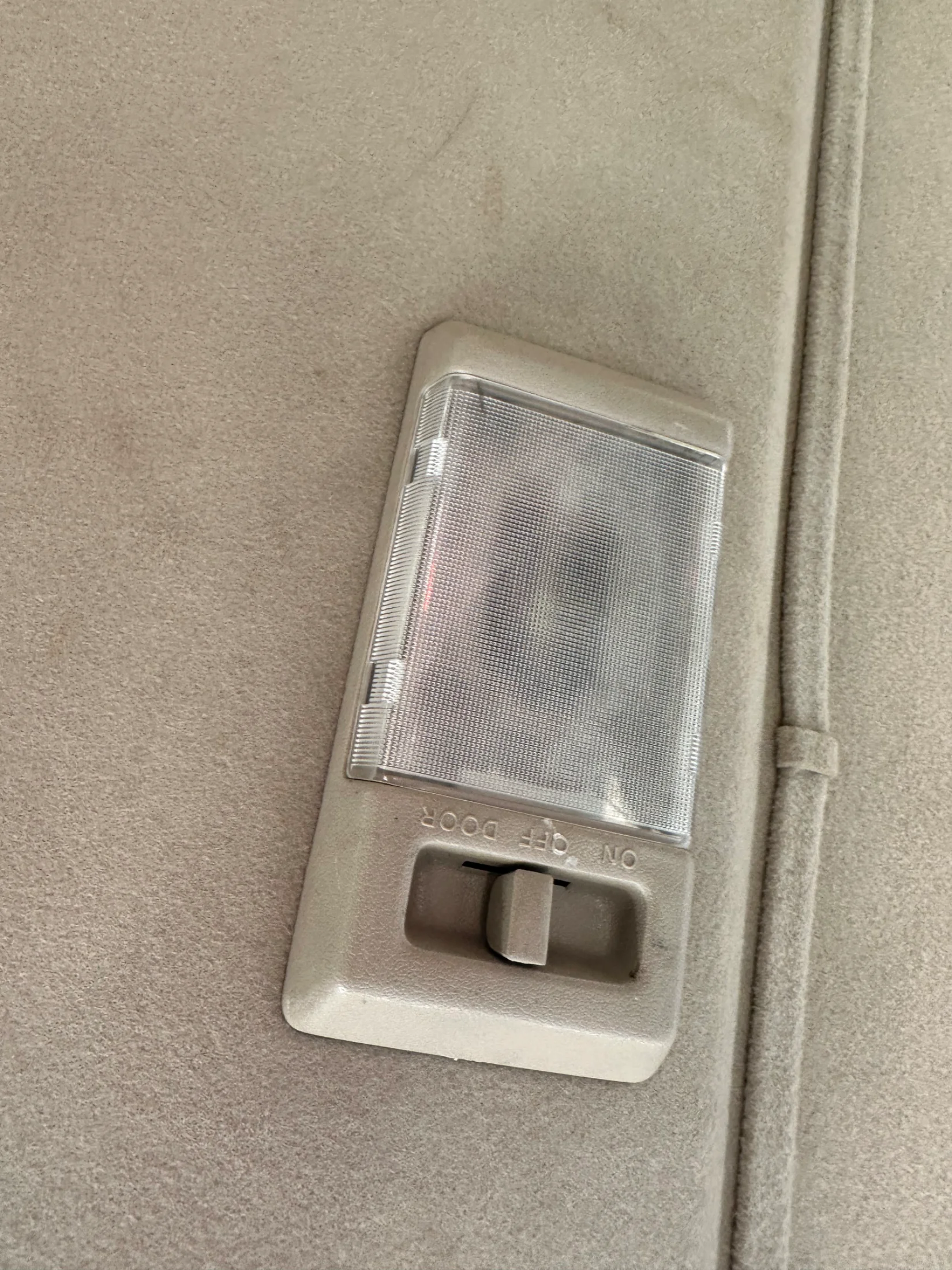

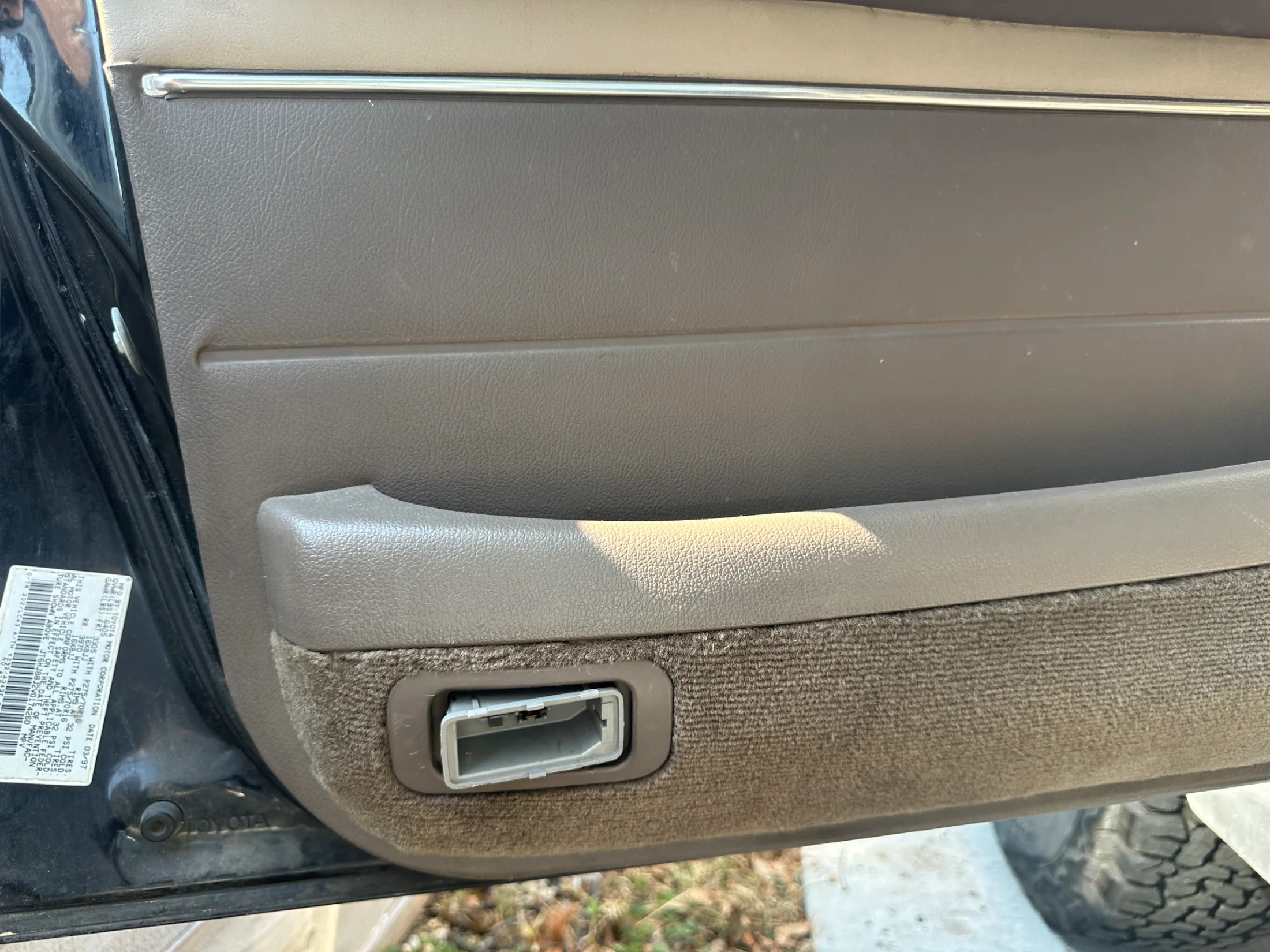

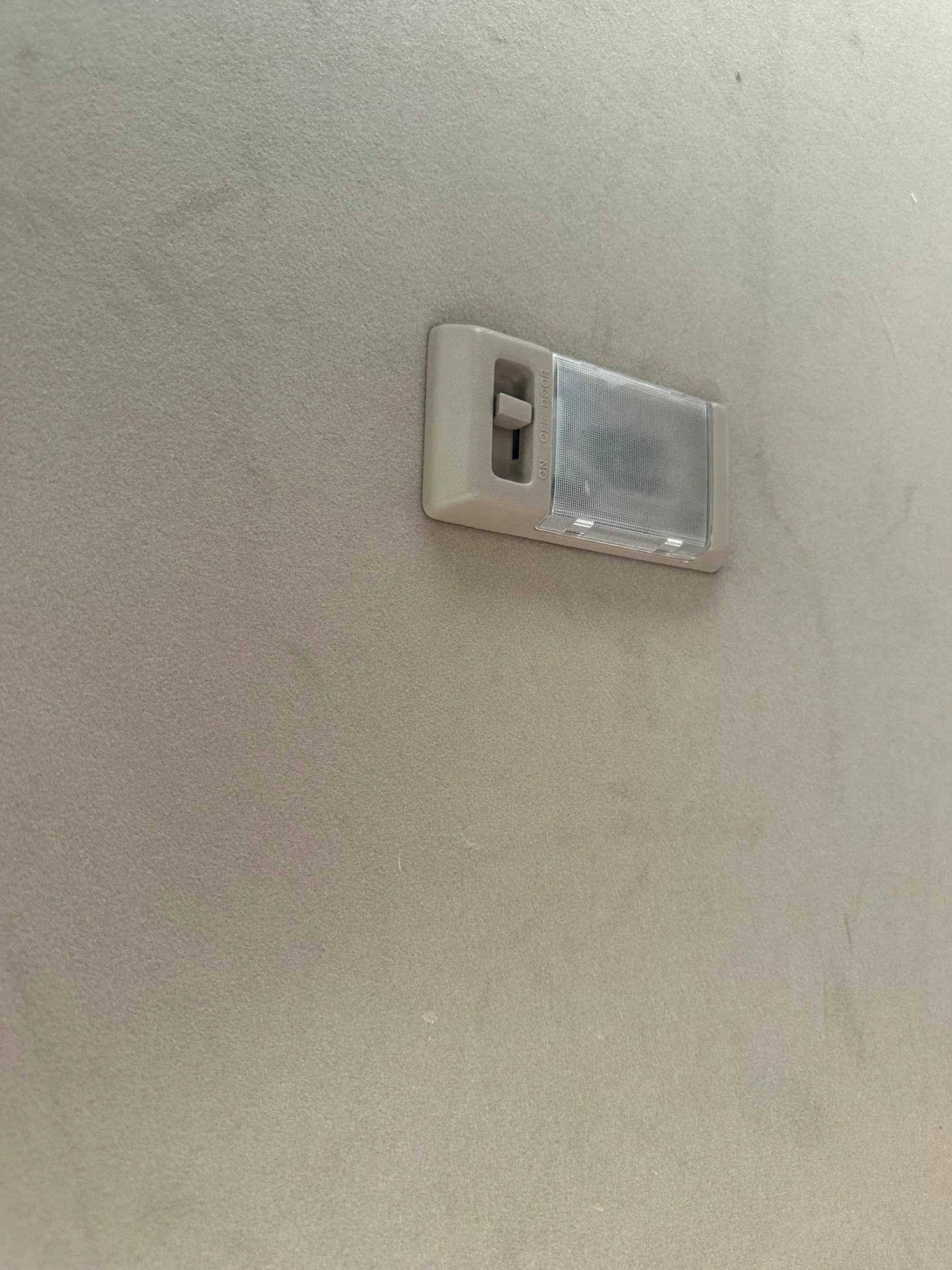

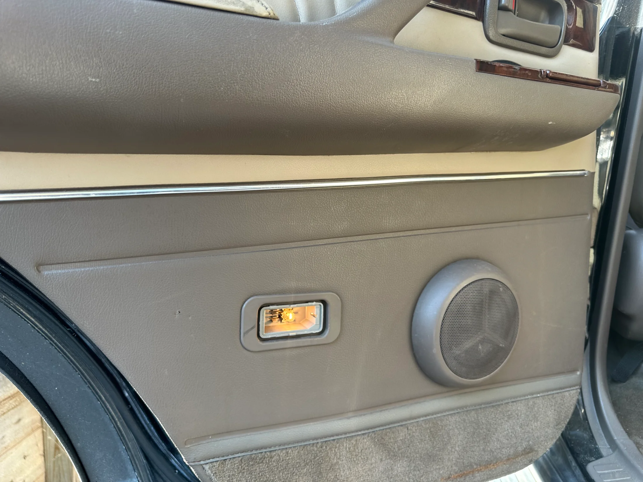

i did tro thing yesterday. i turns the two dome lights to ON when door is open. i think (?) front dome light is on when front doors are open and rear dome light is on when rear doors or rear hatch is open?
either way now i will be able to /see/ when the two door lamps are on if i leave ehe rear hatch ajar. i sort of unthinkingly turned the dome lights off at all times but this means i couldn't see when the hatch was open and rear doors lamps were on.

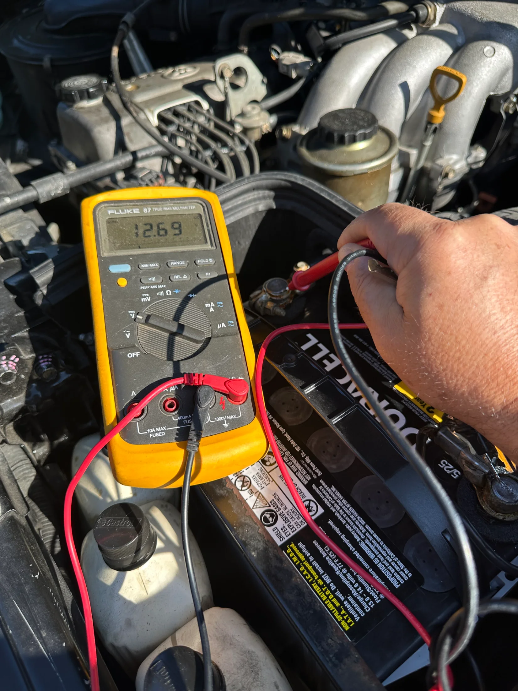

> am i missing something here? it measured 12.5V. shouidnt it show 14V with a new battery and a full charge? granted it wound down to nothing but shouting it be fully charged after an overnight charging?
12.69 shown in the pic is a charged battery, you will only see close to 14v when the engine is running.
In that photo you are measuring voltage. To find how much amperage is being drawn you'll need to disconnect the negative battery cable from the terminal, clamp one lead of the multimeter to the cable and the other to the negative battery terminal. Then move the red lead on the multimeter to the 10A port and set the meter to measure current (A).
Now all of the current will flow through the multimeter (up to 10A then the fuse will blow) so you can see what is draining the battery (checking each circuit, etc). This will be a lot more effective than trying to see a voltage drop since the parasitic load is going to be small enough to not even register a difference in voltage, especially on a good battery. If the parasitic load is really small (less than 400 milliamps) you can use that setting and move the red lead to the 400ma port on the multimeter and set the switch to mA.
