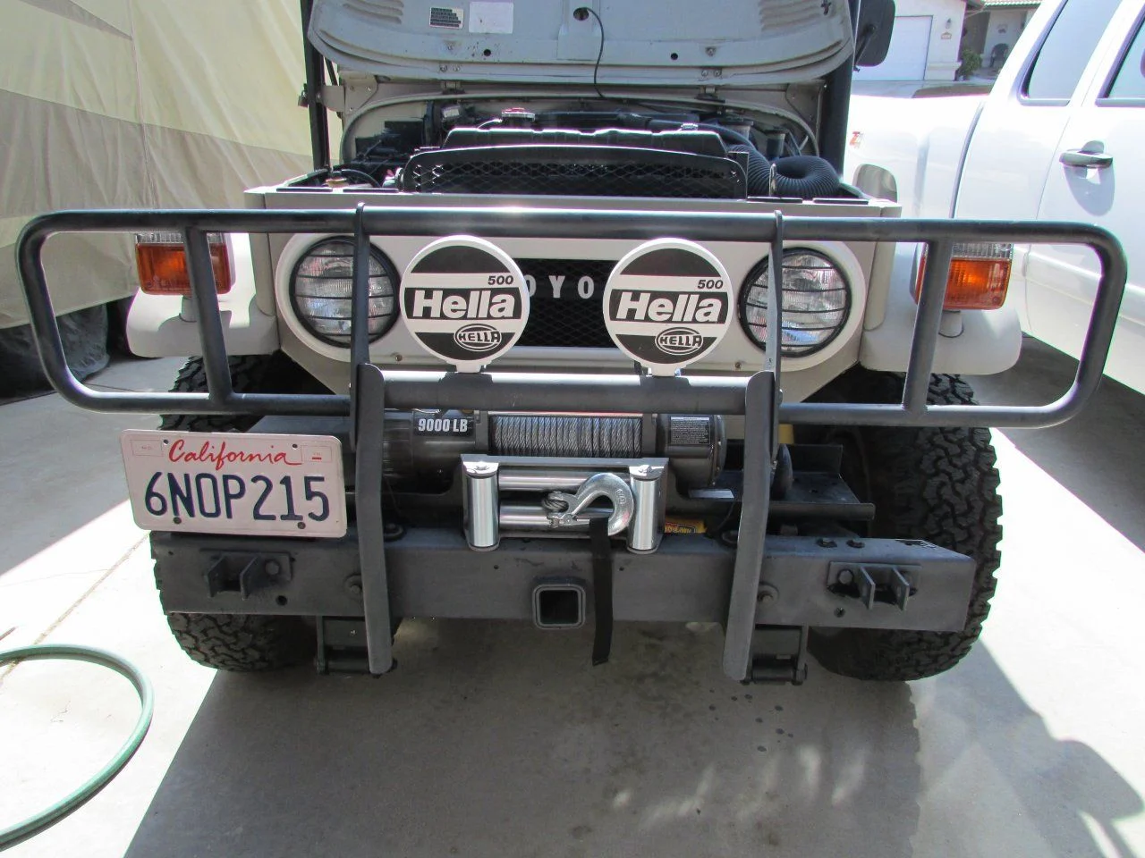

I put the 9000lb on the front of my '75 fj40 using the H.F. mounting plate, absolutely no problems. I believe the mounting bolt pattern is the same as Warn, Smittybuilt, Superwinch etc.
I put the 9000lb on the front of my '75 fj40 using the H.F. mounting plate, absolutely no problems. I believe the mounting bolt pattern is the same as Warn, Smittybuilt, Superwinch etc.View attachment 936849
Looks like a great install. So the H.F. mounting plate sits right on the frame, did you have to drill holes in the frame? Did you use any spacers to raise the plate above the bumper? Thanks.

Very good observations. Because of the brush guard, I did have to tweak a few things but nothing major. One thing that amazed me was the mounting plate instructions stated it was designed for "Toyota FJ40" as well as other applications. Since you have a winch bumper already installed I would think it would bolt right up, no need for the H.F. mounting plate. I helped a buddy install a Smittybuilt on a winch bumper similar to yours and it took about 20 min. minus the electrical connections. Measure the mounting holes on your bumper and then check mounting configuration on the Badlands.
