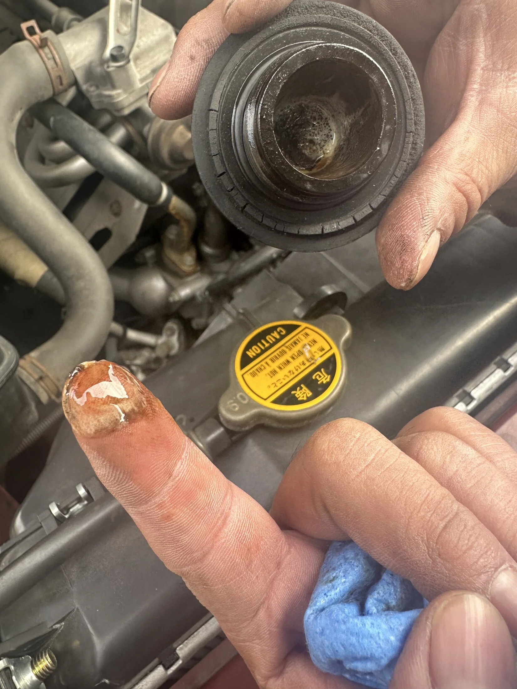

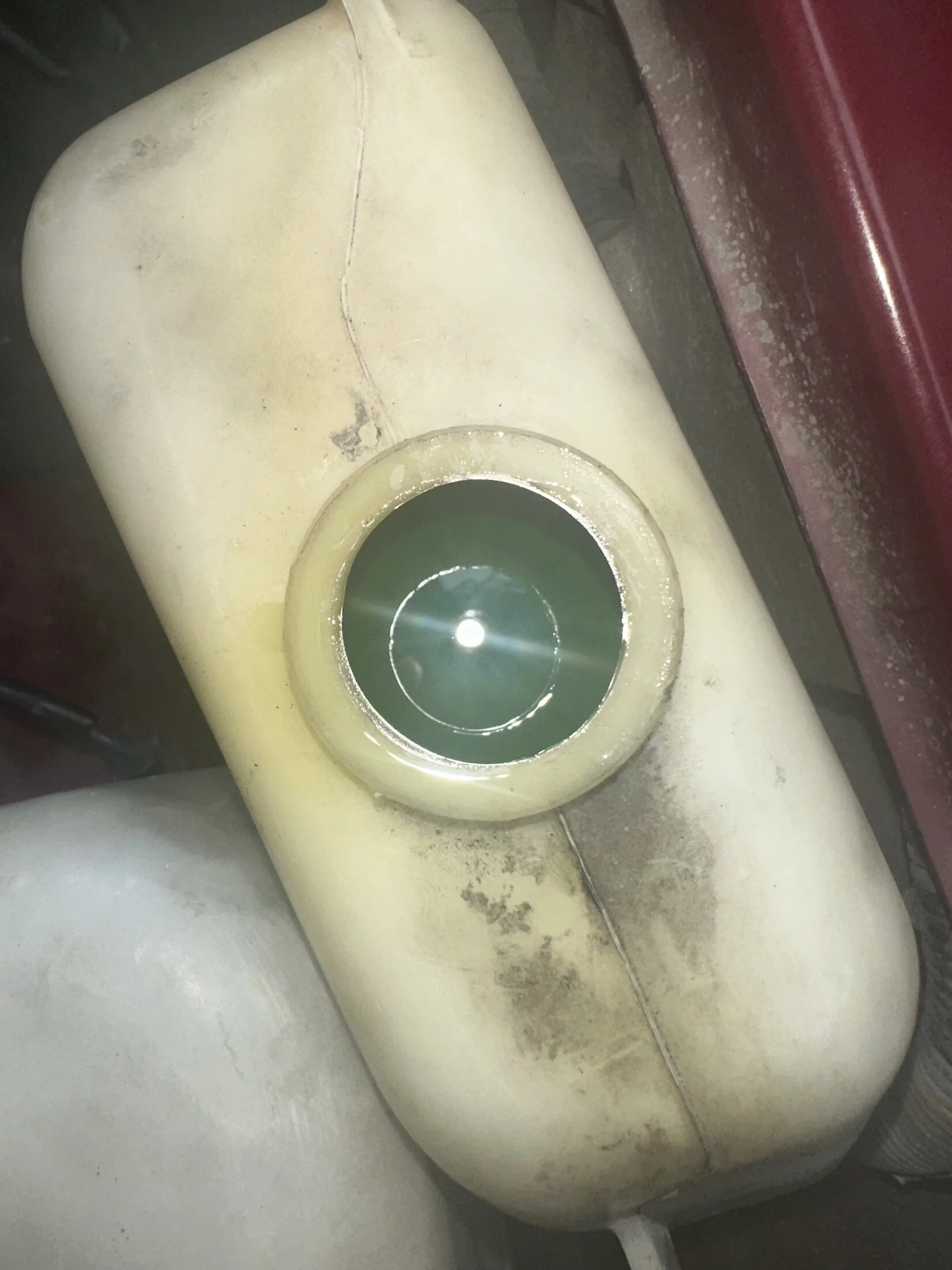

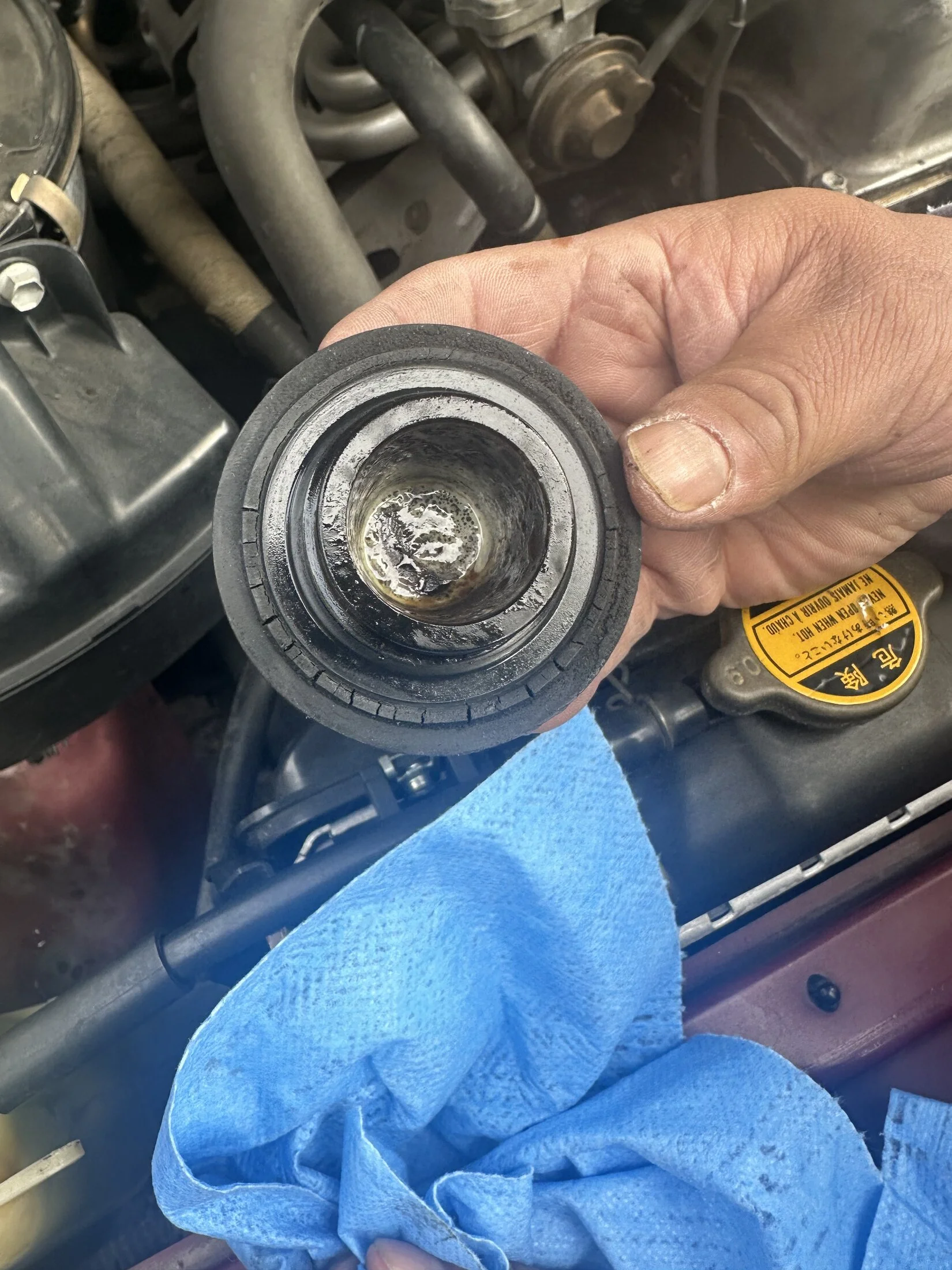

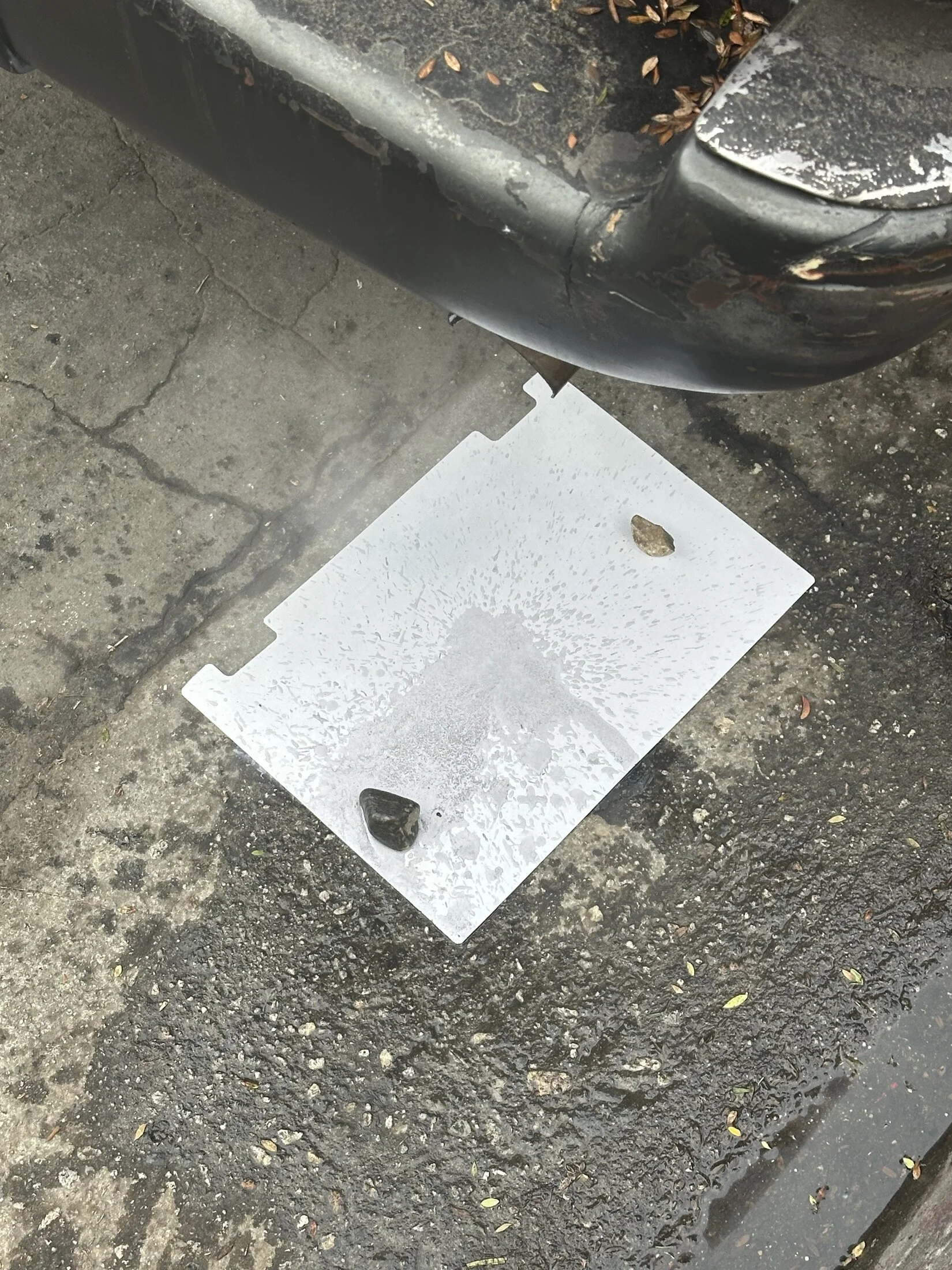

Soooo upon further review today, oil is milky and smells like coolant inside the oil filler cap. Checked spark plugs but they seemed normal, no water, went to start it up after checking n smoke from back, nothing heavy however after a minute or two started smelling the sweet smell went to turn off, let it cool down did oil change and sure enough milky oil light ish brown color.
Pictures please.....
Milky oil
Green puddle
Spark plug ends
Milky oil
Green puddle
Spark plug ends
Tried my best getting pics of everything forgot pics of spark plugs and no green puddle this time just water

I.see nothing in those pics that tell me that.
Disregard the oil cap thing.
I'll bet I can walk out to my truck right now and see that kind of milky stuff under the cap.

Really what about cloudy coolant, and water out the exhaust? I mean I guess I could do the combustion leak test but what else could it be then??
Don't jump to conclusions yet about the head gasket. A little milky oil on your oil cap can be normal. Especially with the cracked seal on your oil cap. You can also get condensation in your exhaust pipes that will drip out for a while after a cold start until it gets hot enough to keep the water as vapor instead of re-condensing. If you are getting that much coolant loss, your overflow tank level should be dropping pretty quickly and you likely would be getting compression gasses into the cooling system. You could do an oil change and see what the oil looks like if you want to, but I would start by keeping an eye on my coolant levels and by doing the following to see if there are exhaust gasses escaping into your cooling system which should be happening if your gasket is blown bad enough to cause coolant to be coming out of your exhaust.

I read that fast, I thought he said milky oil like he drained it and it was milky. I posted to fast, if it’s just under the cap he might be just fine. I should read thoroughly before recommending a huge job like a head gasket. Hopefully the OP does a test for gases in the coolant to verify.

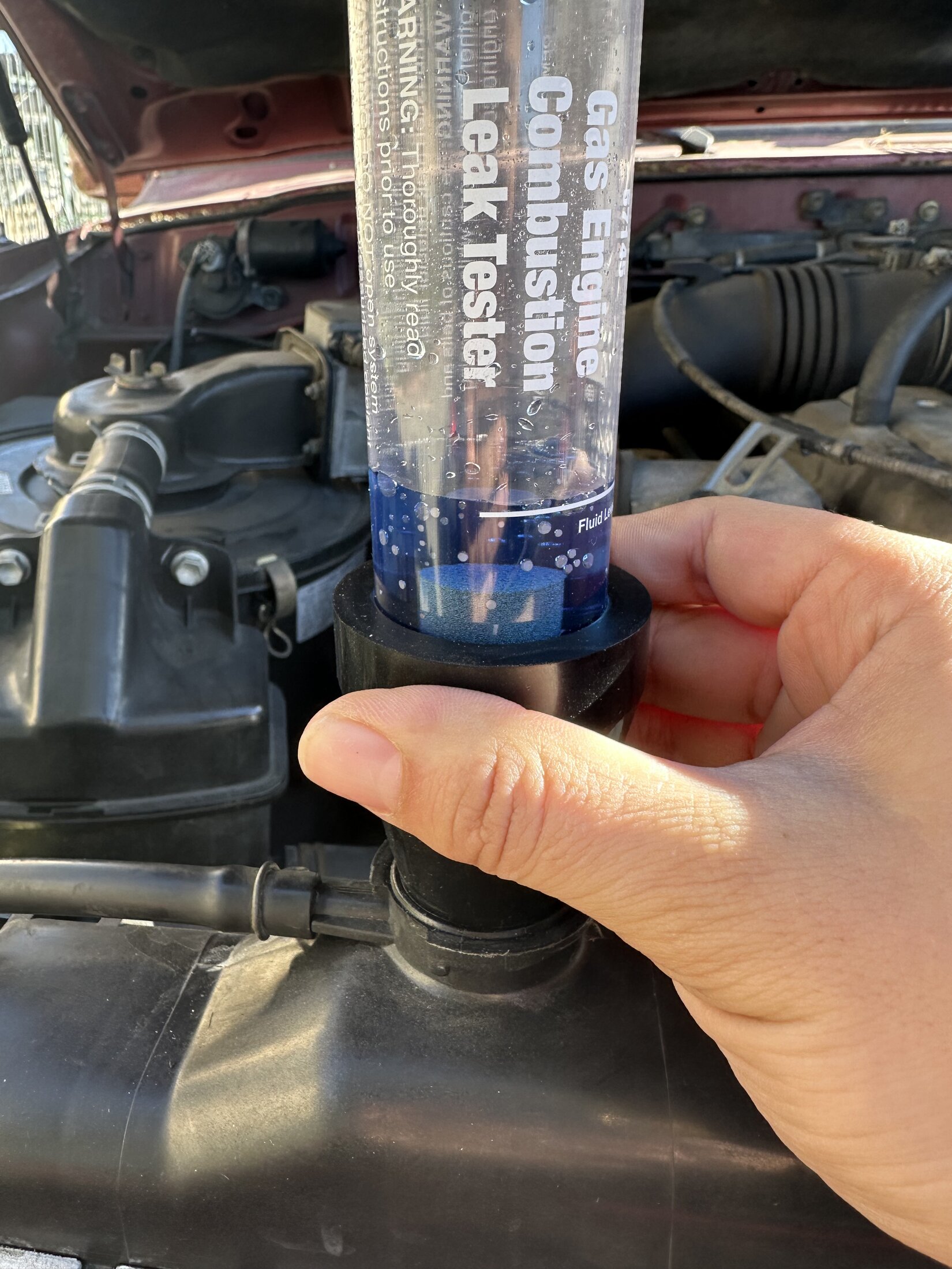

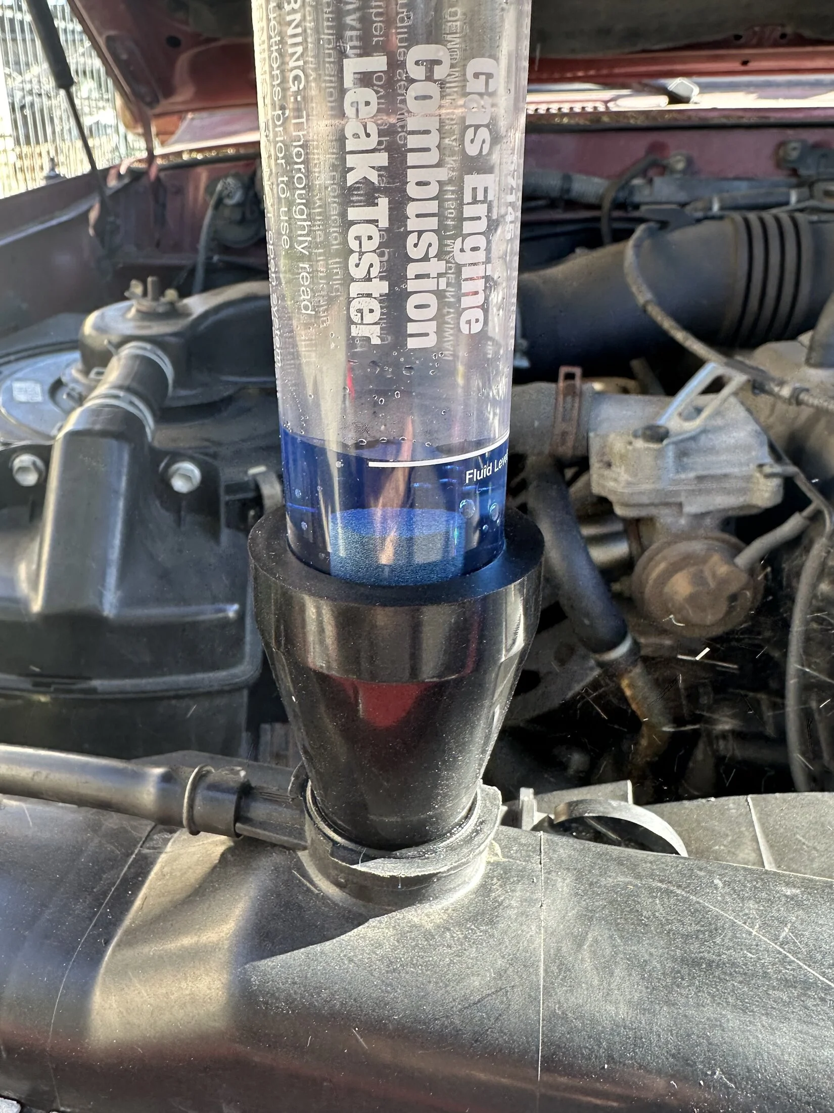

Hey guys quick update I’ve been real busy so haven’t had any time to wrench! But today had a bit of time before work and was able to do a combustion leak test and didn’t get any signs of gas coming through. First image was before starting her up and second was about 5 minutes afterwards.

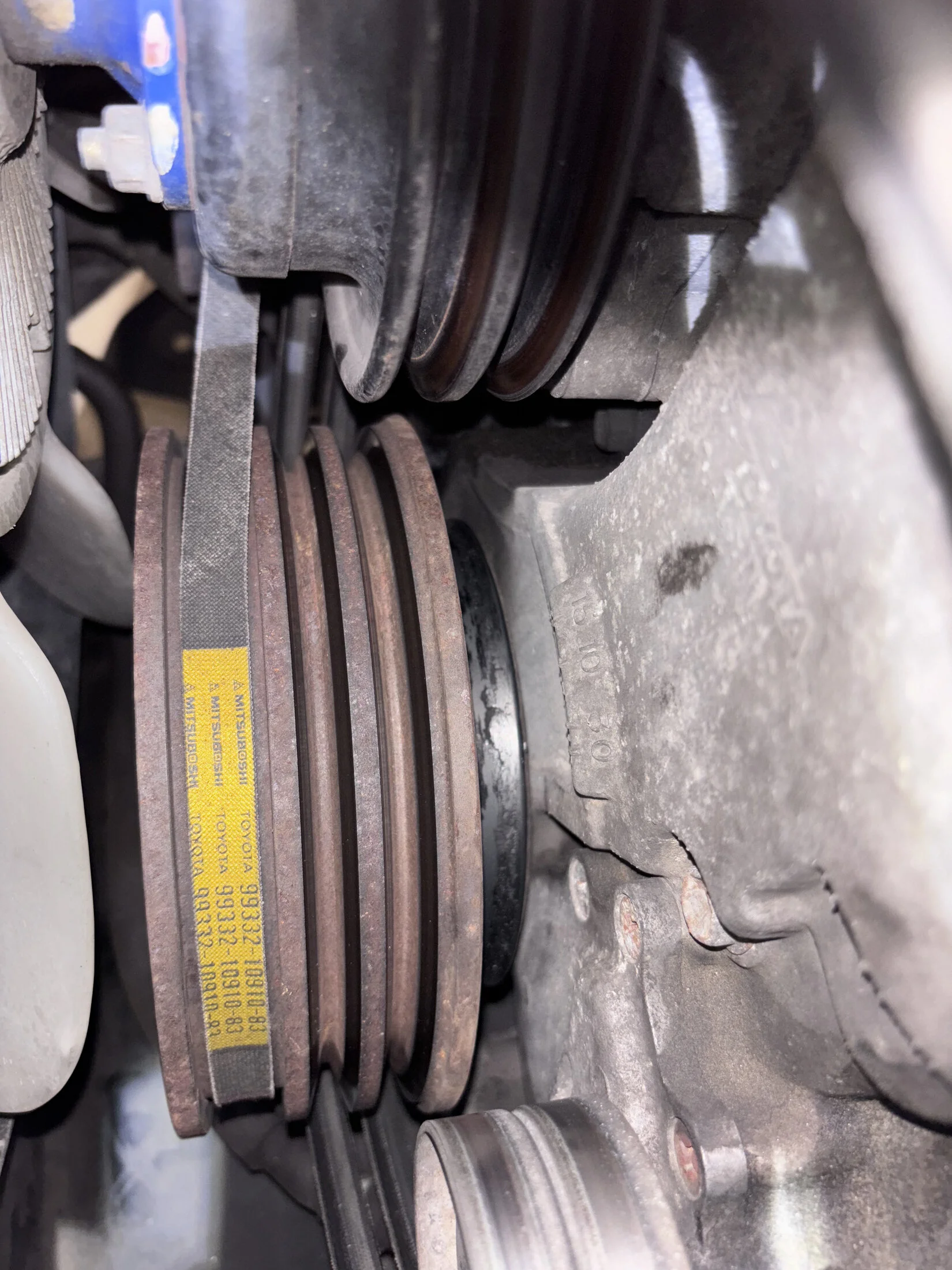

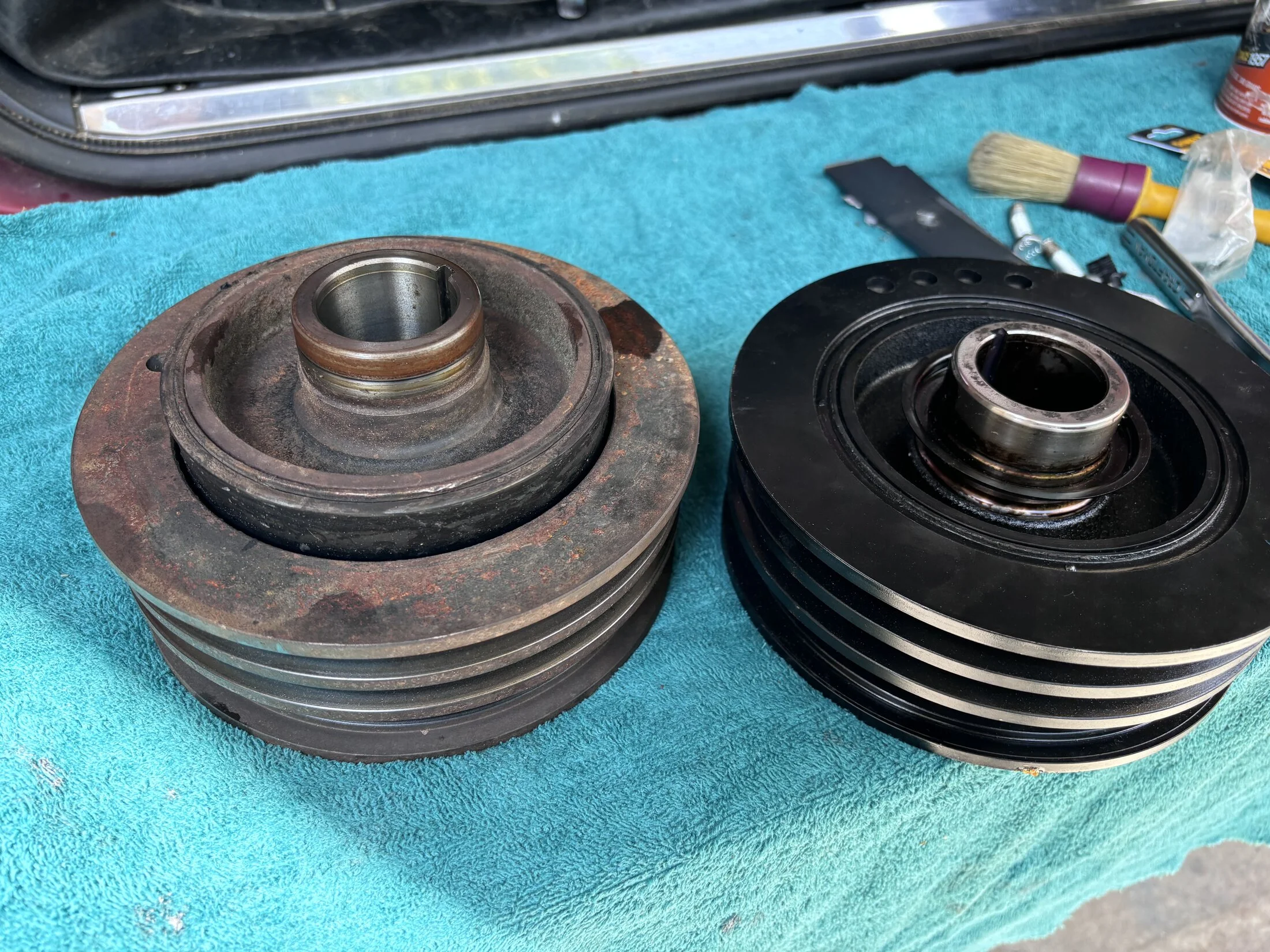

Interesting I had always thought that when this happens the engine would get hot since the crank is just spinning without the HB spinning the belts. Where were you able to find a new one?
Sorry, missed this. I think for the most part once the rubber separated, it ran as normal. I think this was our first sign of failure:
It was diagnosed as a bad oil pressure sender which never sat well with me due to the rough idle.
It took several months but this is what I found, the car is low use and had less than 500 miles in the interim period and most of that was one 120 mile round trip.
The harmonic balancer came from the dealer and was not cheap!
Sorry for the delay.
One of he comments was the HB ought to be periodic maintenance, I tend to agree.
