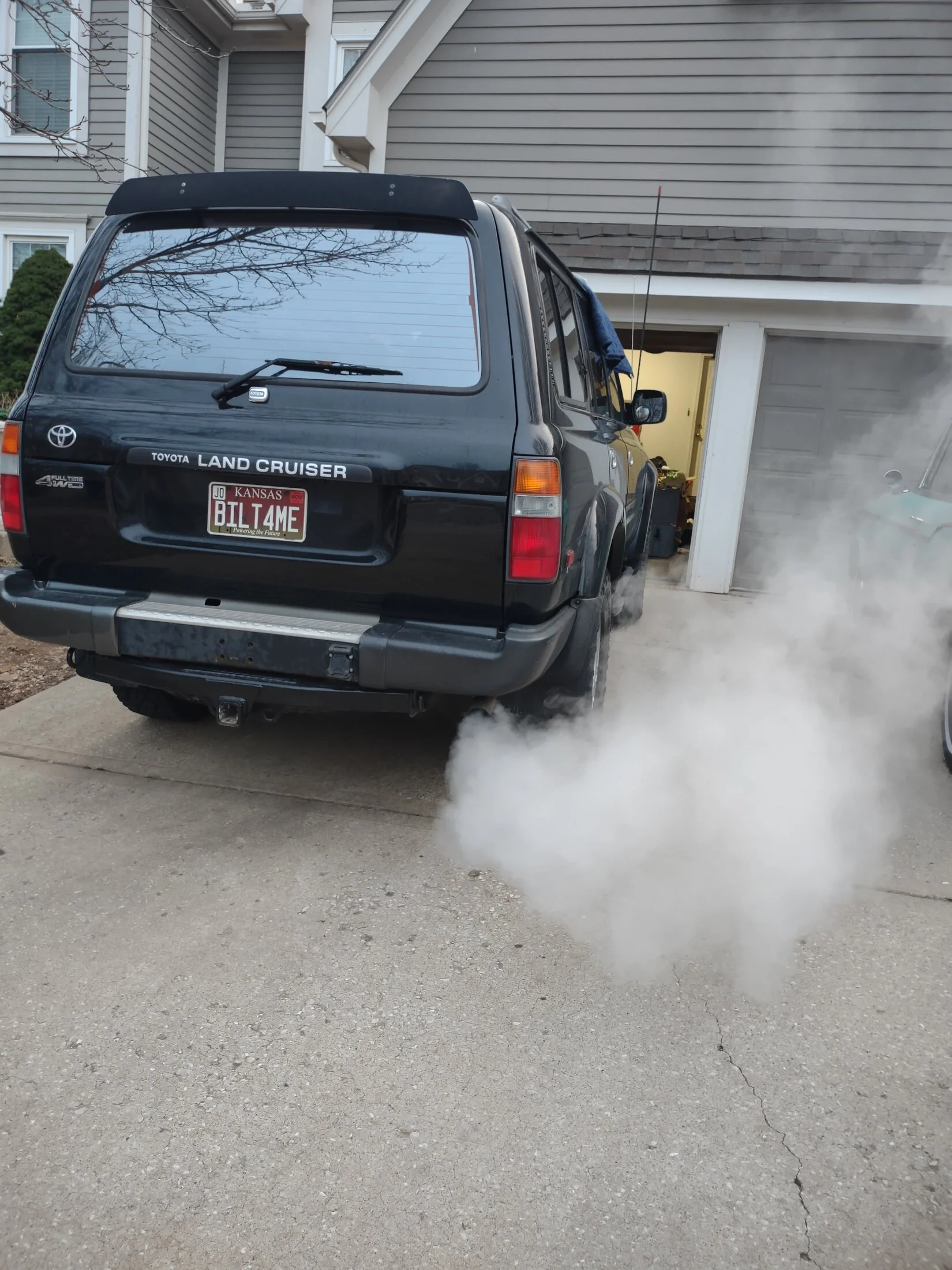

Okay so it turns out that I think my head gasket is blown 😐 have had her parked up and only moving it for street sweeper till I had time to look her over, this morning turned it on n white smoke from the back as well as bad idle. moved her n there was coolant from exhaust ):

What was the weather in your area today when you started this?
What did you smell?
What color was the exhaust?
Did it lessen over time?
How long did you let it run?
Have you checked your oil?
Is the oil have a chocolate milk appearance to it?
There are so many things to check before you says it's a HG.
How many miles on it? Has it ever had the HG replaced?
You bad idle is most likely a vacuum leak.
Did it look like this?
That was a quick assumption! Do a combustion gas test in the coolant. The kits are relatively cheep and you will know for sure. I agree with the above post handful of things to check before spending any money.
Yeah pretty much looked exactly like this and wouldn’t go away it also wasnt that cold maybe about 70 F and very little moisture in the air. Haven’t checked oil yet haven’t had the time to but when I do I will also be doing a combustion gas check. I let her run about 10-15 min before she started stuttering n dying out. It currently only has 147k miles on her, previous owner did mention he changed the radiator like a month or so before I purchased no mention of previous head work.
Yeah, will be doing this when I have the time I hope it’s not but the greenish puddle out of the exhaust was pretty scary lol
The picture I showed was of my truck on a cold start day with high humidity. Definitely not a HG.
If you actually had a green puddle out the tailpipe and you are using green coolant, then you may have a problem.
Did it smell like maple syrup?
The HG on my truck was replaced at 145K, so you're in the range if it's never been done.
