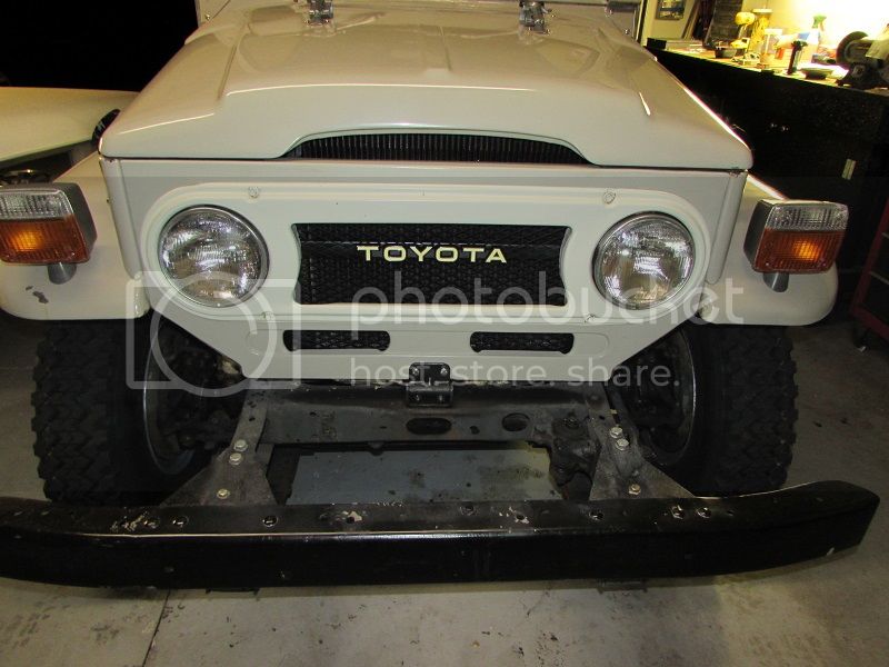

I don't have a good before pic but the grill emblem was faded bad. I could have painted it I guess but new emblems are still available and not too expensive.
The mesh grill had overspray from trying to paint the emblem on the grill. So I took the grill off, scuffed it good, and painted it.
The bolts for the hinge to frame connection were about 1/4" from being tight so the bib would fold down as well as rotate. So I took the hinge off and painted it. I replaced the hardware on the hinge with SS.
I replaced 4 bib to fender bolts and I still have 4 bolts that need to drilled and tapped due to snapped bolts. I just ran out of time today.
