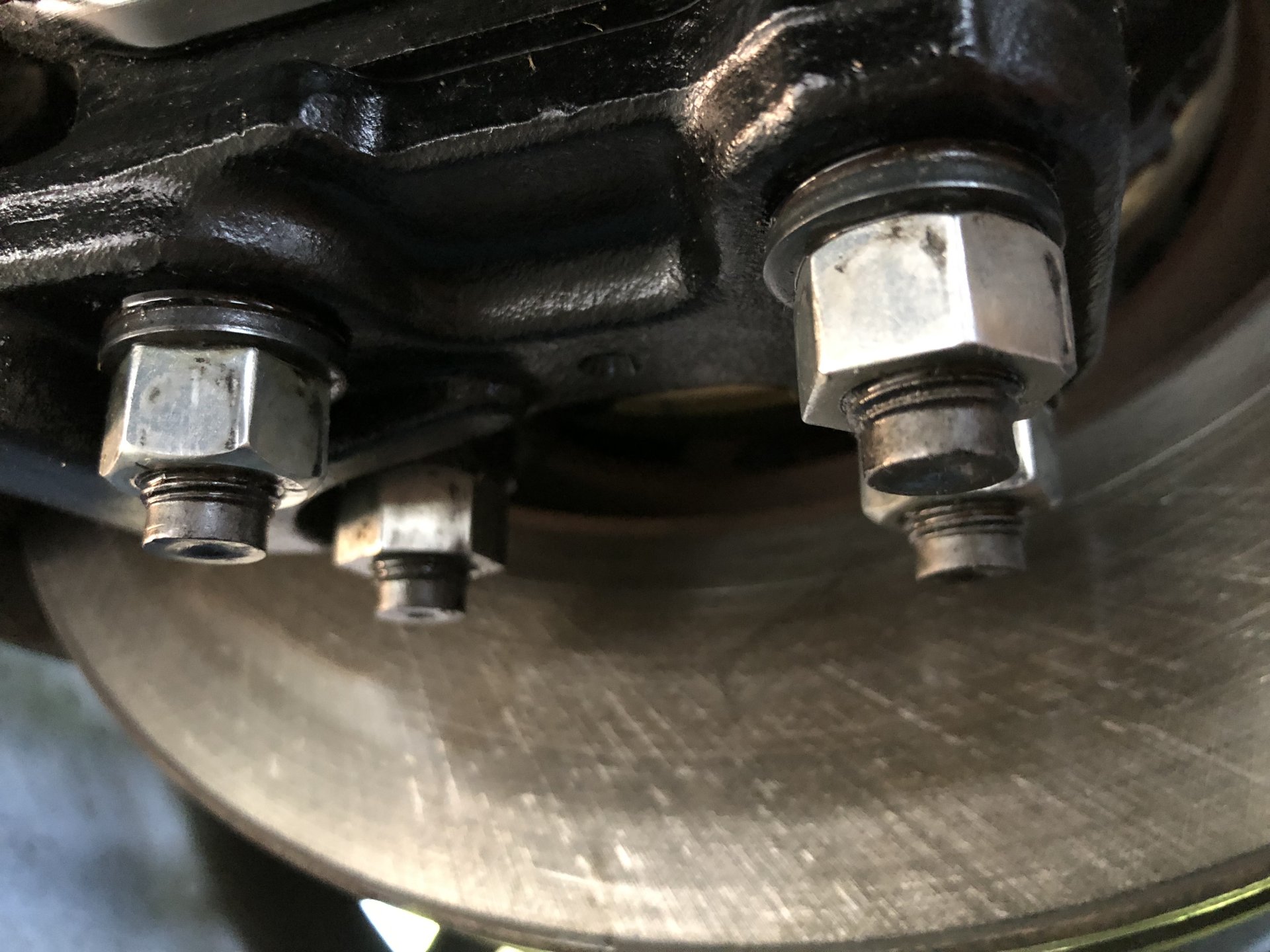

Both axles were rebuilt recently

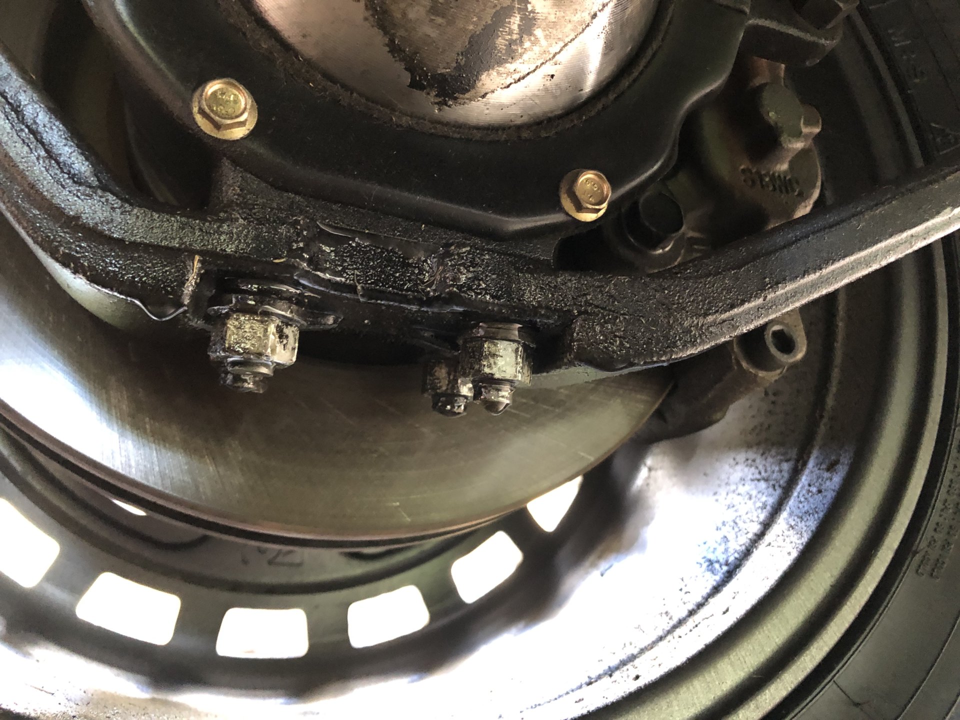

Noticed the passenger rear axle is leaking - tried to tighten the nuts but they all free spin. Guessing they are stripped
Would that cause it to leak this much?
Both front axles seems to have a leak as well- any idea on how to proceed
Is it ok to drive it as is?
I appreciate any and all help

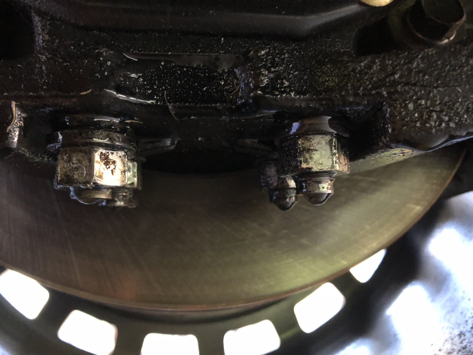

Who rebuilt your knuckles?
Who stripped the axle flange studs on the rear axle?

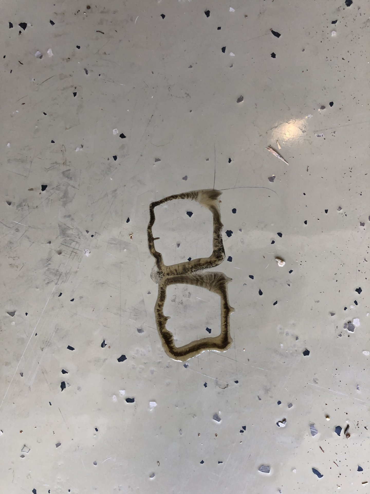

No, it shouldn't leak there.
You have gear oil dripping from the knuckles. That's supposed to be grease.
Whoever did the work is an idiot.

So do I Need to rebuild the knuckles?
They do need to be taken apart again to correct these issues, yes. Can you tell us more about the job & parts used? Did a shop do it?
A recent knuckle rebuild shouldn’t leak anything, especially gear oil..
It has happened before where a mechanic who was familiar with Land ROVERS worked on a solid axle Land CRUISER, and filled the knuckles with gear oil instead of Moly grease. More commonly the axle shafts have deep wear grooves so even a new axle seal won't keep the gear oil out of the knuckles. Another cause for gear oil getting into the knuckles is if the garter spring on the axle seal was knocked out of place during installation.

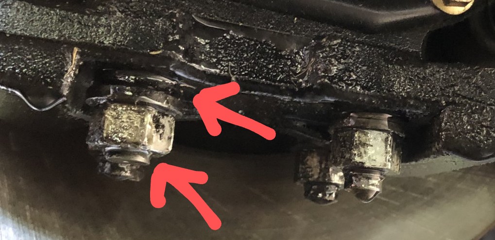

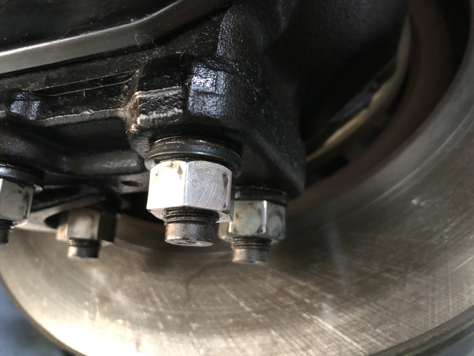

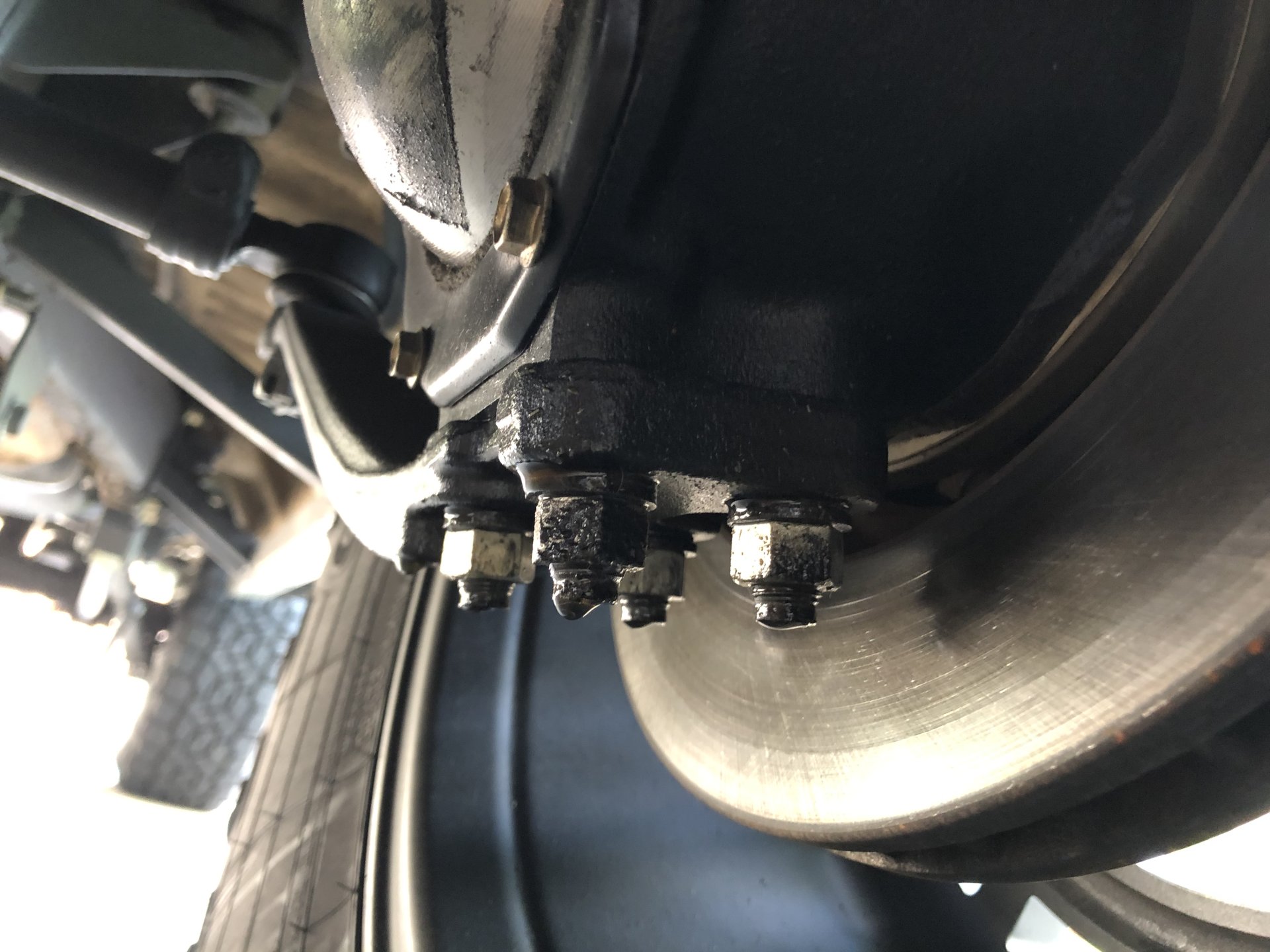

Almost looks like a flat lockwasher (or ?damaged/loose cone washer) is sitting under that nut??

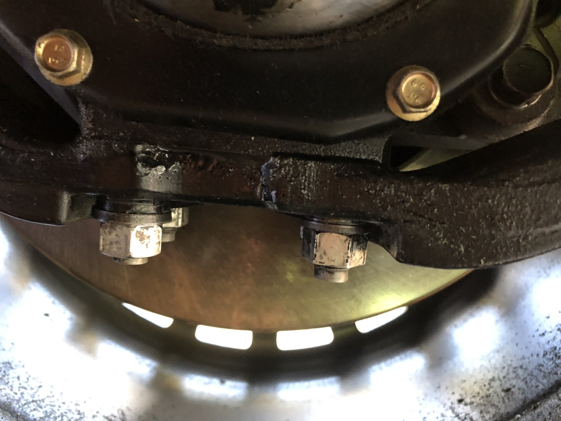

@texote : can you clean off the knuckle studs/nuts (show in the photo above) and take another photo?
Something up with that left passenger side stud. Almost looks like an extra washer?
But the bolt isn't seated all the way like the others
Looks like a double washer.
How much you want to bet that he stripped the stud, then installed a second washer to cover up the mistake.
Guaranteed it's not tightened to spec of 71 LB-FT
