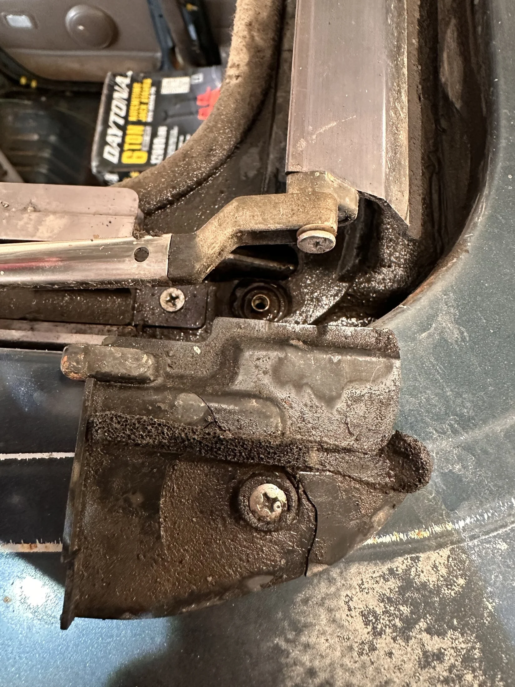

fzj80 leaking sunroof!!!! need help finding a part..
May 19, 2025
5
15
florida
anyone know where i can find these parts for the sunroof? or should i just slap some silicon in there and call it.. will that help?
AFAIK they're discontinued..
To fix a crack you could (of course) try superglue, if you have a plastic welding kit that would work better.
(how did that get cracked, someone try to pry it up??)
If the cable covers are warped you can take a heat gun (or maybe hair dryer on high) to try to flatten them out.
IME there are two possible leaks sources related to the cable covers, one at the screw itself ie: down the threads, so you can seal that with a non-hardening thread sealant.
If water is overflowing the drain pan one thing you can do is to build a mini-dam or wall using butyl rubber under the cable cover (either on the bottom of the cover or at the low edge of the drain pan under the cover) then press the cover into place.
Anyone with a 3D printer should be able to reproduce the cable covers, possibly improve the design.
