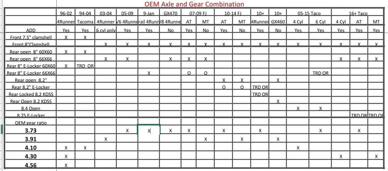

Anyone have experience with or look into swapping 2010+ MT FJ Cruiser axle/clamshell in? Seems like a great budget option if you can source the parts. Factory full-time 4wd like the GX (no ADD to worry about up front) and slightly better 3.91 gear ratio for larger tires. Most had a factory e-locker out back and 2010+ would be the 8.2 3rd member/housing.

No, I mean rear 8.2 and front clam shell swap with the manual FJC. Front and rear should match with our AWD system. Even though 3.73 (GX470 ratio) and 3.91 (MT FJ ratio) are close, it would likely cause some serious issues at the center diff.
This is pretty much the interchange for 120-150 platform.
I have a rear 8.2 and a front from a GX460 about ready to swap in to my 470. They have the 3.91 ratio and I'm adding an air locker to the rear.
