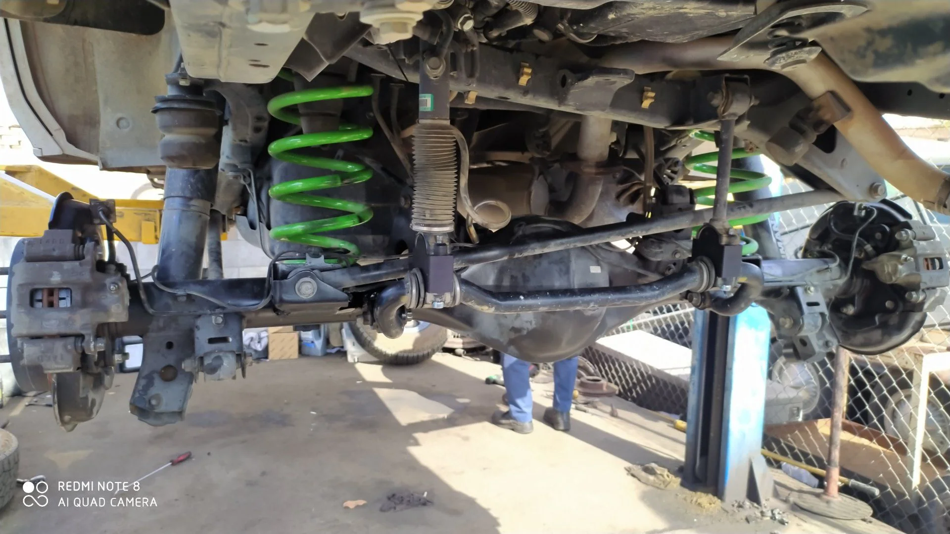

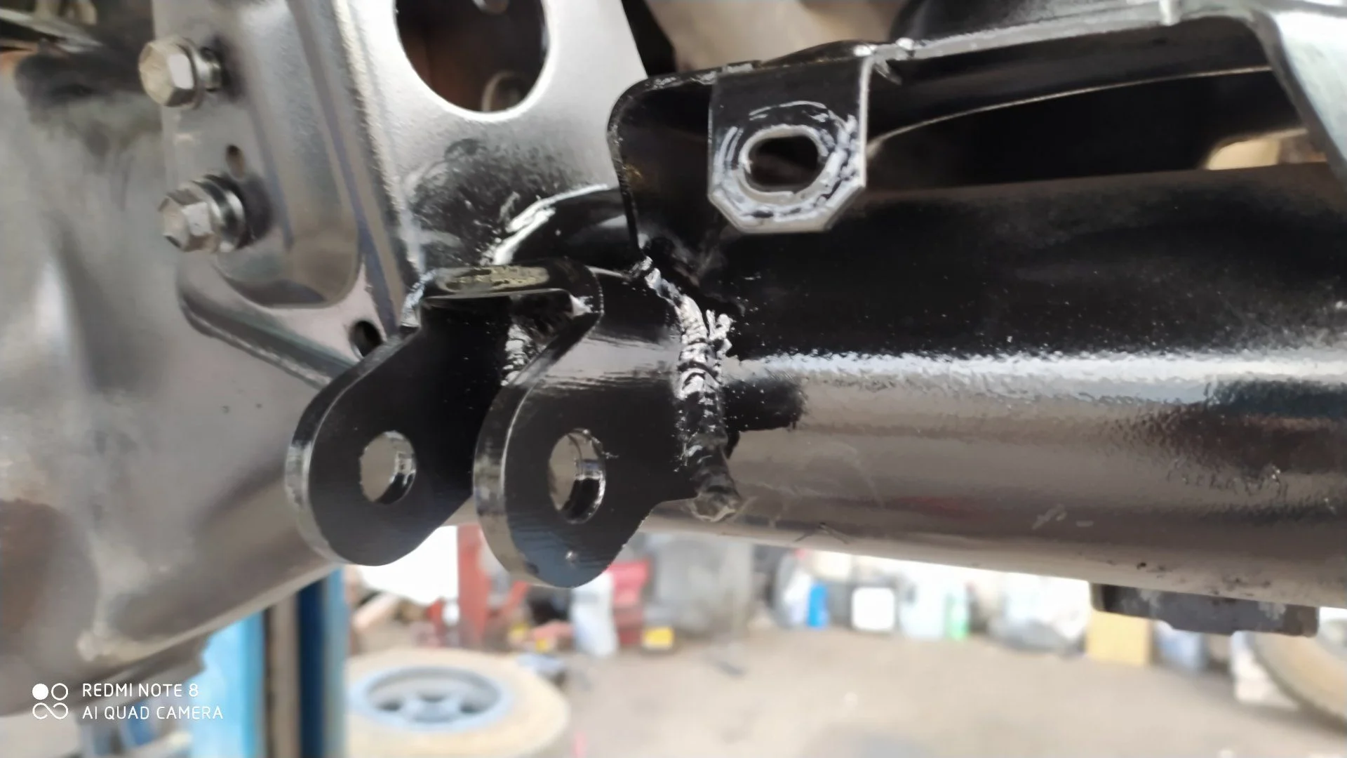

finish with the 8.2 swap. pretty much straight forward beside the 2 brackets for the kdss sway bar.
Here the cost brake down
Complete fj 8.2 elocker axle - 2500
brake pads - 60
Brake rotors - 120
sway bar brackets- 30
diff fluid - 40
elocker wires - 150
blood, sweat and tear - priceless

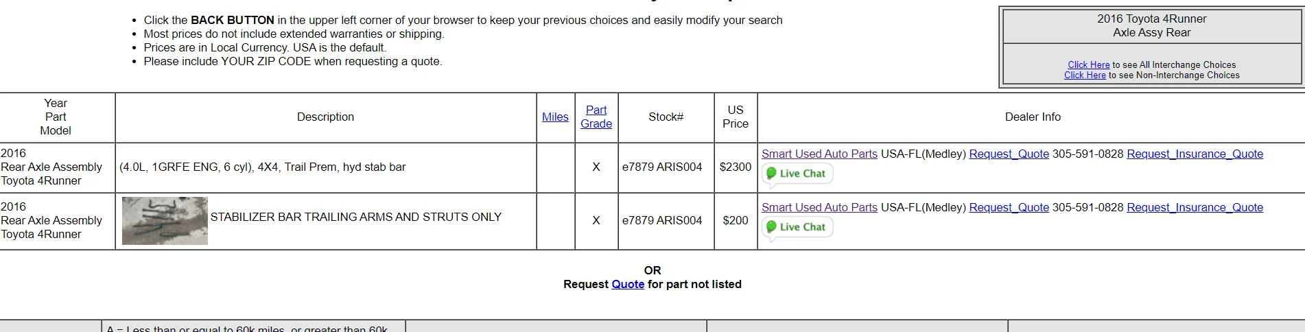

Is $2300 reasonable (JY) retail used pricing for a 5th gen 4R KDSS rear diff (maybe/prossibly with eLocker)? car-part.com, located in Florida
I paid a lot less than that, but it was years ago - I'm not sure what current pricing is like.

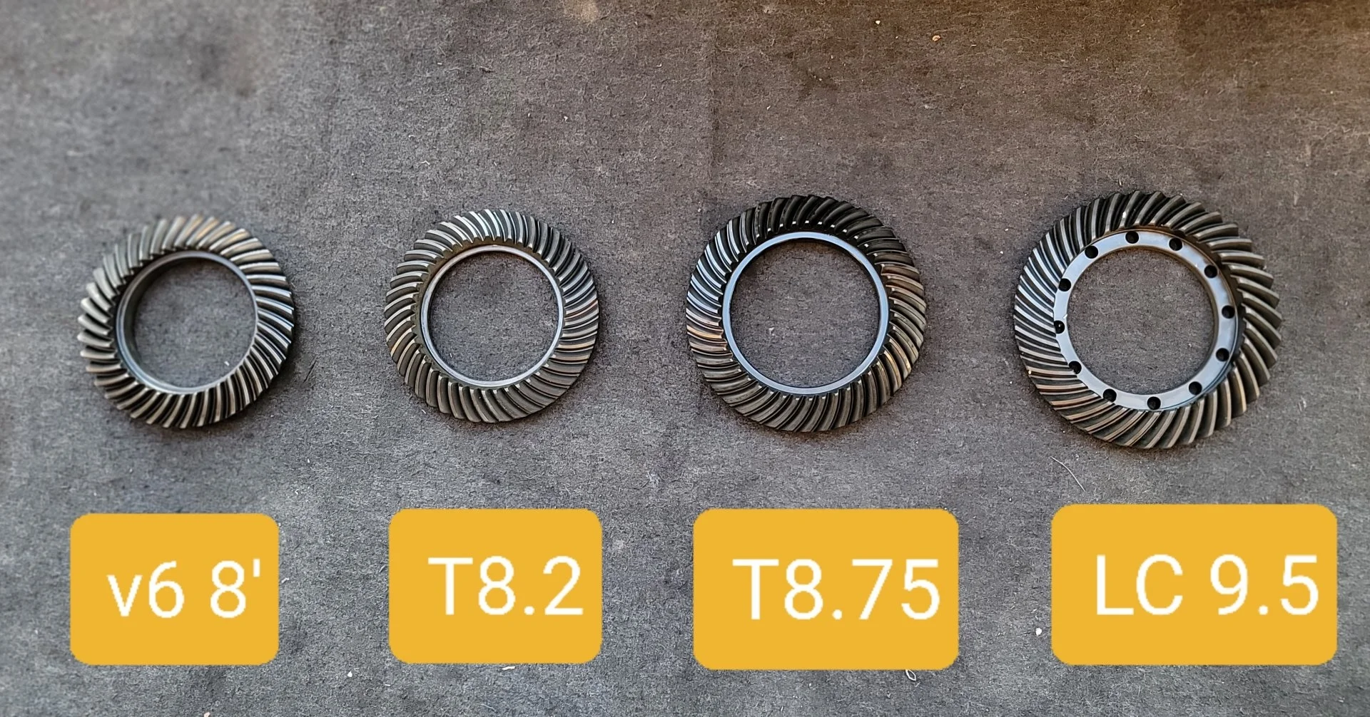

Wow lately I seeing a lot of guys chasing 8.2 axles. Glad I'm not one of those guys, price is the same as a diamond and still weak when your a heavy Gxs in my opinion. Here some comparisons I put to together in my garage. Yes my gx470 will be getting a 9.5 w/Arb 488s.
Isn't the 8.2" the largest "straight swap" with 3.73 gearing?
the diamond rear axel does swap right in. it's a custom built unit, and I think the latest poster is arguing that with the 8.2 hype, the price difference is minimal for getting something much more indestructible.
ah, I see that. I just looked them up. I'm sure they're much stronger and I'm sure it's nice to have that piece of mind. However, it looks like it's closing in on $5k by the time it's sent to your door. That's a bit rich for my blood. I could break and replace a stock axle 5 times over for that cost.
