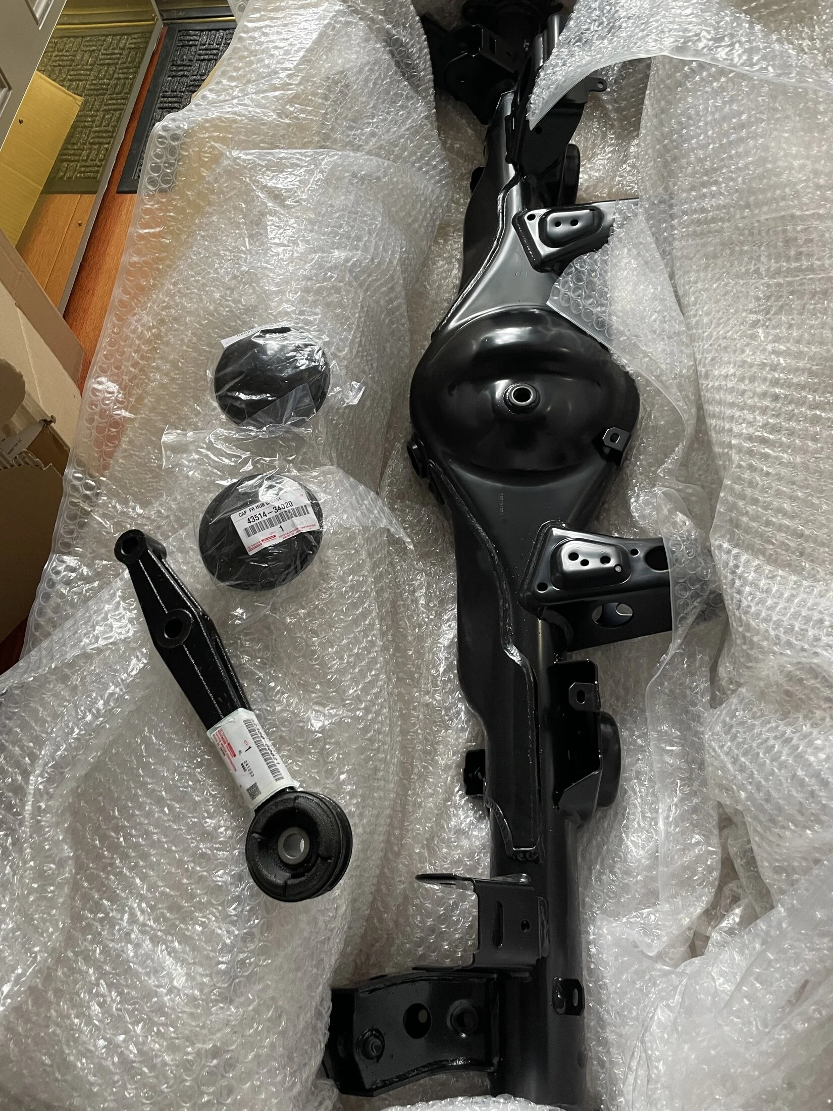

Just stopped by my house for lunch and this was waiting outside the door. FedEx driver had to be cussing me as he dragged it up the stairs. Have a full set of belt mouldings and a couple other small items too. View attachment 3922979
That’s the 8.2” housing?
Never mind…open sesame…it’s the housing
