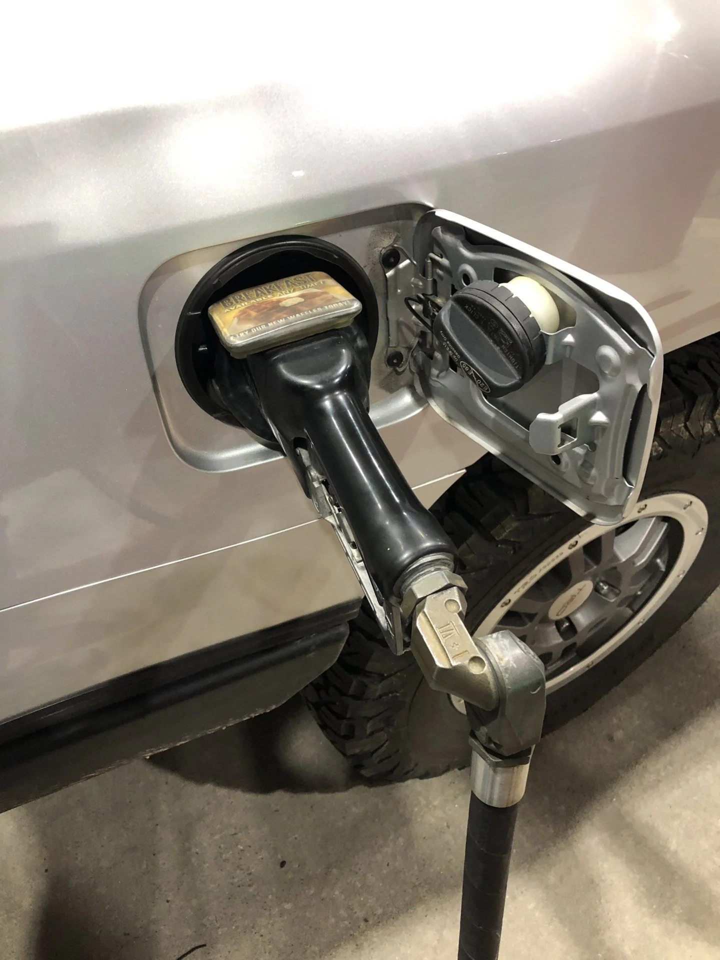

I’ve had my tank for about 6 fill ups so far. First one was flawless. second time it clicked off multiple times on the main tank and only once on the aux tank. Since then it’s been hit or miss. The last two times it has shut off multiple times while filling the main tank. I’ve tried different depths and different angles.
Can those of you with a bit more experience kindly grab an “angle pic” during your next fill up? I hope I just need to find the magic combo and then repeat it!

It does get better with practice, but occasionally I run into a pump that is just super sensitive to splash-back.
95% of my Costco fill-ups go without a single stoppage...
Have you found the main is better than the aux or vice versa? Is there a magic angle or is it just luck of the draw?
I’ll try standing on one leg next time if need be!
If Both are empty, I fill the main first...then aux.
You just want the spout facing directly down each tube rather than angling toward the side of each tube.
Those systems work on back pressure. And it is a function of the size of the fill tube. You now have smaller fill tubes, so the back pressure increases, so it is more likely to cut off. I find that I can still fill my main tank at full flow, but I cannot fill my auxiliary tank at full flow, I generally do it at the first click of the device that sets the fuel flow rate.
