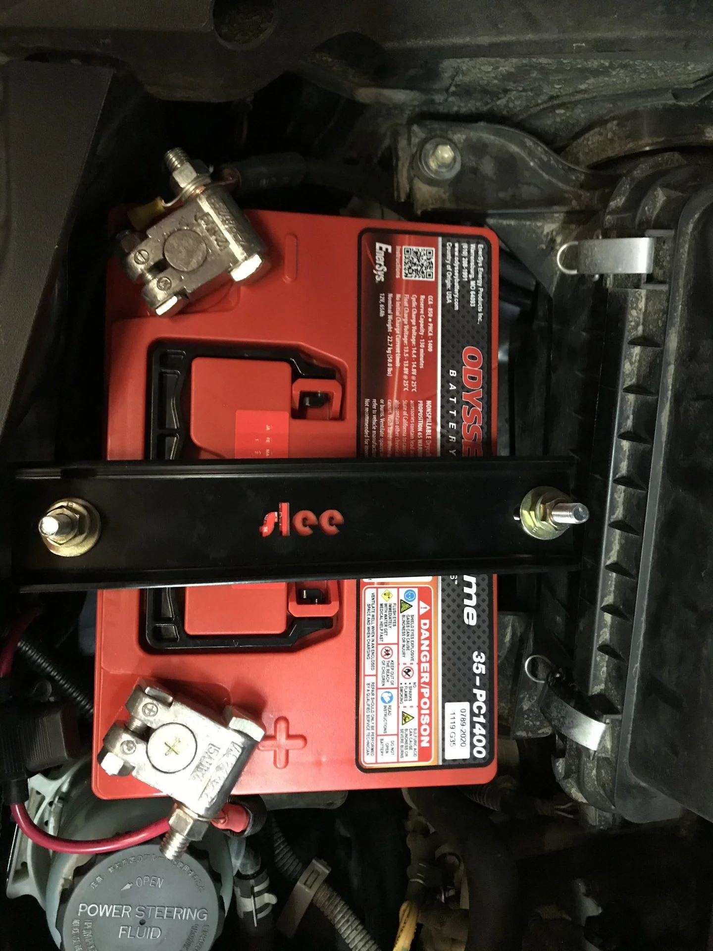

The customer also requested an OME BP51 kit along with a dual battery setup ( Odyssey ), Redarc kit and ARB dual compressor so we got a hold of our friends at @sleeoffroad who supplied the secondary battery mount along with the brackets for the Redarc and ARB compressor.
Whenever we install an LRA aux tank, we take the vehicle to the local gas station and fill the aux tank to 50% capacity, then drive the vehicle until the proper fuel level is displayed, then transfer roughly 5 gallons. After that, the vehicle is brought back into the shop for a final inspection to ensure there are no fuel or vacuum leaks or other issues. Then and ONLY then we let them go back home
