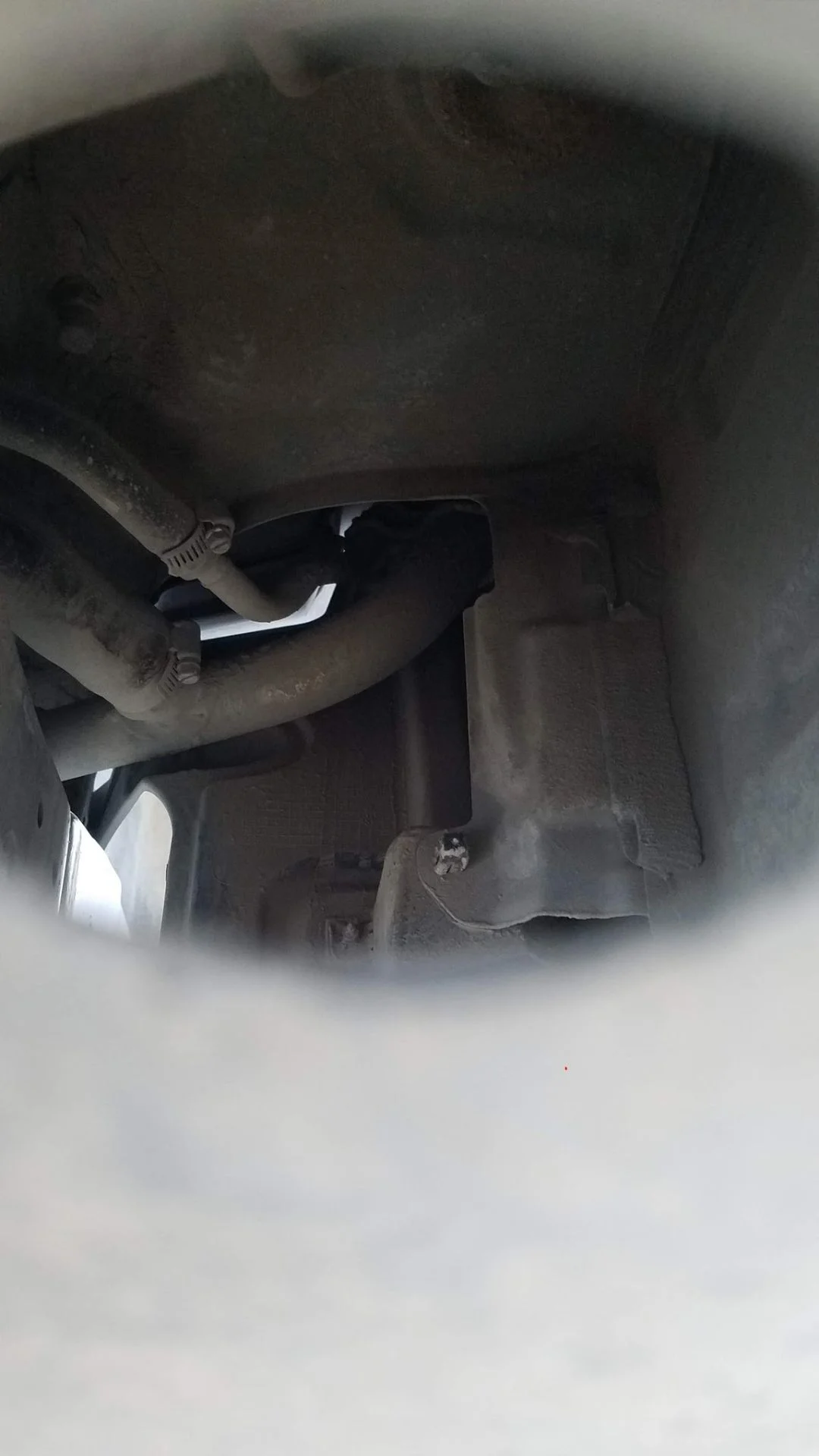

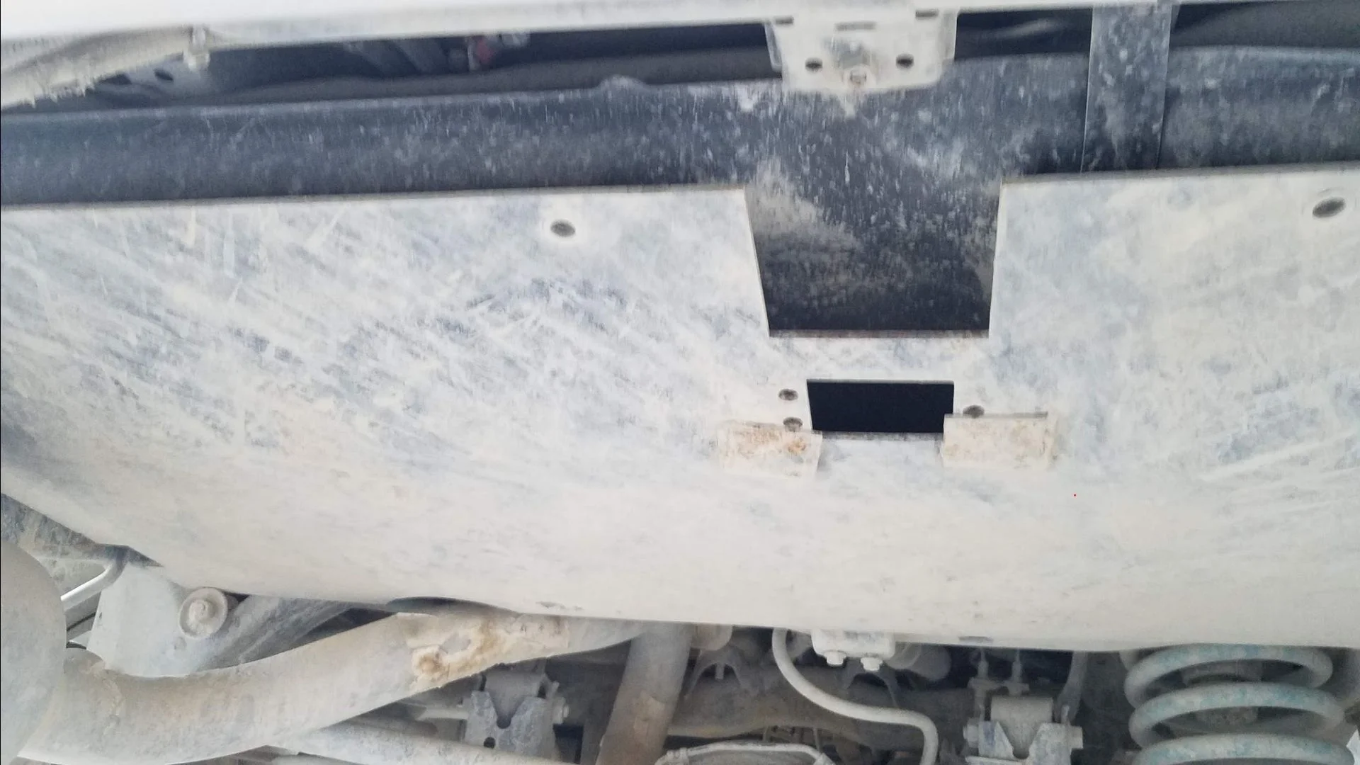

@TeCKis300 Attached are all of the images that I have of the OEM auxiliary tank on 200s. The one with the armor plate underneath is a diesel, the other three images are from a petrol.
The tank is much heavier than you'd expect and is coated with a thick black rubber material (petrol tank specifically, unsure if diesel tank is the same). I thought I had a picture of the tank once it was removed but can't find it right now.
