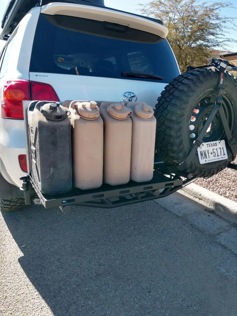

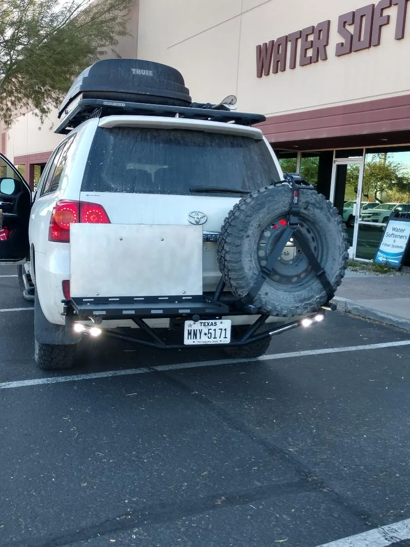

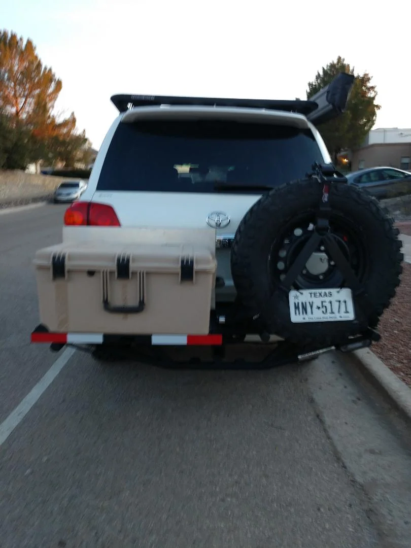

I went with a @westcottdesigns hitch mounted tire carrier. Much cheaper than a bumper and more versatile .

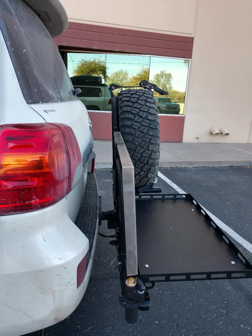

I've seen these but had a couple questions for a real user...
Does that thing hang down below the back bumper as far as it looks? Also, from that angle it looks like the tire hangs out past the side of the truck... But does it?
No it does not hang down below the hitch .

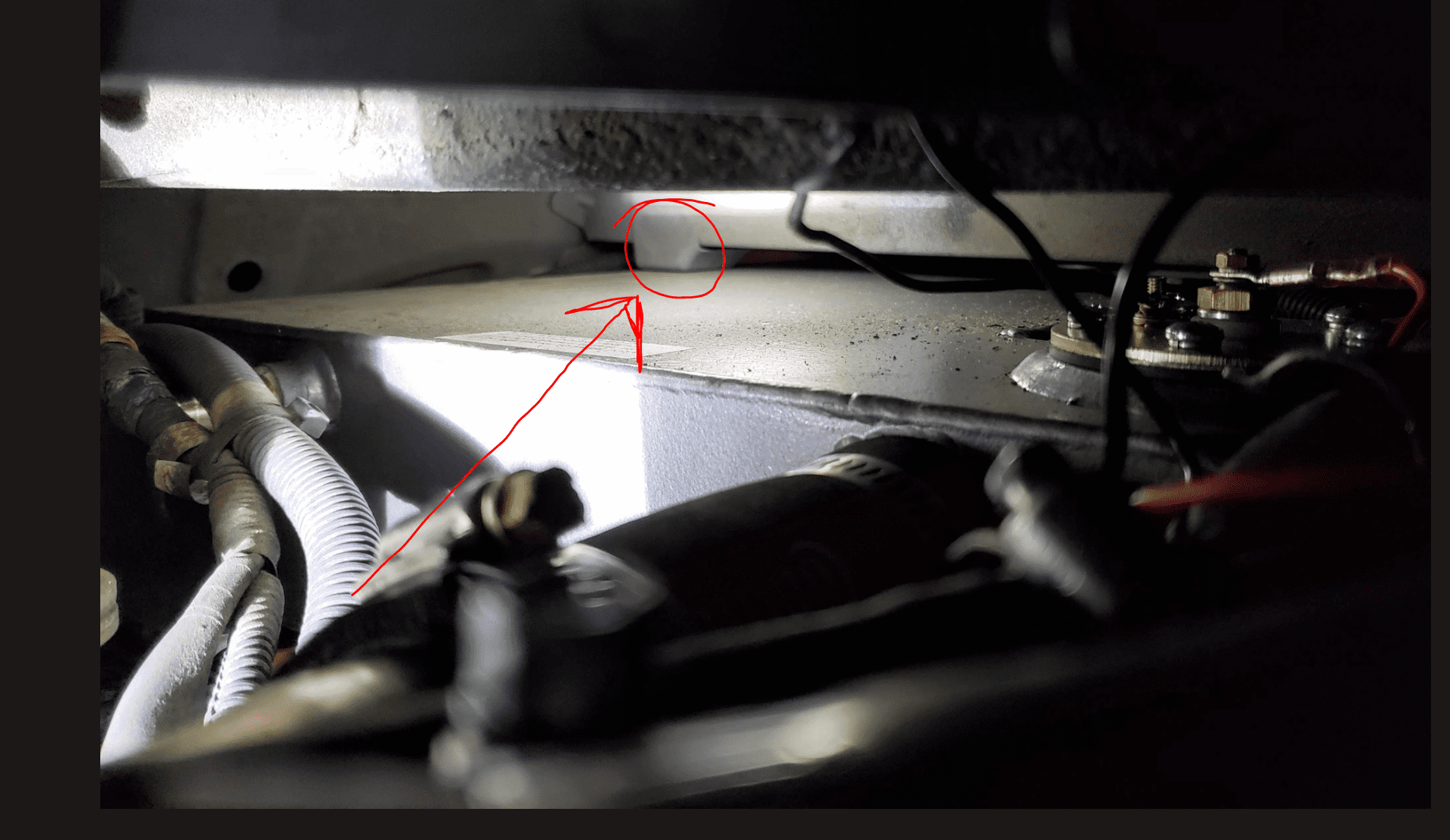

Red and black wires at right:
I don't mean to kick you in the nuts, but aren't these 2 tabs supposed to be cut off? I remember seeing a post about it somewhere, and now i'm wondering if my installer cut them off as well. What's the issue, if any, with leaving them on?
That might have been my post. I don’t know what tank you all have, by my experience is strictly with the 12.5.
These tabs are one of the things that is overlooked in the LRA instructions. Unless they have updated things in the past year, there’s no mention to cut those off for the 12.5 install. But, after I installed, I was looking around online for more adequate help/documentation to double check things, and I found an Austrialian video and they cut those off.
If you notice, the tank does push up right against it if they aren’t cut off. I was having issues with my pump and wanted to do some upgrades on the wiring and hoses, so when it was dropped, those tabs were cut off. They were definitely rubbing against the top of the tank and had worn off paint. I would suggest cutting them off if you’re going to drop the tank.

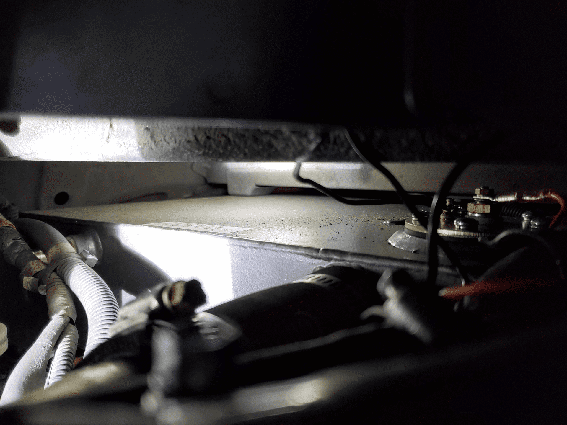

How did you manage this shot? Wheel well or down from the rear axle? I spent a few minutes trying to get up in there to no avail. I'm hearing some weird squeeking/rubbing, and I suspect my installer didn't cut these tabs off.
If I'm thinking about this correctly, the tabs are connected to the body, and the tank is hanging from the (screwed to the) frame, right?
From the passenger side rear wheel well. Gap between the body and frame. It's a pretty narrow slit. Used some extra lighting from a pen flashlight and my cell phone butt up against that slit.
Yes, tabs are on the body. Would be pretty hard to impossible to remove those tabs with tank in place.
