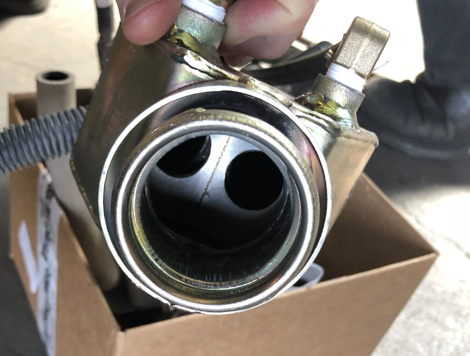

I have this aux tank on another vehicle and instead of inserting the hose at the normal point at 12 oclock position I turn it 90 degrees when filling and then it fills fine, but at the 12 oclock position it keeps shutting off.
I stopped by a station earlier today to confirm the ability to INDUCE auto shutoff with angle change . Yes. Easy to induce.
So...consistent with my initial issues With first fills last July...and basically no issues 6 months later after frequent use/familiarity... it does get easier if you know what you need to avoid doing. Remember, too, that even familiar pumps can become problematic filling any vehicle.
May very well be ONLY the angle and less to do with recapture pumps. Hard to test here since we only have fume-recapture pumps to fiddle with...but easy for others to try on regular pumps.
