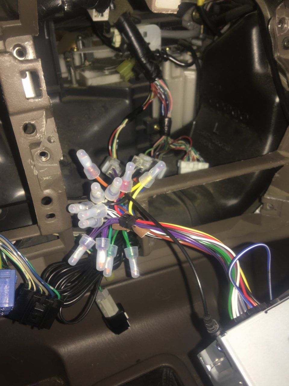

That's great to know. Thank you. Now please excuse my next dumb question. When I had this head unit installed I let car toys install it (I tried at first and had no luck turned out the head unit was messed up) but I can't figure out what they did. I know they used the adapter from Crutchfield to go from head unit to speakers but I can't tell now if they bypassed the stock sub or not. I'm kind of in over my head here (15 and just descided today I wasnt happy with the sound). But if you don't mind me asking I know this is dumb but where do I go from here? Do I take out the center console to access the stock amp? I already have the back one out. I'm just concerned about the wiring and how to go about this.
Here is a pic of the wiring in the front
