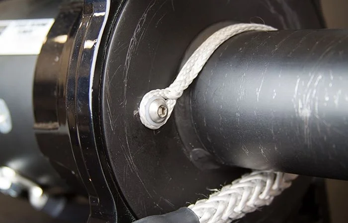

Just adding to the suggestion box. Not mine. Pretty sure my rope came terminated and its bolted to the drum. So bigger terminal on end of rope and bolted to drum.

99% sure all i did was widen the hole and tie a knot on the end inside the drum. Nothing fancy.
