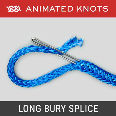

The buried splice (also called a tuck splice or lock stitch) is what you want for synthetic winch rope. It's what the factor 55 Fid makes easier, but you can absolutely do it by hand with just a fid needle or a length of stiff wire — takes some patience the first time. The key is to bury the tail at least 12-15 times the rope diameter for a working load splice, so on 3/8 Amsteel you're burying about 4-5 inches minimum. I've had students pull tested at 95%+ of line strength with a good bury. The other thing people skip is whipping or heat-shrinking the throat of the loop so it doesn't fray where it bends over a shackle. Do that right and the splice will outlast the rest of the rope.

For 3/8” rope, I tuck in 24” or so. Since my first pull on an extension with tucked splices resulted in some rope movement on both ends (and those hadn’t been preloaded, so…), I now use a Brummel splice at the loops before the tuck. That has worked well for me.
I’ll add this link, I’ve found super helpful.
