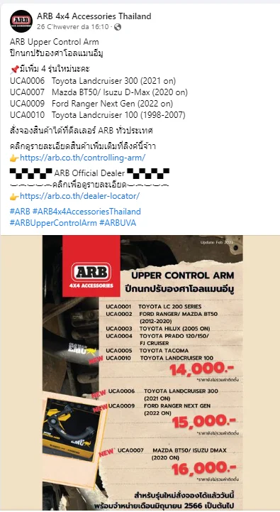

Saw this one has now been made available for the 100 series.
P/N: UCA0010
