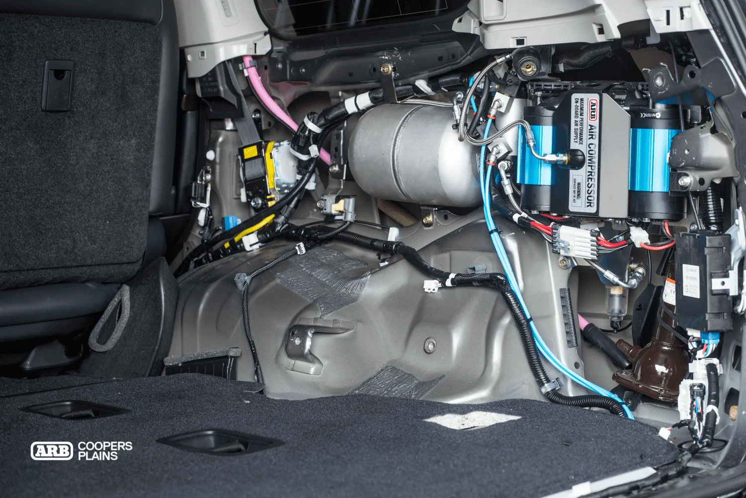

I am a long term Prado driver and a happy new LC200 owner. I am working my way through some early mods and have caught the dangerous LC bug... So far, OME 2" lift installed, ARB bumper w T-Max 12500 winch, Rack. Next projects are lights and compressor/Air lockers. I am planning on the ARB front and rear air locker and want to mount the compressor (CKMA12 - not the twin) in the rear of the vehicle inside the rear quarter panel/trim. I found this system for mounting the twin compressor & air tank, but I am wondering if anyone has mounted the smaller ARB compressor here? Any thoughts?

Rear Mount ARB Twin Compressor Kit - ARB Coopers Plains

Seems pretty cool. I’d prefer the compressor mounted there over engine compartment but the factory subwoofer got first dibs...
Seems like a clean solution as long as the compressor gets enough ventilation and doesn’t get too hot in that spot.
I have this same concern - I have not used (don't own it yet) this ARB compressor so I unsure of its' ventilation requirements. Obviously, mounted under the hood, it gets full ventilation, but I'd be very interested to know if anyone else has mounted one in an enclosed space and how they dealt with the ventilation needs.

Ventilation under the hood, but LOTS of heat. Mine gets pretty hot even when not in use due to engine bay heat. Thinking that without engine, it should be ok.
If OP is just using it for lockers probably ok however airing up tires not so much. It will be noisy in either case. Pretty heavy draw a long way from battery too.
Personally I’ve experience zero issues going under the hood. And ya...it will be loud for passengers sitting in the truck while airing up. A lot easier to go under the hood, and frankly, the small tank isn’t much use. It still isn’t going to power air tools, so I’d probably skip the tank.

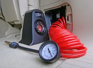

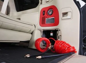

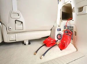

Can’t imagine it’s as robust as a VIAIR or ARB compressor and it couldn’t possibly have the capacity or duty cycle worthy of Mud members, but it apparently exists somewhere in the world it seems cleanly integrated...
That's pretty slick. I really like the regulator feature. I wonder, however, what the duty cycle and flow are of that little compressor.

Just something to note, I can’t imagine that ARB would install their compressor into this location, market it as an alternative to an engine bay location, and not take into account their own specifications on ventilation for the compressor. The pictures above are from a ARB shop build and they marketed this truck pretty heavily...thus I would think they would have taken into account this location and ventilation/heat issues that could arise.
One would think so but? I for one prefer the engine compartment. What was not shown was the location for air hose connection to air up tires.

In speaking with Mainline Overland recently, they were pushing to put the compressor in the rear as ARB did with the above pix. I asked about using the Slee compressor mount under the hood and they wanted to go a different direction bc they were finding that on 16/17 200s, the mount and/or compressor was shortening out and causing electrical issues. Anyone else have experience with this issue?
