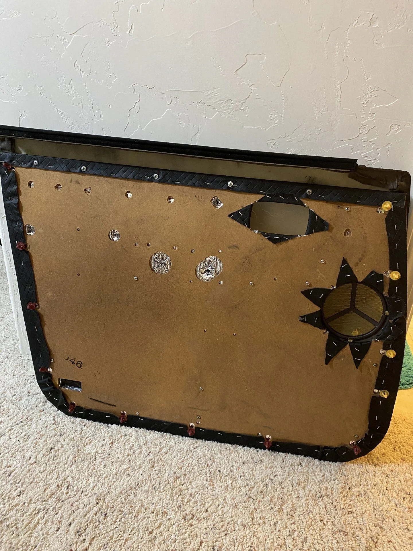

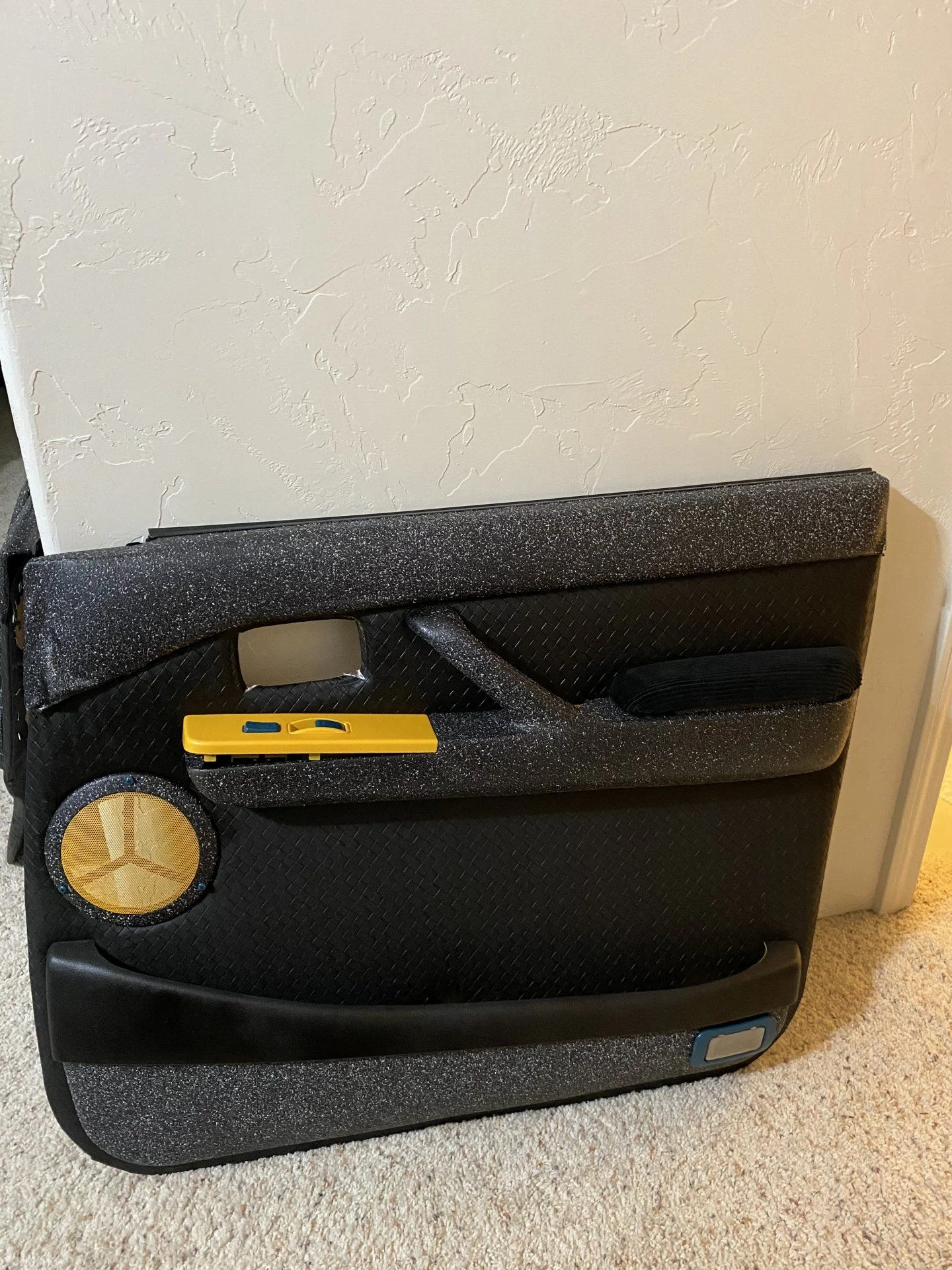

I just basically did this with my 97 lx450, I stripped the doors down to the plywood and reinsulated and reupholstered with black fo leather from Walmart and a staple gun. I’d say it’s totally worth the extra hours. You can also use the fabric to cover the suede trim pieces around the cage. I’m about 75% there with mine. I can throw some pictures up tomorrow if you’re interested.

Here’s the passenger side pretty far down the line. I did two layers of basic insulation, cut and stapled. I did a stone finish on the top and bottom of the door, if you remove the carpet from the bottom of the front doors either sand off the adhesive or just use a primer and a textured paint to cover it. The lighting is LEDs so it doesn’t do the obsidian stone’s actual color justice.
