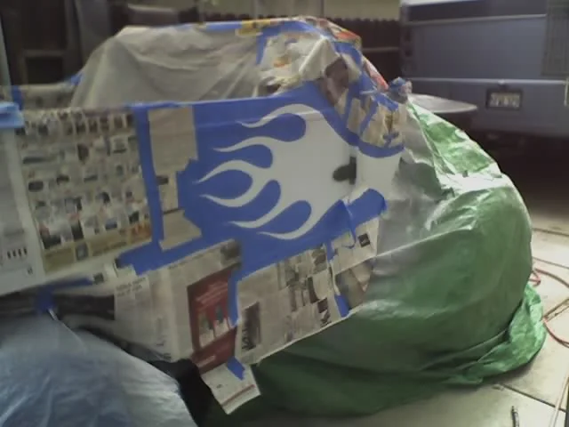

Well have color on the whole body and have the silver colored pearl ghost flames shot on the body. Just need to sand everything down to 800 and shoot the clear and I'll be done with half of my long winter project. The front clip is completely finished and sitting in a room in the house.

Pics include the front clip and the tapped off flames on the half doors.

Shot the Peal for the flames over the weekend then cleared the doors yesterday and started to retape the body for its clear coat. Been breezy the last couple days so hopefully it'll be still tomarro, unfortunataly I have to shoot it outside but the clear dries to the touch in about 15 minutes.
