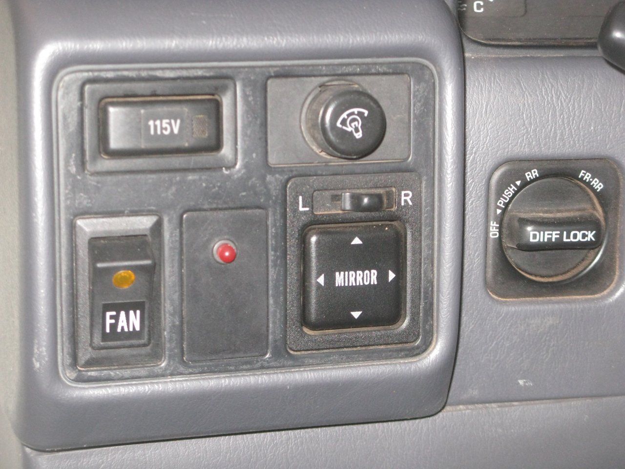

Im from AZ and from my testing I found a 100 series condenser fan works great. Having compared a JDM side by side the 100 series fan produces more flow. This test was done by feel so YMMV.
My needs and purpose for an aux fan was to keep the AC output as cold as possible in traffic and provide better cooler when wheeling under a heavy load at slow speeds. The 100 series fan only use ~5 amps,, quieter than the JDM and I mounting as low as possible to keep normal flow at it highest. No special controls needed with low amp draw just your basic rated factory Toyota relabeled fog light on/off switch.

I was looking for an on off on switch but not really sure of dimensions for the popouts...
Tons of threads on aftermarket switches that will fit and work but a Toyota factory switch makes it easy.
