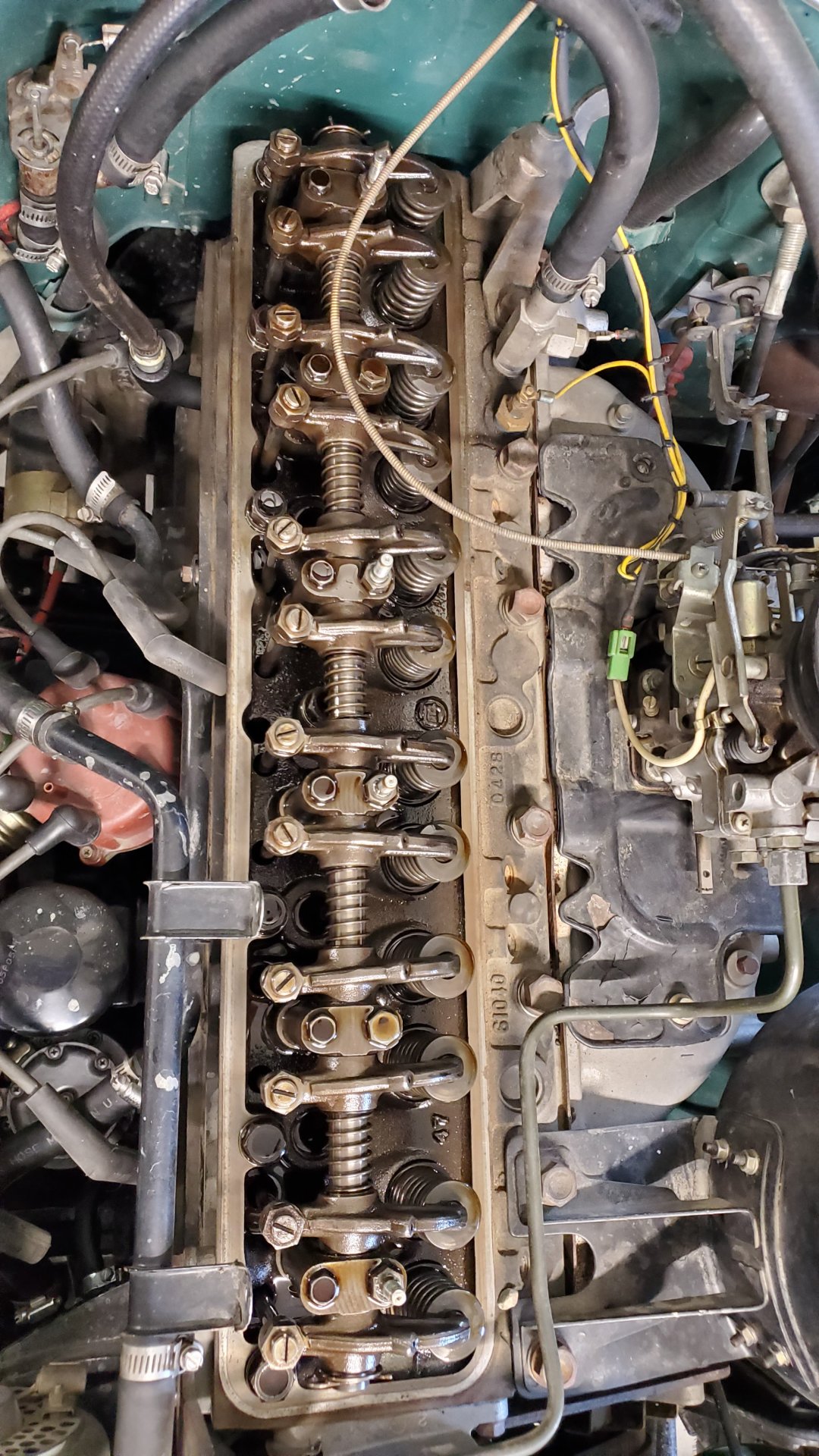

Valves all looked good. I'm impressed with how clean it looks under the valve cover also.

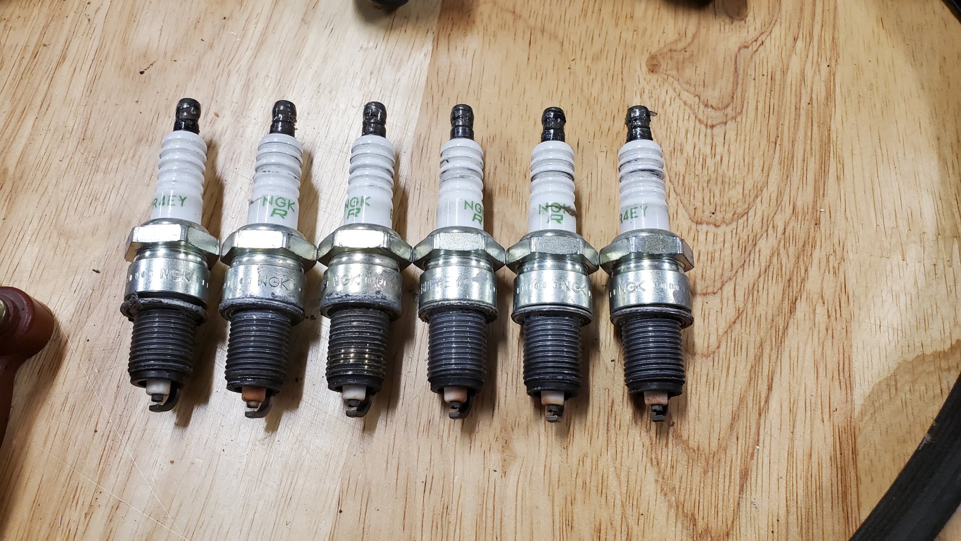

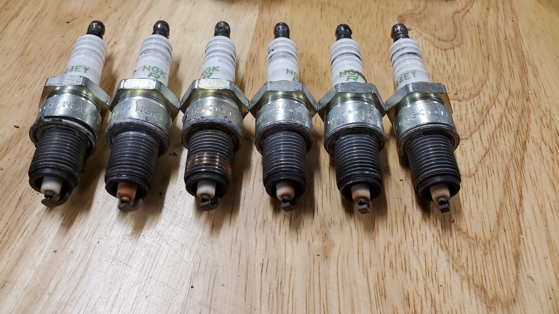

Right to left, front to rear.
Valves were all pretty good, nothing that was obviously wrong, or much more than maybe a fuzz off. Plugs all looked decent, #6 looks like it just came out of the box, #5 no so much. The timing was right where I set it a few months ago, the BB just visible at the bottom of the window.

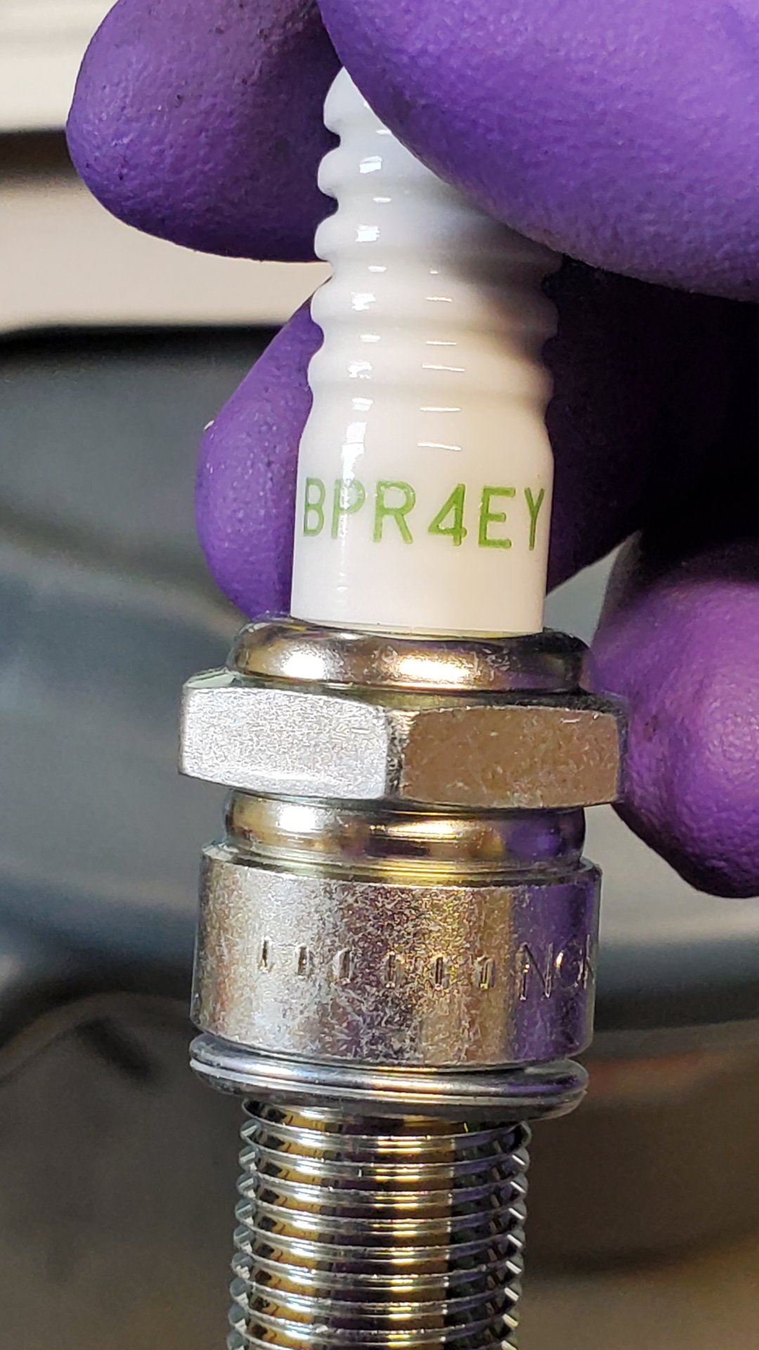

Curious as to what spark gap you‘re using. You are turning a bit more hardware in 4wd.
Whatever the OEM spec plugs are, I checked them when I put them in over the summer, I didn't see any reason to check today.

Your plugs suggest to me that fuel mix looks a bit lean - tan, not white is normal, but, I don't know that plug heat range? I use NGK BPR5ES, and Denso. My worst gas mileage was 8mpg. My best was 15mpg.

Not implying this has anything to do with your mileage drop, and it might just be the picture, but I asked about the gaps because your’s look more than the 0.031-0.035” the F-manual specs out. Not sure what 2F specs are if that’s what you have. Winter blend thought is interesting, didn’t know they did this in gasoline, know about the diesel winter blend. I run non-ethanol in my old cruisers to avoid alcohol issues and aging out issues.
Those plugs were installed in April of this year, I didn't see anything alarming with them when I had them out yesterday. The mileage drop was with the last tank, subzero temps, snow covered roads, and 4 hi almost the whole tank.
