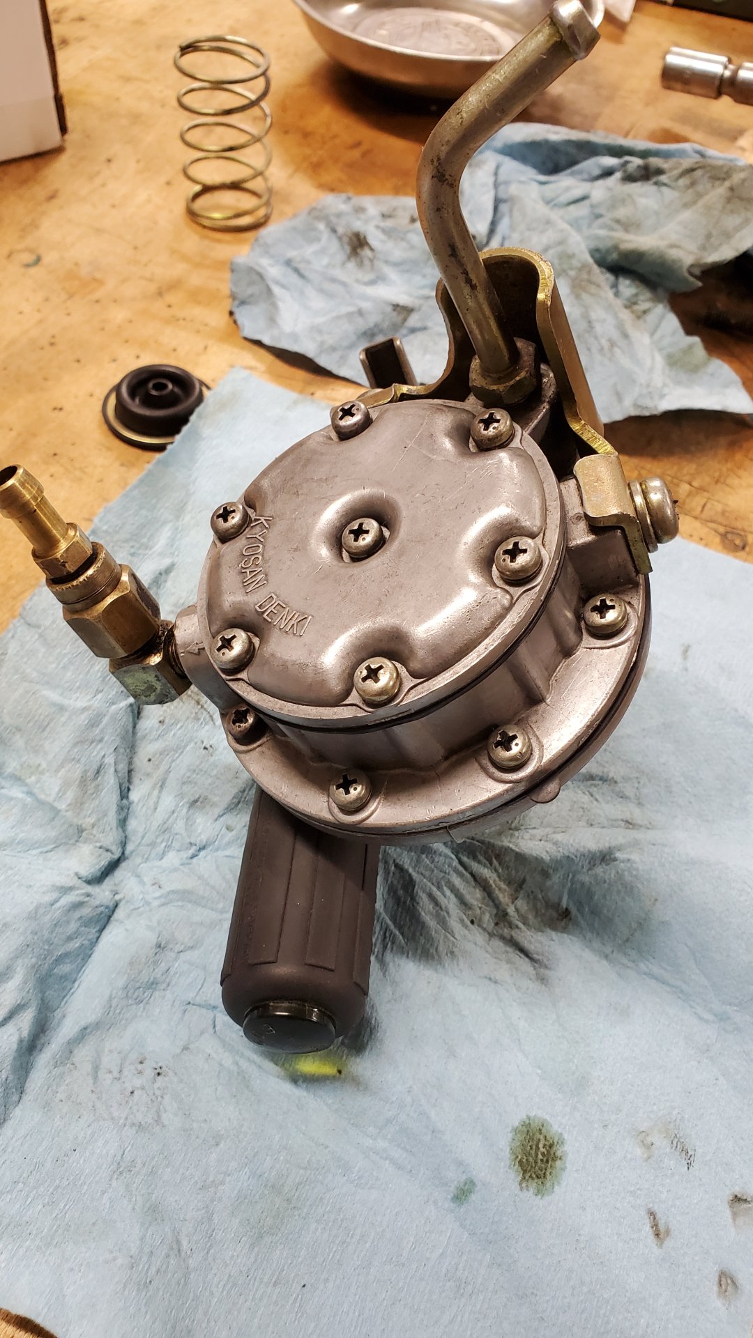

Received a rebuild kit for my fuel pump from Cruiser Cult aka @red66toy today in the mail.
The only thing that I noticed that wouldn't quite fit was the spring for the pump arm, aside from that everything went together pretty well.
Overall it seems to be a pretty solid kit, the valves that come with the kit won't be used ony pump due to mine having the staked in valves. Aside from that it has everything necessary to do a complete repair.
thank you @red66toy I'd definitely make another purchase.

Maybe tomorrow I'll bolt the pump back to the engine, I need to get some new fuel hose from the pump to the hard lime heading to the carb on Monday.
View attachment 3147701View attachment 3147702
Thanks for the support! :cheers: Yeah we didn’t have the industrial purchasing power to have them tool a new spring for us. But thankfully all the critical and common wear and tear rebuild parts are on point.
I'm sure if in NEEDED the spring to work I could make it work. Just spreading the arm open a fuzz would allow it to fit.

I did manage to get the pump bolted back up to the engine this evening.
Good thing I double checked some things, I had the top 180 out.

Make sure you pay attention to the way that top cap screws on, it's baffled on the inside.
I was off by one screw hole the wrong way, even after I paid attention to it when I was assembling it.
I guess that one extra beer did it.
I spent about a half hour yesterday trying to fire it up, after thinking about it today I decided to pull the cap from the top of the fuel pump, sure enough I was off one hole.
Summbitch, well after I fixed that it fired right up, maybe I'll take it for a test drive soon.
