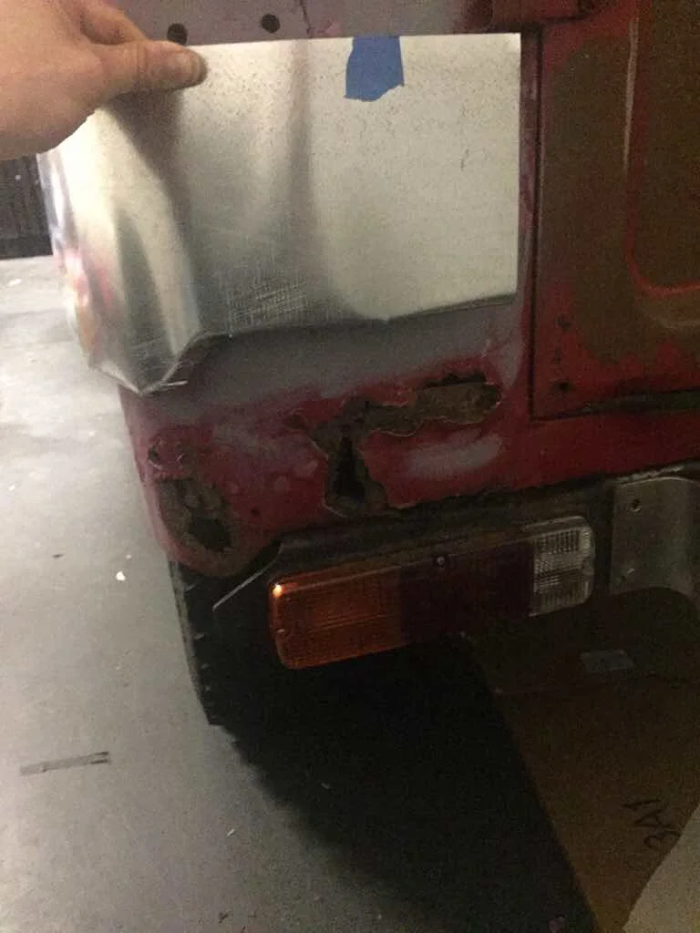

Here's my first practice run at fabbing up the rough shape... Still a work in progress.
As for tools and experience level, let's just say the first non-youtube exposure to any of these tools was by me on my first attempt! Total novice... Using all harbor freight tools( electric shears, 90amp welder, cutoff wheel, grinder etc)
1/4 Panel patch with limited tools

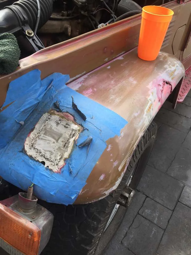

Here's my first usage of cutoff wheel, welder, grinder etc, decided to patch my fender under the tur signal bracket since it was nice and flat. I'm going to do some more flat spots before attempting the curved quarters.
Hope this helps with your courage, if I can do such a hackjob, surely you can! Git-r-dun-son!

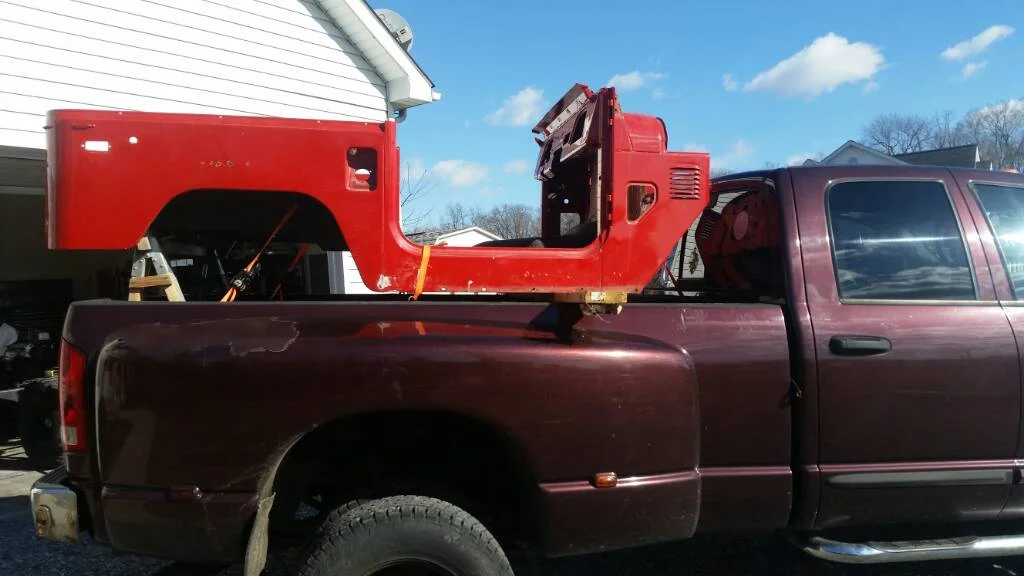

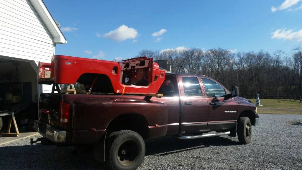

Loaded the body on the truck. Heading out to a shop to get a quote for blasting it down to bare metal.
Sometimes I have more brute than brain.
as a point of reference, I paid $300 to have mine blasted... it was $90/hr to have it done.
and in my experience, the best blasters are the ones that give you back the cleanest body. '40s are plenty thick enough (and braced enough) that heat isn't generally an issue (body panel warping) - but good grief are there a lot of places that sand can hide.
They run $75 an hour shop rate, I agreed to bring it back after I clean the rest of the bedliner off. That and the massive amounts of bondo around the door sills.

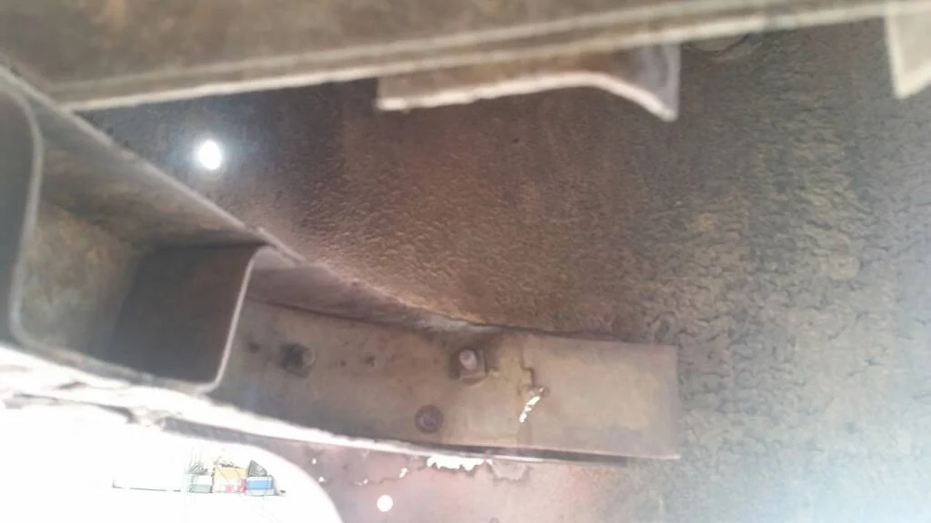

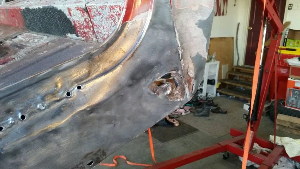

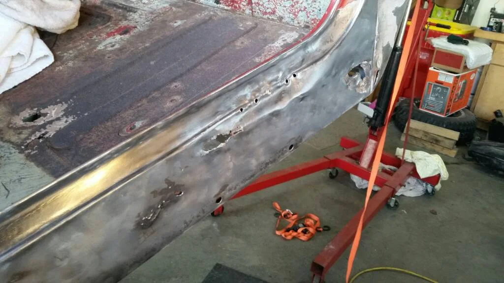

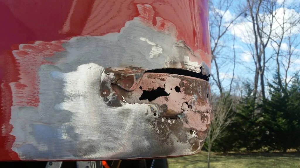

Cleaning the bottom off.
Something is not right about that last pic.
so does "whoops" cover it, or does it require a full-blown "whoopsie daisy"?

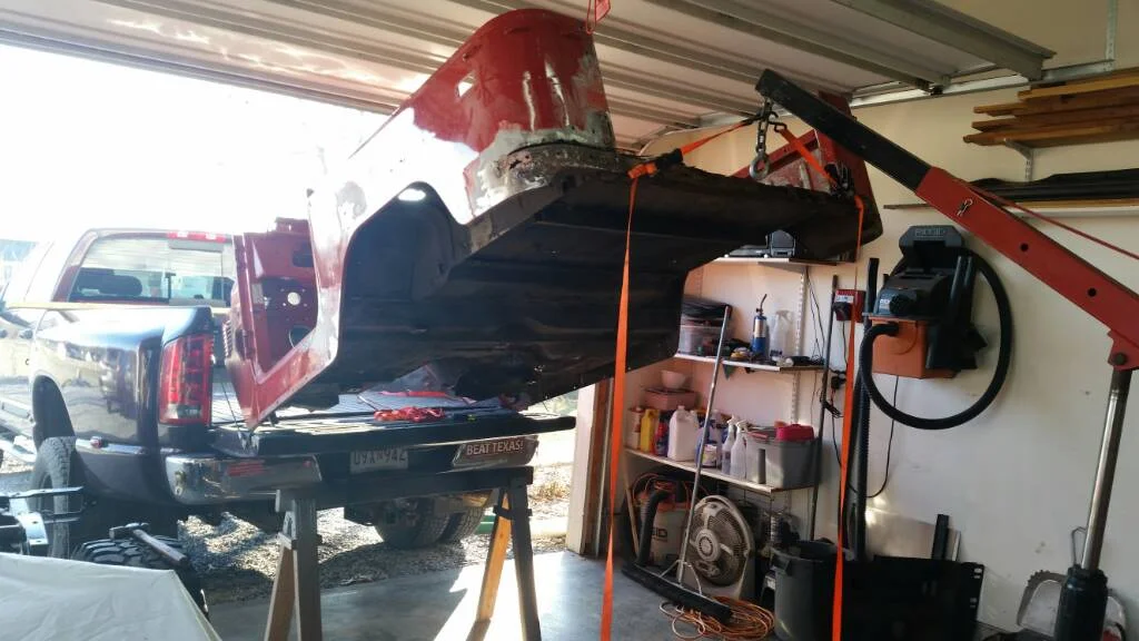

Basically what he explained to me was it would only take 2-3 hours to clean the tub. With the layers of bedliner and bondo on it it would take longer to clean it, @$75hr. As it was he estimated it would take 6-8 hours.
I am only going to clean the liner off the inside areas, it looks like the underside has been deteriorated enough over time it should come off with the blasting. One side has been cleaned of the bondo.
And I don't have many options locally for blasting.
