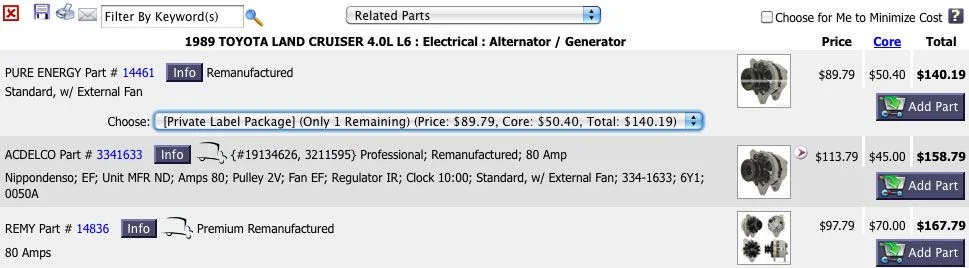

From RockAuto on 1/8/2015

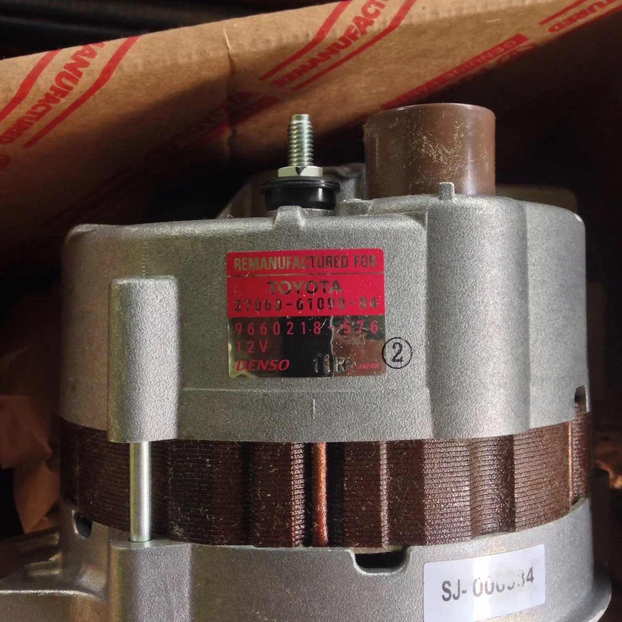

Yes, there's plenty of these Alt's out there, it's just the OEM (Denso) remans are drying up, if that makes any difference. However, some of the reboxed may be the ND reman's. Dunno. The Denso boxed say they're reman'd in Japan, but who knows...
Probably reman'd here in the USA,
Denso in Maryville, Tennessee
:meh:

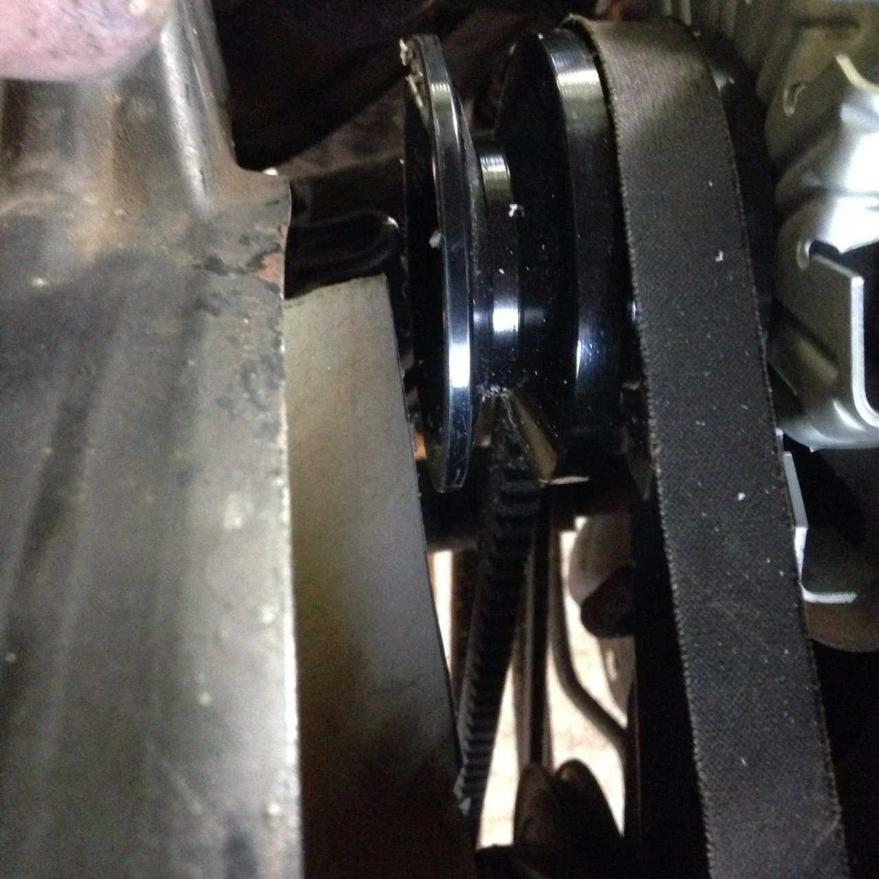

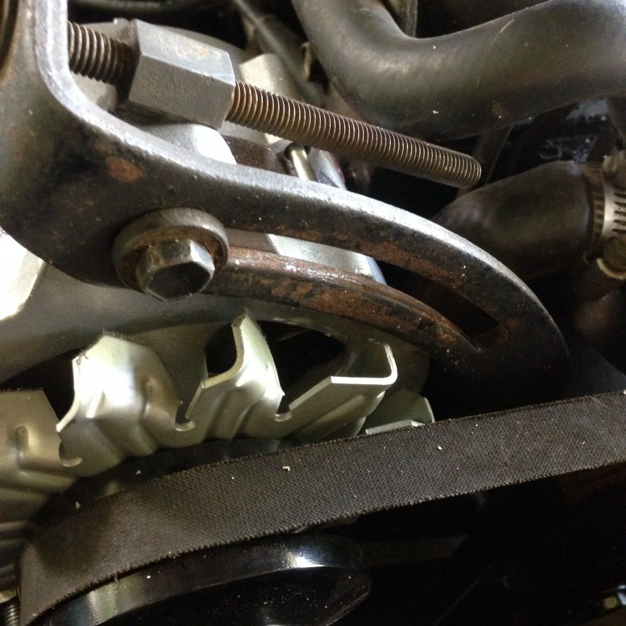

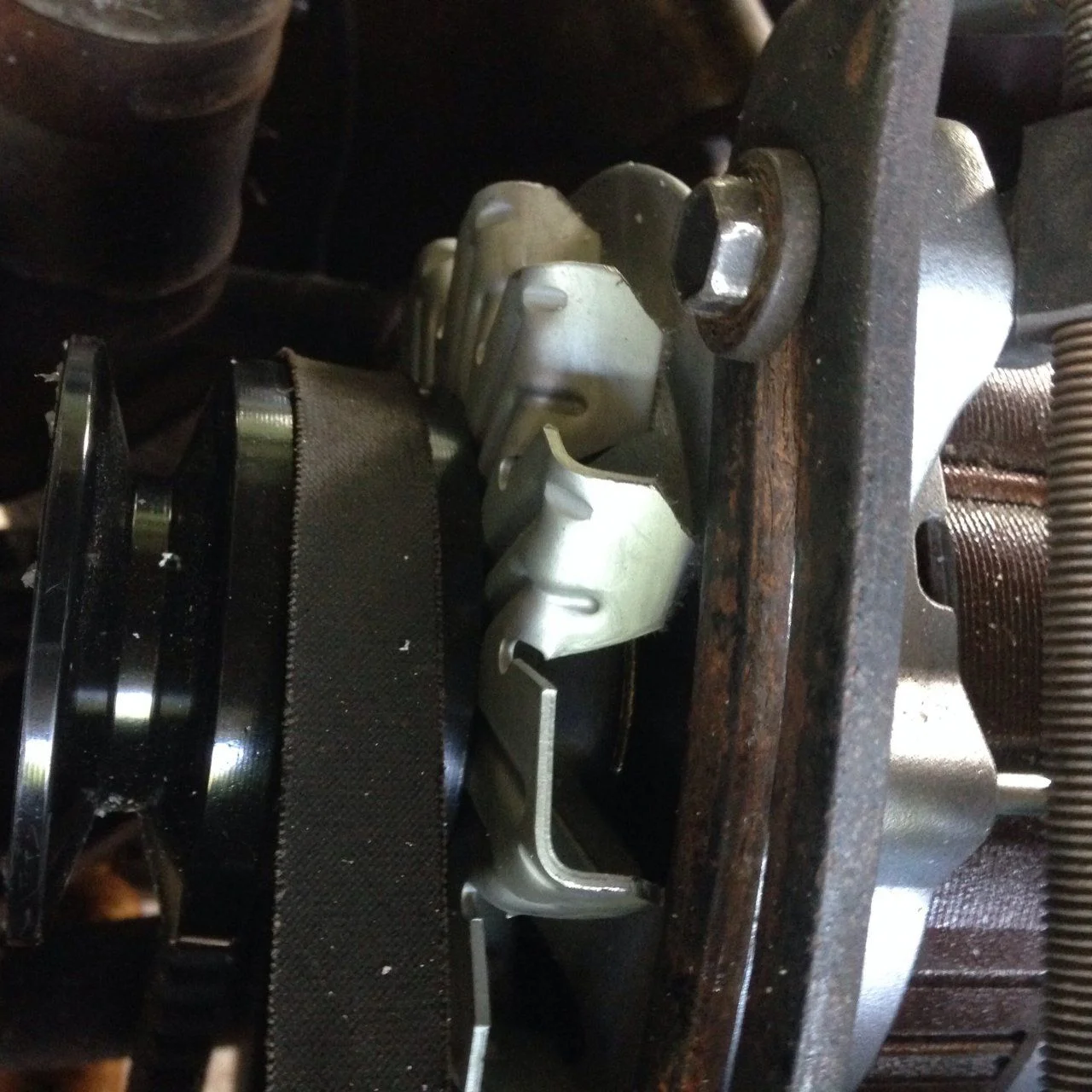

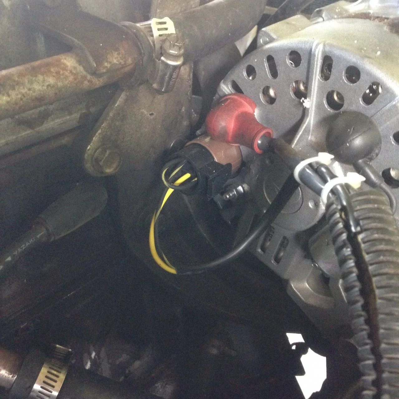

Man I love it. I had to cut of a corner of the alt fan, and the rad fan. Just mark it pulled it off and cut it. Done. It's nice to have the buzzer gone and the damn parking brake light bleed over. And of course coolerman's adaptor plug. Simple as pie
You need a shorter belt. Your belt looks loose and you appear to be out of adjustment room.
John
Nope and nope. Belt us plenty tight and I still have at least 5 rotations on the adjustment. If it does run out I can always extend the adjustment on the bracket
