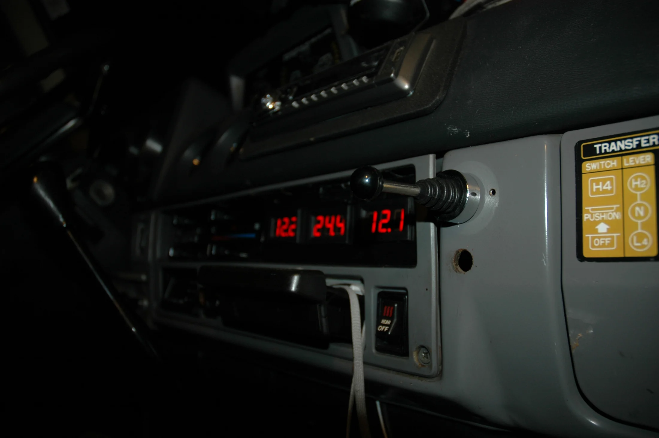

I hooked up a regular hand held volt meter to the winch battery and mounted it in the cab so I could see the exact voltage during winching and resting. When the batt voltage dropped to a certain level I would stop winching and let the batt recharge & winch cool down.

So when in use it drops to or below 12v (per battery, so 24v) and I rather leave the engine running but the alternator is a new old stock 25 amp so that thing does not do much.
