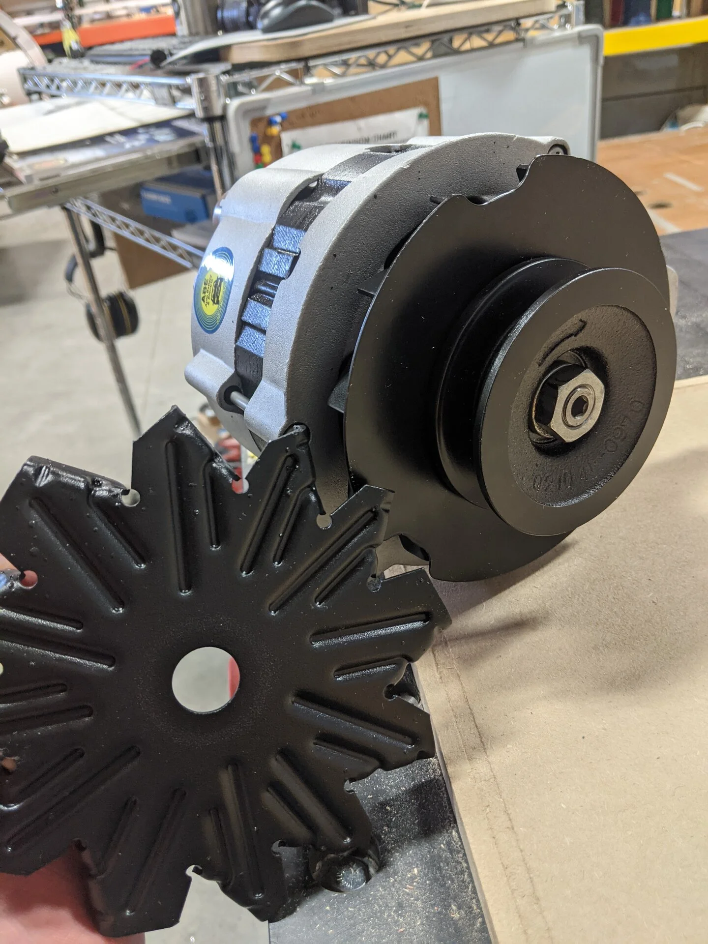

Hey y'all, poppin' in to follow up on the swapping of the FJ60 alternator fan onto the FJ62/80 alternator. Have a rebuilt FJ62 alt and my old fan from my FJ60 alt and was recommended not to do the fan swap. Has anyone who swapped fans had any issues at all after running that set-up for awhile? Seems like an easier route than grinding, welding, or cutting but I'm new to auto electrical and don't want to fry my newly rebuilt alt. Thanks for sharing your experience with the fan swap in advance!
Photo of FJ62 alt (80-90amp) fan in hand (on left) and FJ60 alt (55-60amp) fan placed on FJ62 altHey y'all, poppin' in to follow up on the swapping of the FJ60 alternator fan onto the FJ62/80 alternator. Have a rebuilt FJ62 alt and my old fan from my FJ60 alt and was recommended not to do the fan swap. Has anyone who swapped fans had any issues at all after running that set-up for awhile? Seems like an easier route than grinding, welding, or cutting but I'm new to auto electrical and don't want to fry my newly rebuilt alt. Thanks for sharing your experience with the fan swap in advance!
Thanks for the quick reply. It is slightly smaller but it brings air in the same direction. Size difference might be key here?FJ60 fan is too small ?
it draws / forces air in wrong direction .....

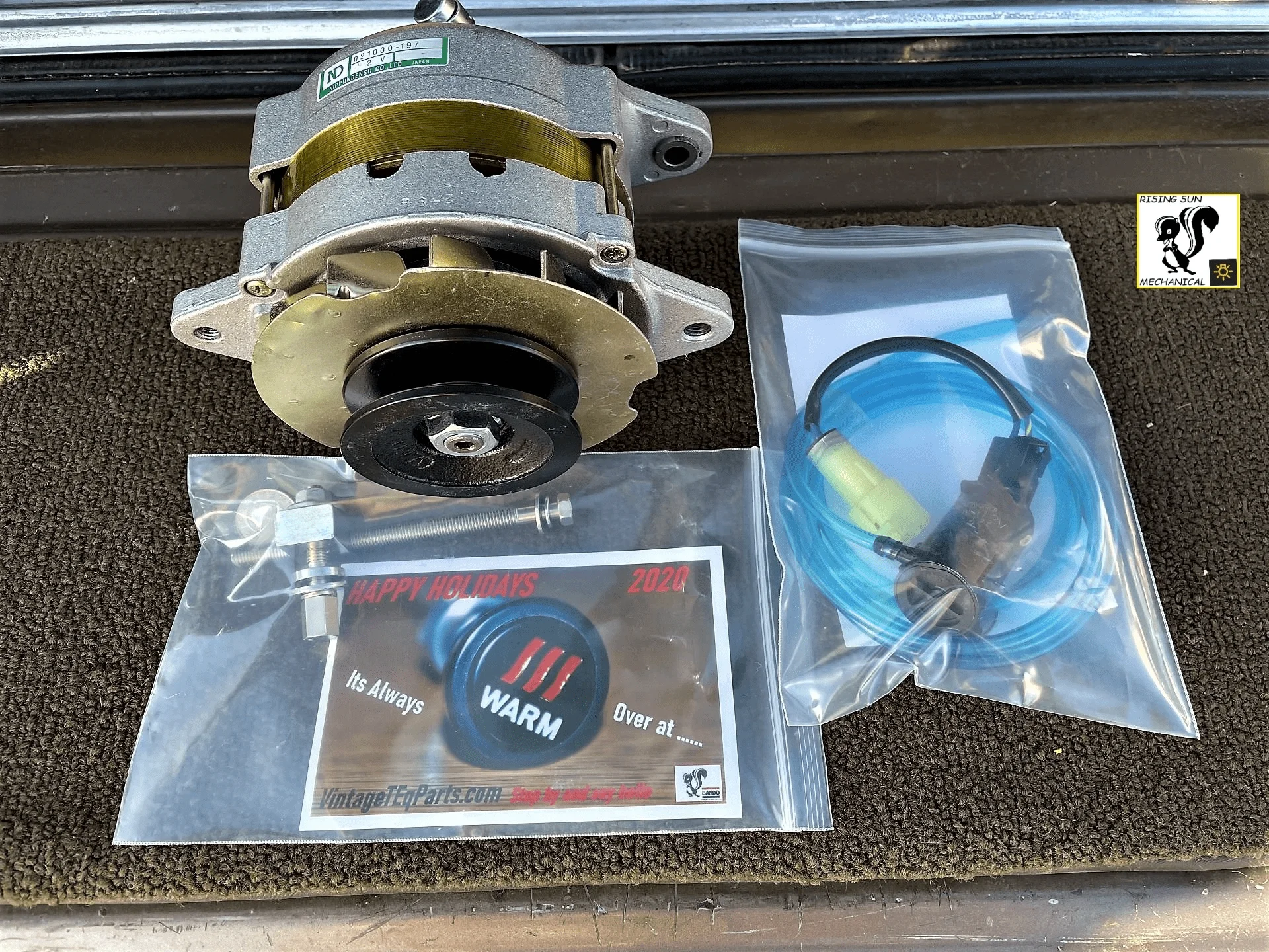

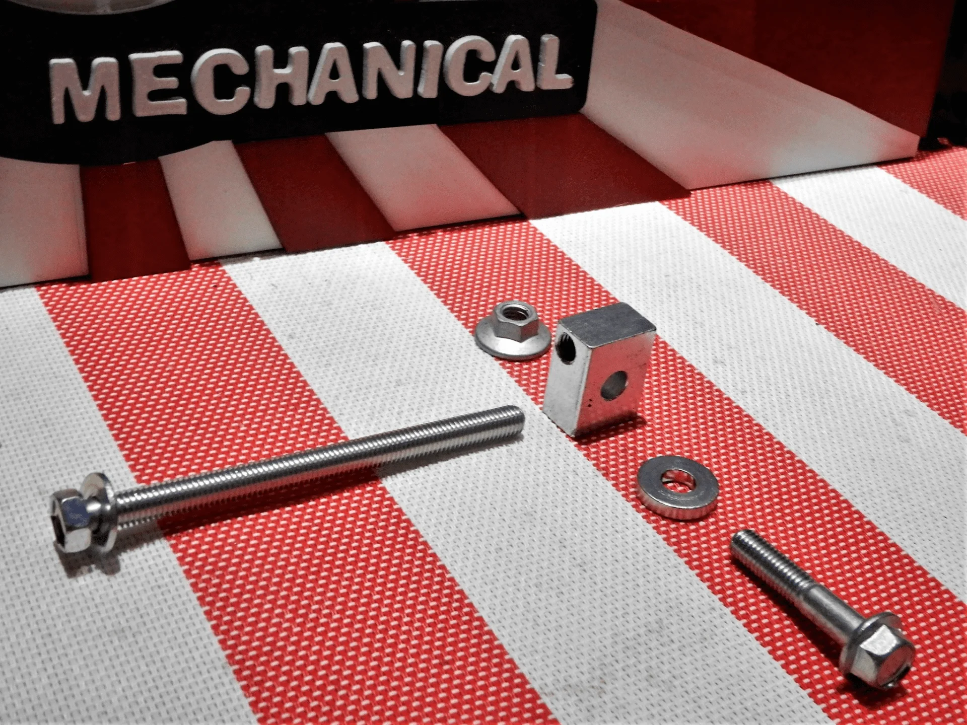

My current belt is 1575mm, so I'm going to bet you're overshooting a little haha.Maybe contact ToyotaMatt for a SS Adjuster Bar to accommodate the 80 amp alternator and keep your 17mm belt. It also gives full adjustment which is limited with the stock bar and the 80 amp alt and the longer belt (I think it's 5640 mm ? I have to double-check). I haven't installed mine yet, but here's a pic:
View attachment 4089770View attachment 4089772

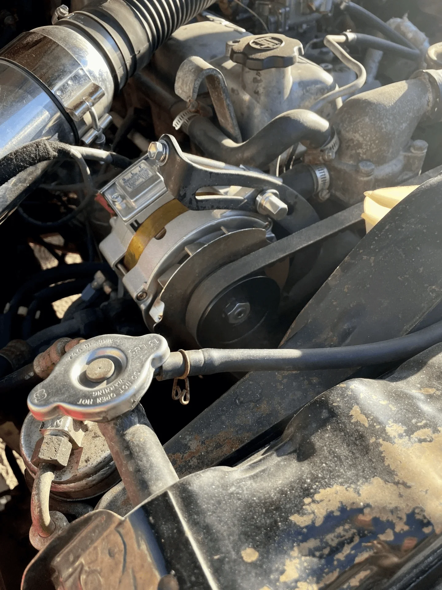

I am running the Saginaw steering pump and the 80 amp Pure Energy Alt on my 83 60. I’am using this belt.I’m mid-process in doing this. I ordered the Remy from Rock Auto, they sent me the correct box but with the 1FZ 90A alternator. Sent that back and ordered one of the other ones that showed a Denso core - Pure Energy 14461. Got the correct 80A alternator but it’s not a Denso. Looks like a newly manufactured generic unit. Maybe the Denso cores have dried up.
Notes:
1. The mounting ears for the lower bracket are spaced perfectly. There’s about 0.5mm of wiggle, but that goes away when the long bolt is tightened.
2. The plug on the alternator body is different and in the box was an adapter to go from that to the 80 Series connector. I got the adapter harness from @Coolerman (really nicely built!), but I have to use the provided adapter as well since Mark’s adapter doesn’t fit into the alternator - two adapters in a row! I’m actually just going to repin Mark’s thing into the plug that goes into the alternator.
2. I had to trim the fan blades like @NookShneer (I think it was you that did that a few pages back Dave) so they didn’t hit the bracket. I really don’t want to mess with changing the bracket and getting too involved with the fitment. No turnbuckle bolts or other craziness like we’ve seen in this thread. Side note: the fan from the 60 alt doesn’t fit, I tried.
3. The alt came with the double row pulley. I tried putting the 60 alt pulley on the new alt, but it’s too thick and doesn’t leave enough threads for the nut. The double row would need chopped in half as seen above except…
4. I had a smaller pulley laying around that the local old-school alternator repair shop gave me a couple years ago. It’s a smaller diameter one the guy let me have so I could squeeze more low rpm juice out of my 60 alt. It fit the new alt perfectly and left enough threads for the nut. I guess I’ll have more juice, plus more at low rpm now. Hopefully the faster internal rotation doesn’t overheat the alternator at high rpm.
5. In order to use the stock adjuster bracket, I need a smaller belt. I have the Saginaw steering pump with the skinny pulley (I really wish we could find a stock-width pulley for that) and a Gates 1575mm belt. I guess I’ll try their 1525mm belt to start and go from there. Anybody have advice on belt length for this operation with a Saginaw steering pump?

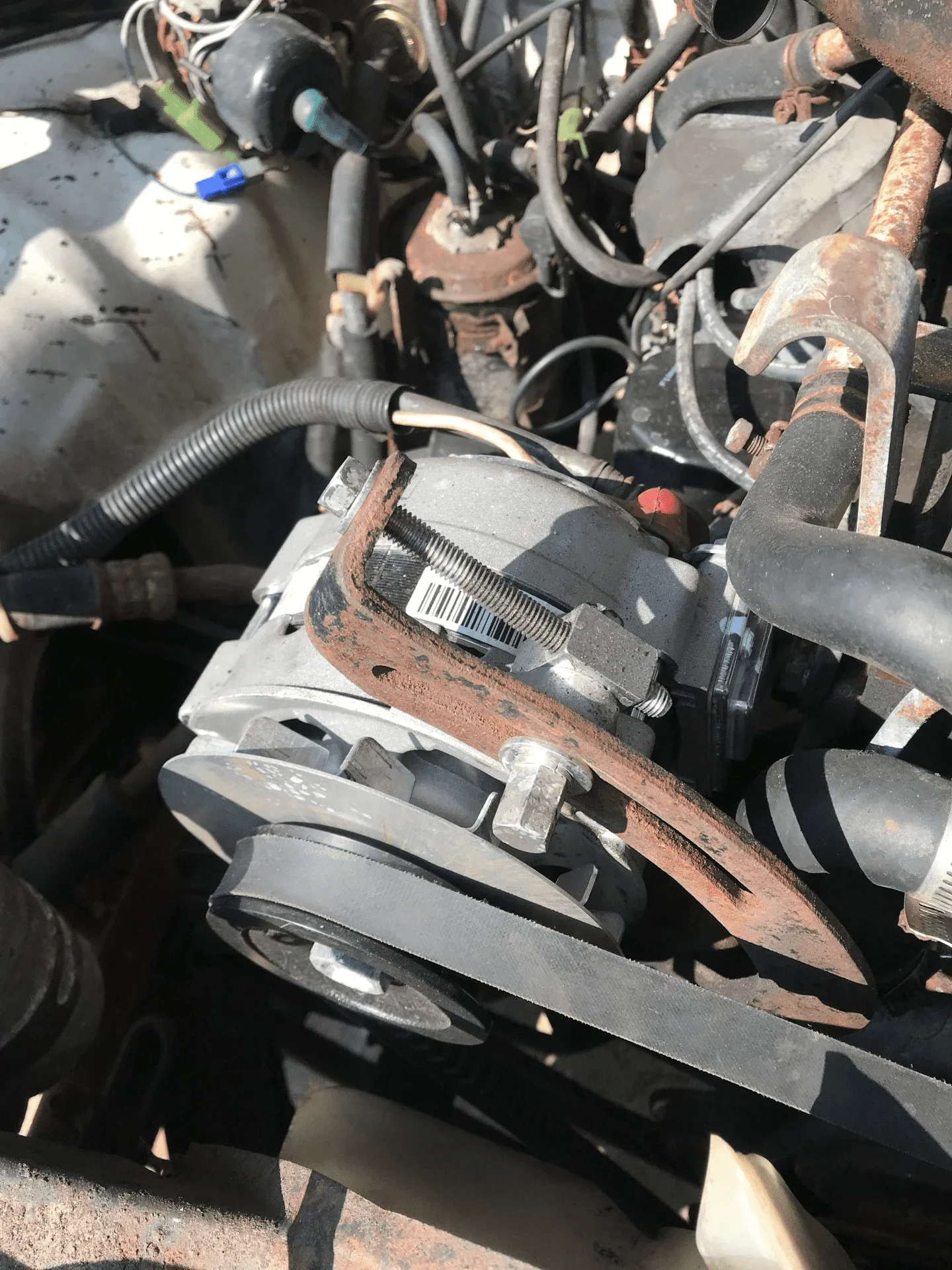

Here is picture of what I have left for adjustment with the stock bracket.
Not a lot but it leaves a bit left over.
