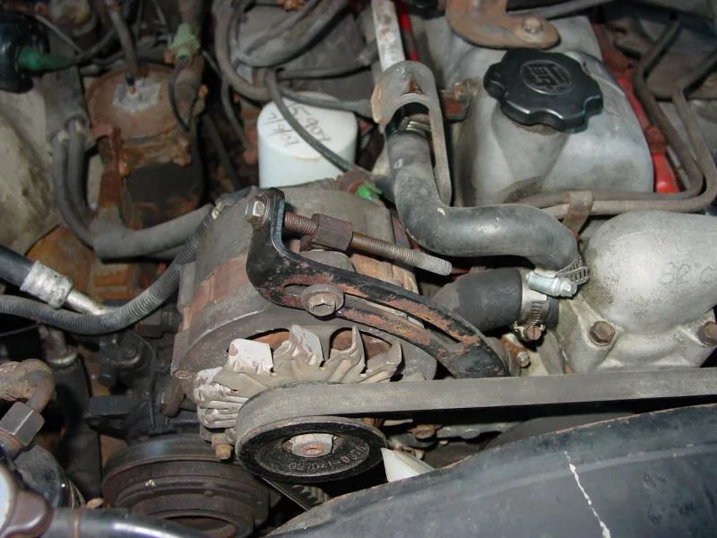

First pic is the 3FE alt in the stock 2F cradle w/ a stock 2F adjust arm and a stock, but worn OEM Mitsuboshi belt. If a new OEM belt was used, there would be even more room on the adjuster.
Note that the alt fan is smaller than either the 3FE or late 2F. It came off a 75-78 cruiser alt that was kicking around the floor. The bigger fans would hit the adjuster arm.

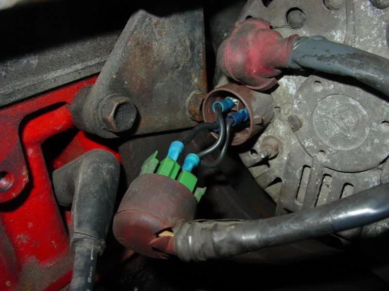

Second pic is my backyard "adapter harness".
2 wires from the FJ60 harness become 3 wires into the FJ80 alternator.
Ran into the tension bracket hitting the alternator fan last night. Jim -That is a good solution to the problem:cheers:. I was already to modify the bracket. I'll try finding a FJ40 alternator fan instead.

I'm tired of looking at the hokey adapter wire on my FJ60 w/ FJ80 alternator. It works great, but the crimpapalooza doesn't look like it's up to Cruiser quality standards.

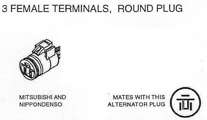

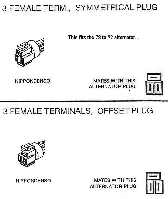

Jim, You may have fixed this a while back, but I may have found a place to get the Toyota alternator connectors. See the two attached pic and tell me which one of the three connectors shown (if any) fits that alternator. I have verified that the three pin connector at the top of the first image fits the 78 to ?? alternators and have these in stock.

I ordered the 3FE connectors this morning. I will send Jim C. one to verify it is the correct connector for a 3FE alternator.
For the adapter mentioned in the post above, If the connector I ordered is the correct connector, I can make the adapter Jim shows but use the 3FE connector on one end easily.

OK I sent the connector to Jim yesterday for him to verify it is the correct connector. If it is, I will put them on my web site for purchase. I can make the adapter Jim shows above using the 3FE connector and plug in spade terminals or can supply the terminals and you can make it yourself.
Just a note: the terminals the 3FE connector uses are the same as ALL FJ40/6x alternator terminals. Simple matter to remove the wires from your existing plug, plug in one as it is, then use the supplied terminals to make the jumper as Jim shows. I'll work out the details and pricing later. ;)

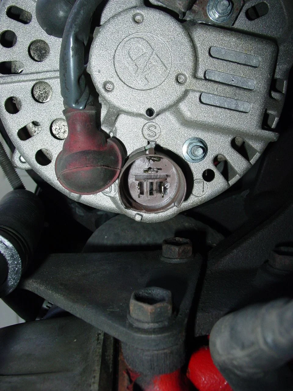

Yes, thank you! Received the connector shell and the 3 pigtails.
I was not planning on making an adapter, because that would require the connector shell that would replicate the back of the 2F alternator.
My plan was simply:
  1. chop off the 2F connector
  2. slide the boot up the wire
  3. butt-splice the two 3F wires to the one 2F sense wire
  4. butt-splice the L wire together
  5. snap wired terminals into housing
  6. slide boot sorta into place
  7. plug in connector.
LMK if that is not an OK plan. I'll do this tomorrow afternoon, while it's still sorta warm out.
