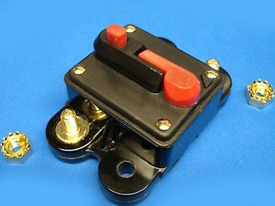

On one of my vehicles I have a circuit breaker that goes from the battery to all the vehicle electrical except the starter. If I have a problem I have it a location in which I can reach under the inner fenderwell and trip the breaker manually. Their are larger 12v circuit breakers that could handle the current of a starter as well. A big kill switch such as what race cars use could also work.
