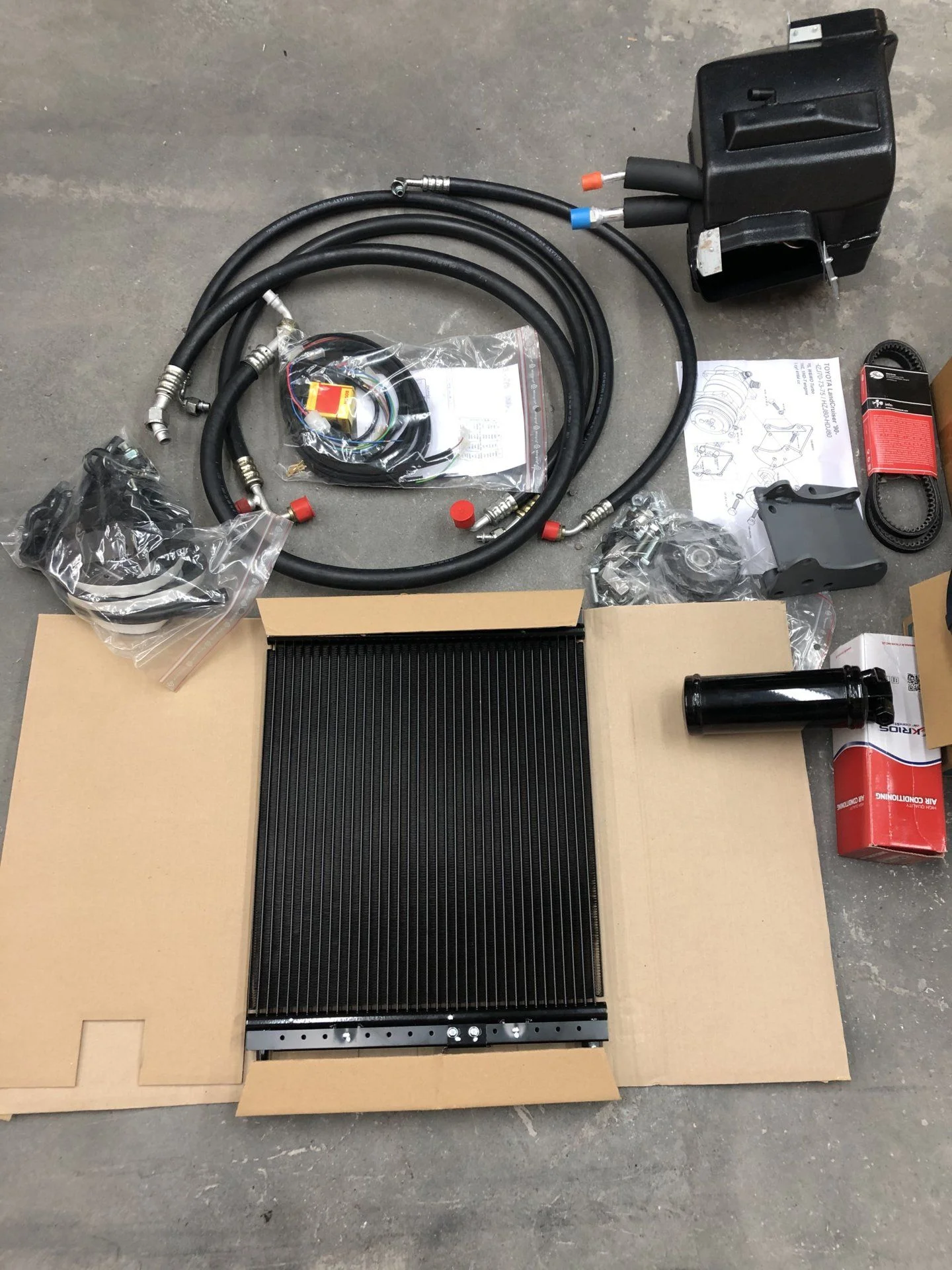

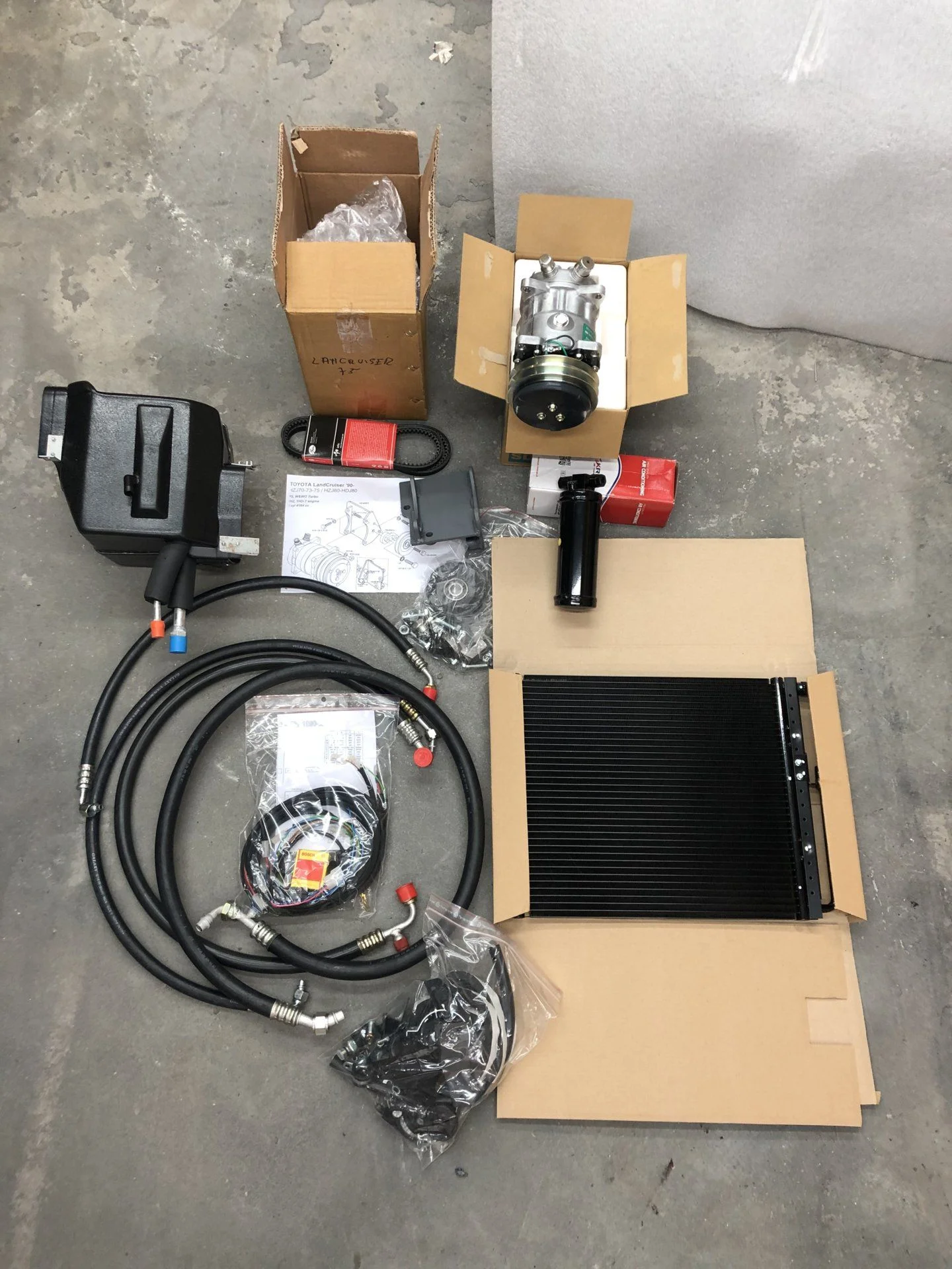

It blends completely in the stock interior as you remove the big empty plastic box right of the heater core and replace it with the aftermarket ac unit, the aftermarket on/off ac switch is about all that tells the system is not oem on the inside. I have owned a LJ70 with one of these kits a lifetime ago but never installed one ( or any other ac system) yet.
here are some pics of one of the HZJ7x kits
