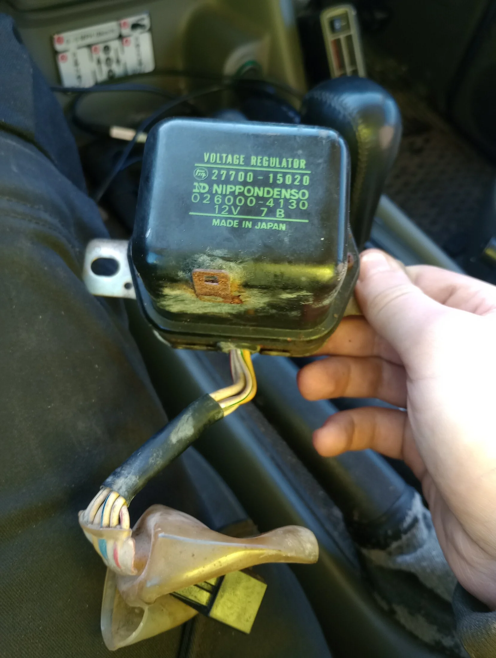

I'm pretty sure your alternator is externally regulated (I can't remember if you mentioned it). As you seem to be pretty competent with electrical circuits (certainly more than I am), I think you could grab any external voltage regulator from a 12V Toyota from the 80s or 90s if you can find one in a scrap yard.
Yup, external regulator. I'm not sure if I mentioned it either, should be evident from the pictures of the alternator though. Scrapyard is a great idea, hopefully I have time to go visit one this week.
Went to the local scrapyards today. First one was closed, but the second one had a regulator off a Tercel. Cost me 20€. Now I just have to fix the dash as I accidentally burnt a wire while testing and then I'll hopefully have a working charging system.

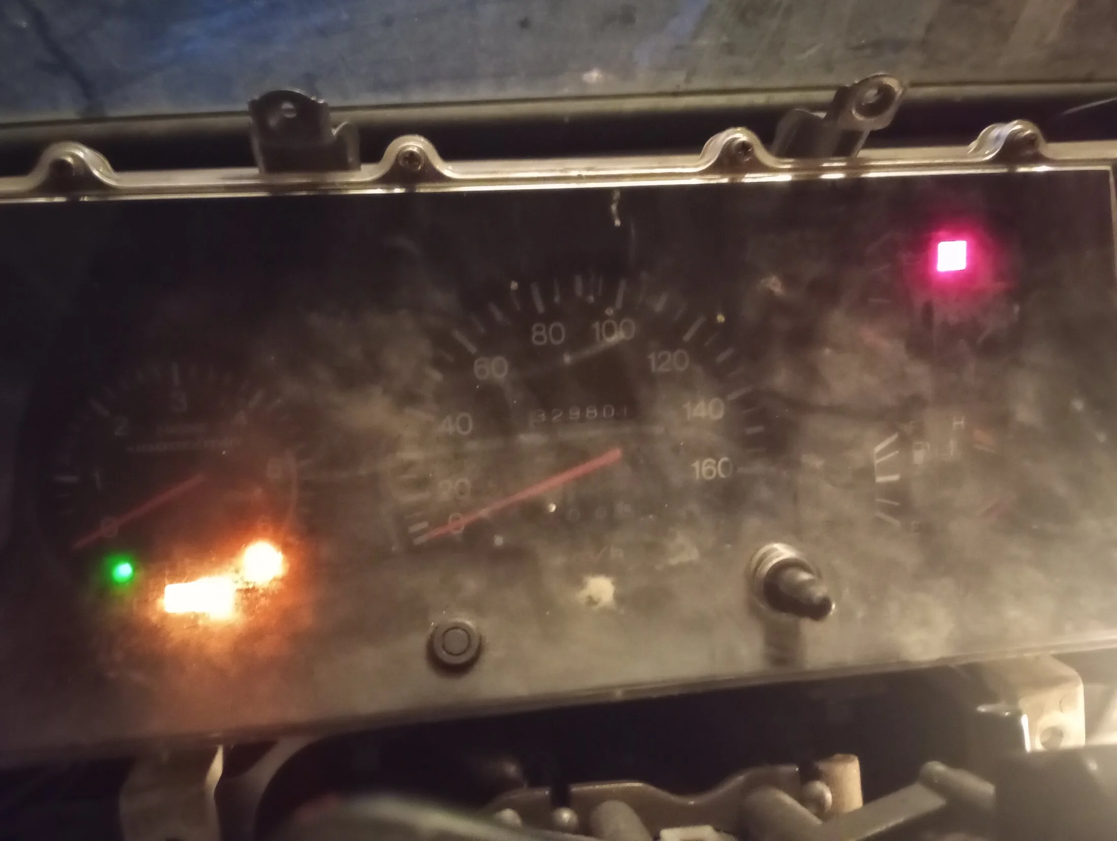

The new regulator seems to work. I haven't started it to see if it actually charges, but the dash lights up.
Is this plus the filter light next to the glow plug light everything that should come on?

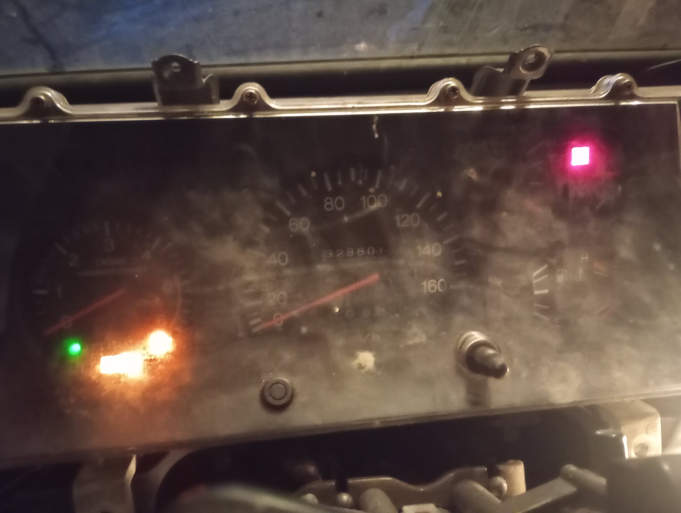

The new regulator seems to work. I haven't started it to see if it actually charges, but the dash lights up. View attachment 3866203

On my Hilux, there is a T BELT light, low oil level and the brake warning that come on. But I think the important thing now is that you have some lights on :)
