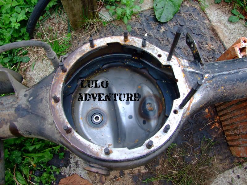

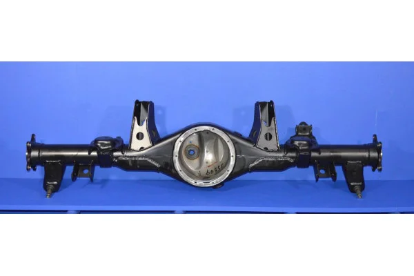

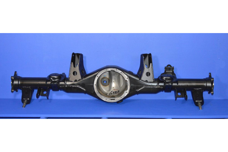

The diff wont just be drop in because the axle casing is cut away for the diff lock fork. But from my research this should be fairly easy to recreate using a gasket as a template.
As far as I know it’s only the R&P that “might” not swap over, so either a spacer or aftermarket R&P will be needed. But again this isn’t my first hand experience.
I haven’t had to pull the diff out of my LJ78 yet, but once I eventually have I will compare the R&P with the Hilux locker I have.
I knew I'd have to modify the axle housing slightly, thanks for the pictures though. They make it very clear.

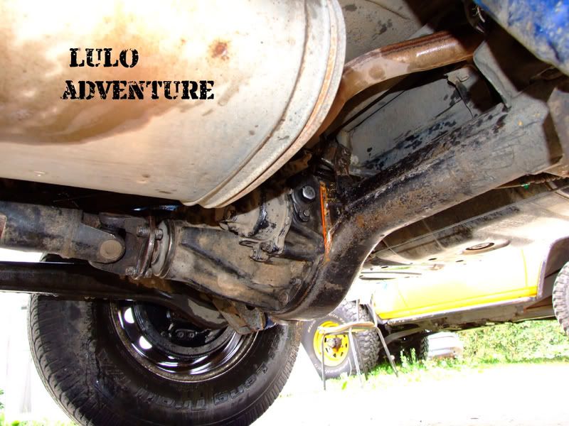

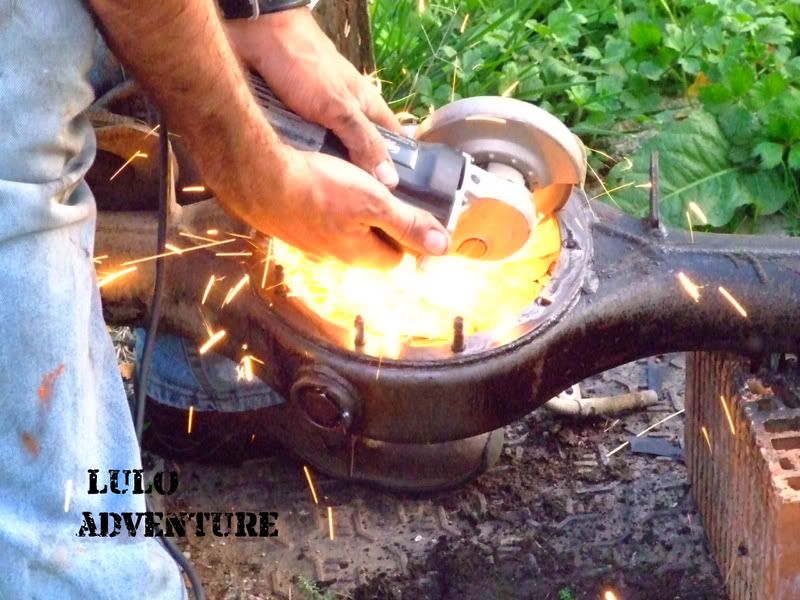

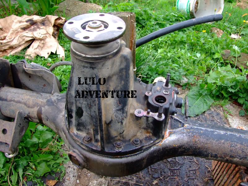

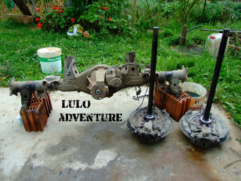

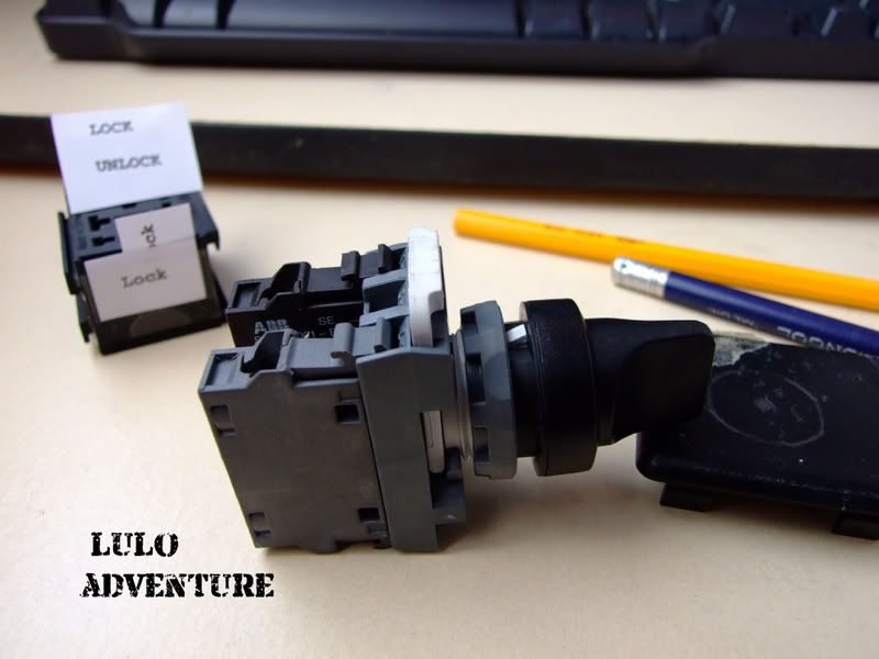

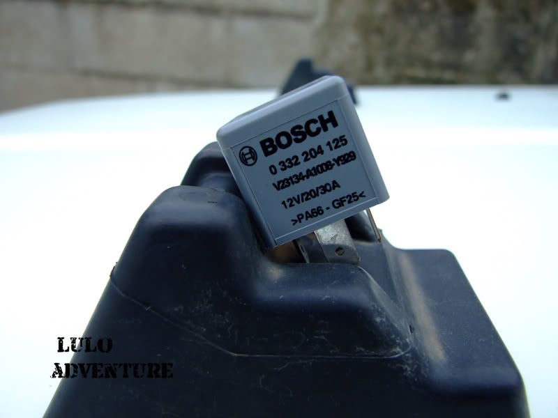

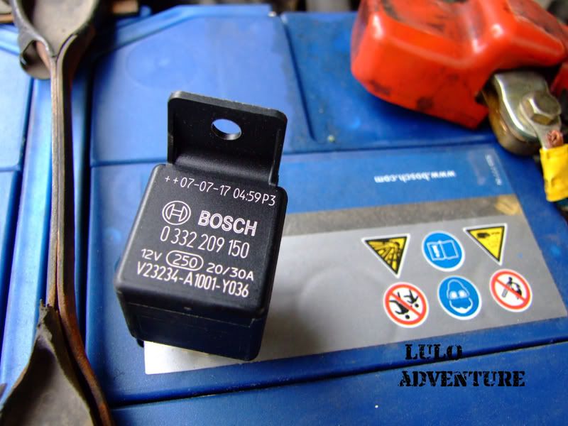

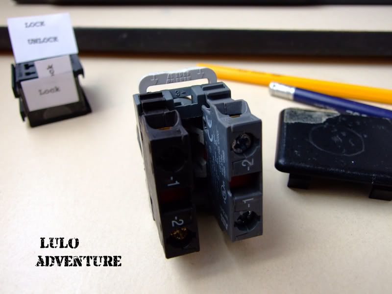

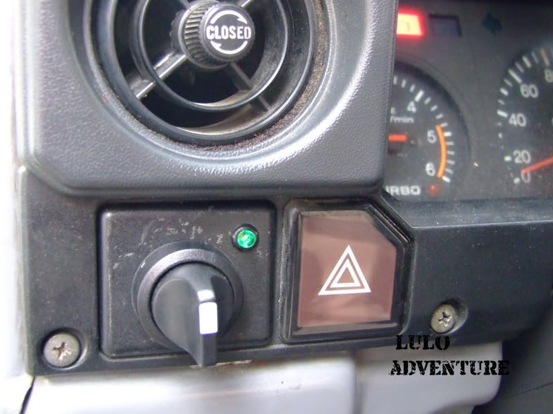

15 years ago with the BIG help of my cousin, we installed the Rear Diff E-Locker from a KZJ-90 in the Rear Axle of my ex-LJ/KZJ-70 in Spain, sorry but I don't have many photos of the process.

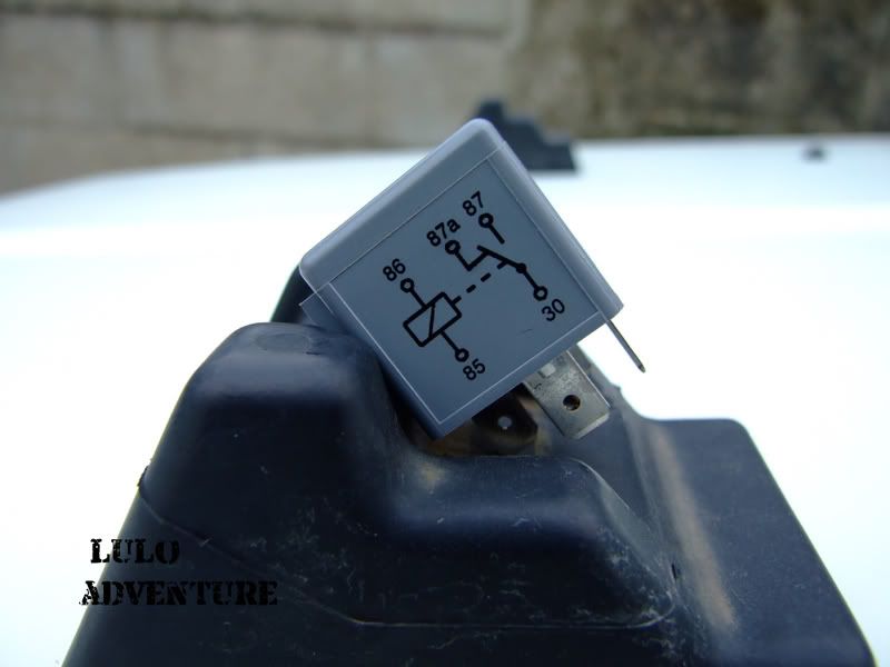

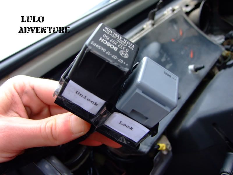

The Relays to activate/desactivate the Locker:
If you have any question, I try to help you ok, but that modification was done long time ago, and maybe I cannot remember everything, but it is possible to do, and in my case, the e-locker did work always perfect without problems.
Good luck and i will see your work.
Good evening from the Swiss Alps,
