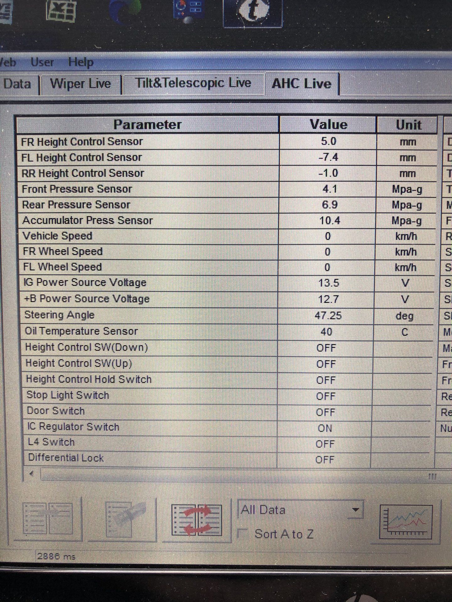

Before adjusting tbars or replacing fluid, etc. I'd say adjust the sensors so the hub center to bumper distance are factory and the sensors don't disagree that much. That'll give you new pressure readings & reveal if you have a bad sensor or two. If the height is set correctly and the sensors are reading correctly only then go further with other things. Just my $0.02
Hey everyone, I recently had my mechanic reindex my t-bars and this was the outcome when I checked the pressure levels....
Update: the Toyota Regional Master Tech was in the shop same time as me/my Cruiser. After having a look he recommended going back with a solution that bypasses the AHC. There are several rusty parts that look impossible to open/repair. In his words, "it's a can of worms you don't want to open."
