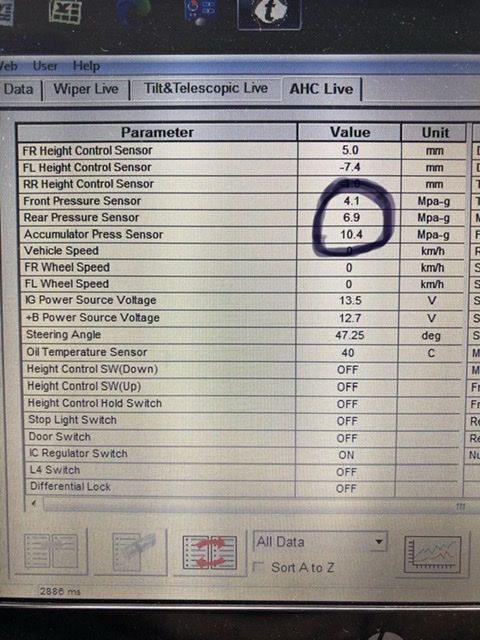

@LndXrsr @97 AZ LC Thank you for your help! I went ahead and adjusted both sides equally. I did 8 clockwise turns on the PS and counterclockwise on the DS. The front end evened out completely. Right now I am at just shy of 19.5" on both sides. So probably need to adjust the height sensors now. Pressure is back at the 6.0 mark upfront, which is still a bit low. I ran out of daylight and called it good. Drives much better already!

Does the vehicle need to be running to do the T-bar adjustments... or off?
What do you mean?
For turning the adjuster bolts, it doesn't matter if its off or on or upside down.
For measuring the left/right lean it doesn't matter if it's running or not.
For measuring the AHC neutral pressure, it has to be running.
Anytime you're physically adjusting something, the car should be off for safety. As uHu mentions above, measuring pressures or checking the results of adjustments to the AHC sensors (changing ride height) needs to be done with the car running.

It is a bit confusing because you do two things at once when you tighten/loosen the T-bars with the vehicle not running/off:
1 - Adjust side to side level.
2 - Adjust AHC pressures
To check AHC pressures, on Techstream, you must then turn the vehicle on/start engine.
Right?

My approach here is to level side to side with the vehicle turned off. The AHC system can suddenly self level and could put you in danger. Once you have the cross leveling dialed in, you can check pressures with the truck on. Keep in mind you must check them after going from N-->L-->N
