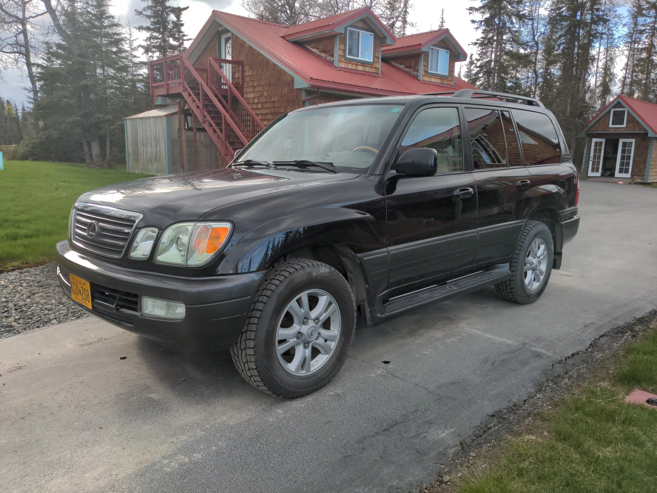

Looking at picture. LX looks like ACH in high. It also lack rake (front lower than rear).
If ACH actually in "N". Likely a poor sensor lift was done. Which may have way to much pressure in rear. Which can result in leaks. Can aslo blow a globe.
Thanks for the replies. I will check my graduations when I get a chance. It seems like probably a globe issue. The system functions fine and the ride isn't awful but not as smooth as I expected. This was a one owner vehicle, an old couple, so I doubt it was sensor lifted. But maybe poorly adjusted at some point. Definitely going to keep the system though.
