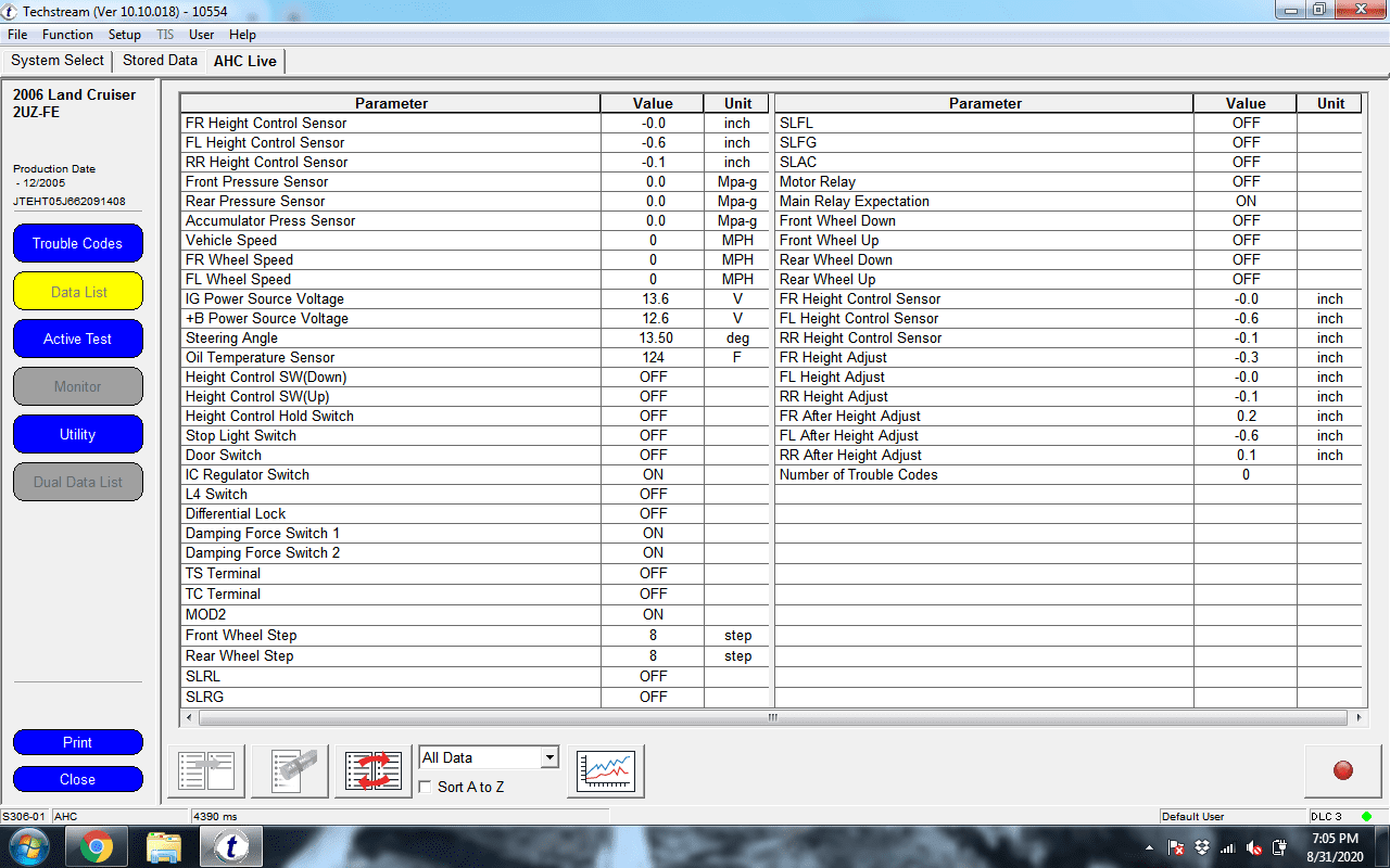

Alright fellow luxury AHC mudders!
Here is the sequence of events:
1: This was on immediate startup
2: This was going from N Height to Low
3: This was going from Low back to Neutral
4: This was going from Neutral to High
5: Now this is interesting. I did a full cycle from N to H, back to N, then to L and back to N and my pressure readings were much lower. I did a test drive and went over some speed bumps in my neighborhood and it went much smoother. No noise either! BUT the only time I can get this lower pressure is after I go from N to H, back to N, then to L and back to N. Once I go back to H from that point the pressure increases.
Another thing I noticed is my height sensors are not even! I do not have a code, but do you think one of these may not be good? Does anyone know what the factory spec is for height sensors at L-N-H?
THANKS EVERYONE!!!!!!!!!!!!!!!!!!!!!!!!
Your height sensors in front are about 0.5 inch off which does need some adjusting but they are very unlikely faulty. Pressures should only be measured in N after going N-->L--N. Pressures in H or N are not used for reference (they are presumed to be good if N pressure is good). Your N pressures look quite good really.

This is great! So it would seem my front pressure is slightly low actually and my FL sensor also shows a bit more low than the FR - Do you think if I adjust the torsion bars to get this in spec, that should help bring my pressure back into spec?

Yes, you need to most likely re-index your torsion bars. You are over 1mpa-g low. That's a LOT of cranking. Depending on how much thread you have on the TB adjustment bolt, you will most likely need to reindex. Should be 6.8-6.9 on the front. You can start by maybe cranking (counterclockwise to relieve tension on the TB) equally on both sides 4 full rotations, drive a few blocks to "settle" the system and remeasure. Your rear at 6.8 is on the high end of neutral pressure. Accumulator pressure at 10.3 is BARELY high (10.2 is the target), but no big deal or worry at all.
Agree with the above. 4-5 turns loosening both TB nuts euqally, then recheck to start. One full turn of a TB nut changes pressures about 0.2mpa is the typical math. Whether you need to reindex will really depend on how tight the TBs are cranked on the adjustment bolt. 4-5 turns on the nut isn't out of the question without reindexing if things are really tight currently, which is quite possible given that your pressures are actually low. Many run out of room tightening due to high pressures that worn out TBs can no longer compensate for.
Yup. The only time I've seen pressures that low is when people have put in LC torsion bars instead of LX/AHC torsion bars. More often you'll see front pressures in the 7.4-7.8 range which is worn out TBs that need to be tightened or re-indexed.

Just make equal adjustments for now. 1 full crank counterclockwise (loosen) on each side at a time until you've done probably 3 total. Then drive a few blocks to settle the system and then remeasure pressures. Most likely will need one more counterclockwise crank on each side after that. You'll only need to reindex if there isn't enough thread on the bolt to make the adjustments. Most of the time it impacts the top end only as people tend to overcrank the TBs to compensate for lack of spring....you've got the opposite issue...too much spring. You'll probably be fine.

Equal torsion bar adjustments won’t change your sensor readings, only pressures. Unequal ones typically don’t either. You will have to tweak the sensors to read as close to zero as possible but only after you fix your current pressures by loosening the TBs. usually sensors should read +/- 0.1 in. Read my ABCs post about how to adjust the sensor brackets. after that you’ll need to check your ride height in N to see if you’re level from side to side. If not, one TB will need tightening and the other lessening until you are level from side to side in the front. Then you can adjust both height sensors again to get the final ride height you want.
