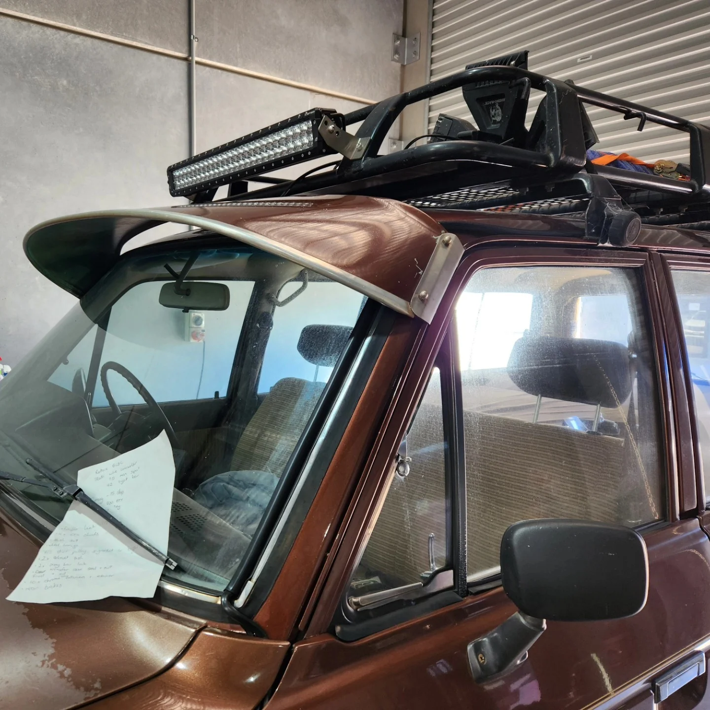

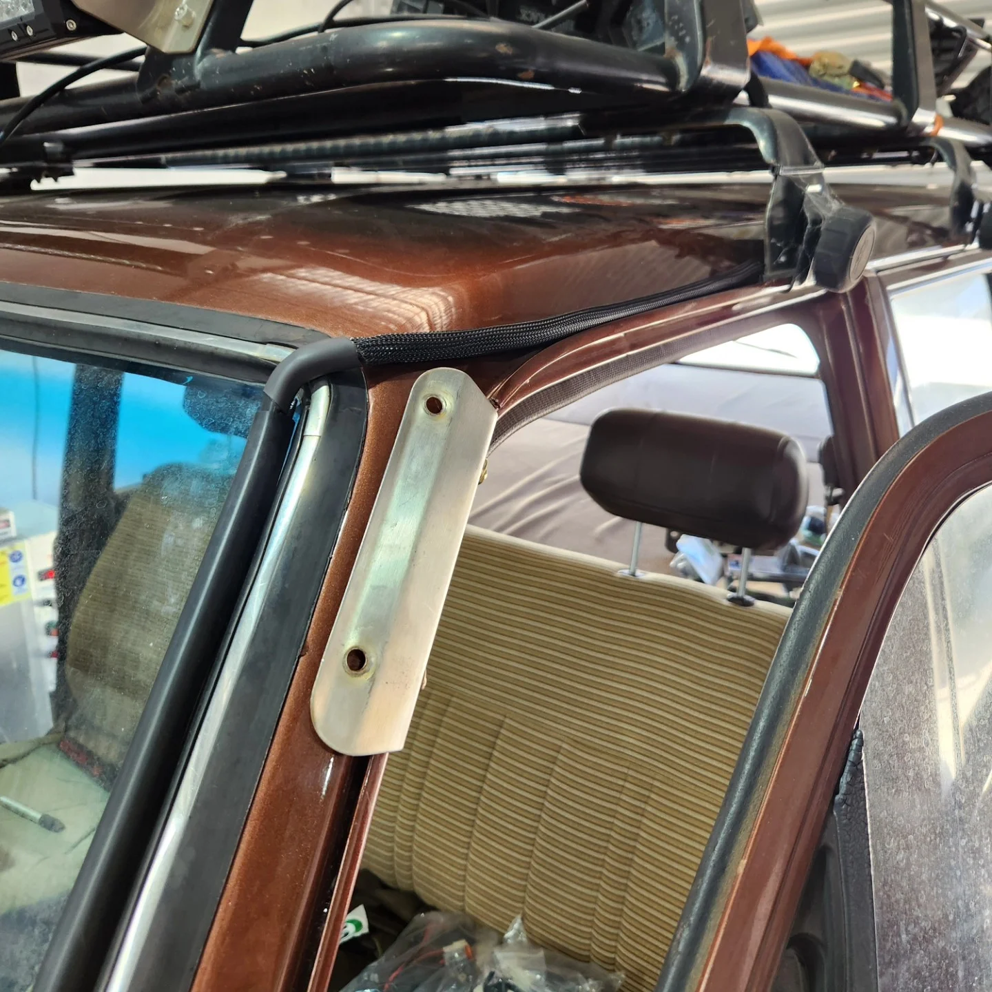

Horizon Early Landcruiser (Home - Horizon Early Landcruisers - https://helc.com.au/) here in Australia posted these two photos a while back.. unsure where he got this rubber duct from, but from a distance it blends into the window rubber nicely.. I've asked him what the product is, I'll report back.

I've done that side of the window thing using cord cover, from like Home Depot
it's quick and dirty, but painted black first it looks ok- just peel and stick it to the side of the windshield. It lasts about a year... directly proportional to how much ice you get and how often you scrape your windshield in the winter, etc. I have also run wires out the rear hatch and just not worried about water, and that has lasted years without issue but it doesn't rain inside the garage much.
