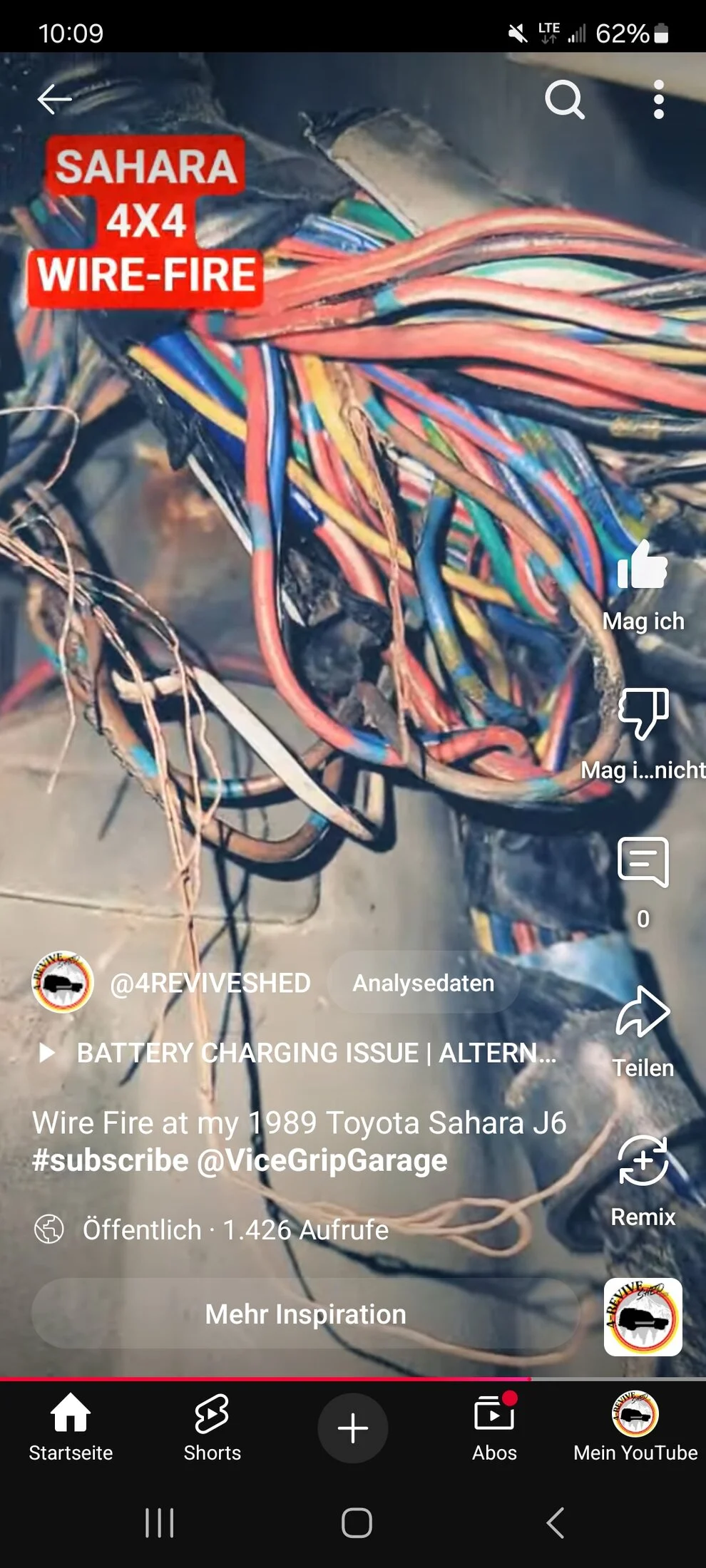

Folks, can someone stoo over the thread, who has also melted negative wires unfer the drivers kick pannel? Dont know why?
Thx a lot for your ideas.

Hey Folks, after not looking for weeks at the J6 i kind a pressure myself to dick in again.
I Have still following Problems:
- charging nearly 32V during 1800RPM [24V] System
- Filter and Charging Light lightning the whole time after starting the engine
- Radio not working
- emergency turn lights/hazzard not working
Kand find the cjarging light relay where it shouöd suposed to sit, Fuses checked and i dont have a proper wiring diagram. Maybe someone can help me out....
Appreceate folks
Greetings from Germany
I don’t know much about 24v system but what about the voltage regulator or coils the batteries have been charged wrong so they are putting out more than they are supposed to?
