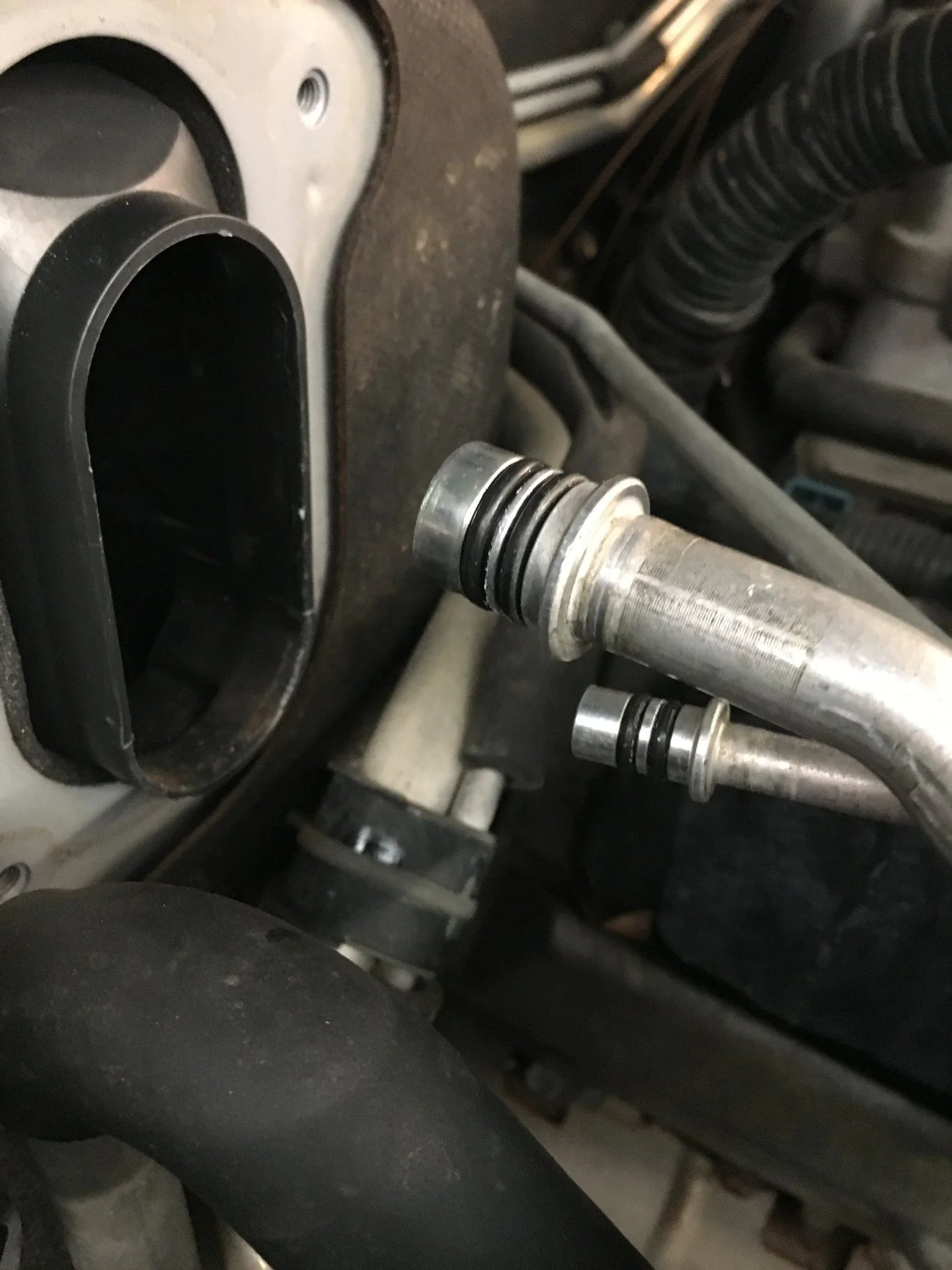

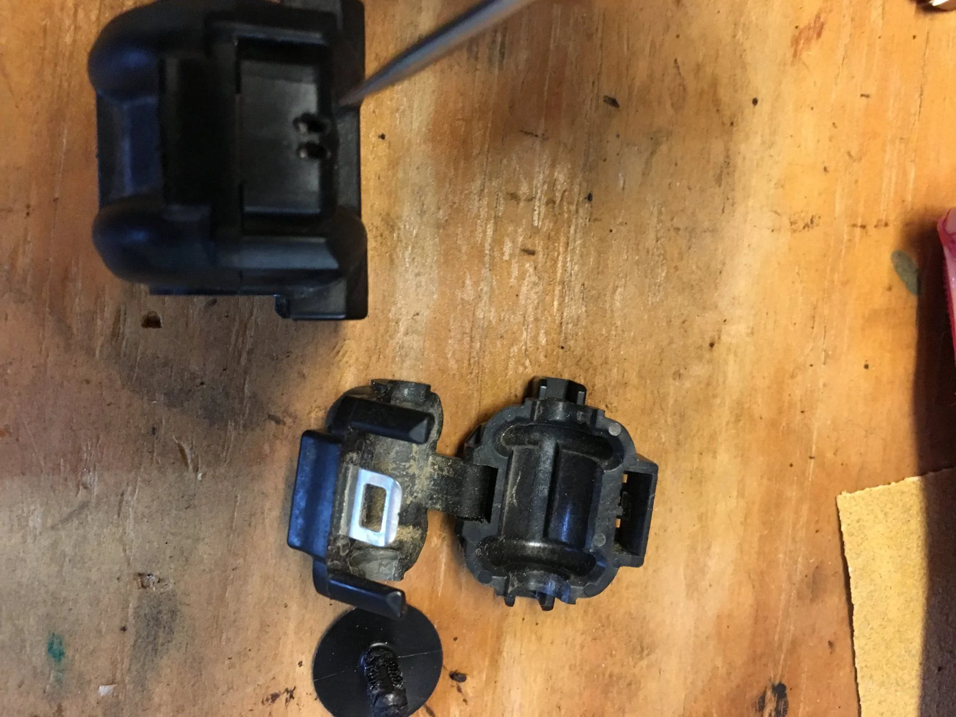

Here is where I’m at and I think it’s a stopping point as I don’t have parts yet.
I used a dart tip to pop the plastic off. Highly specialized tool of the trade. :)

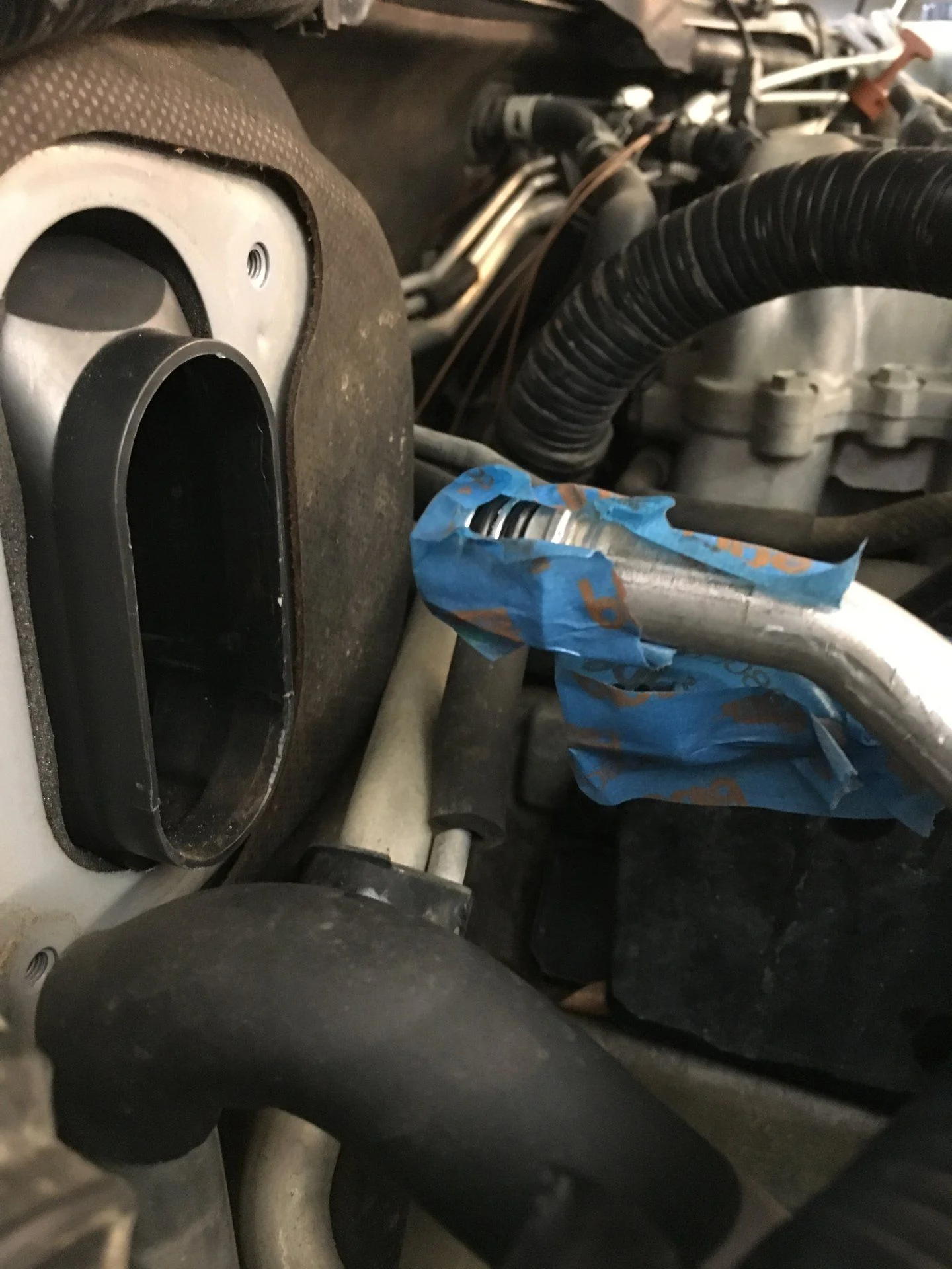

I covered the lines with tape to minimize contamination. Don’t know if that’s okay?

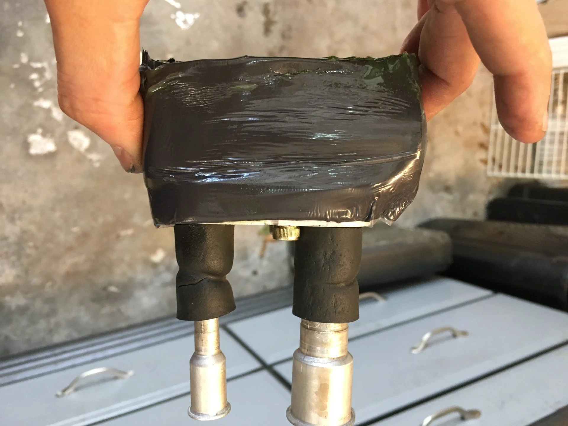

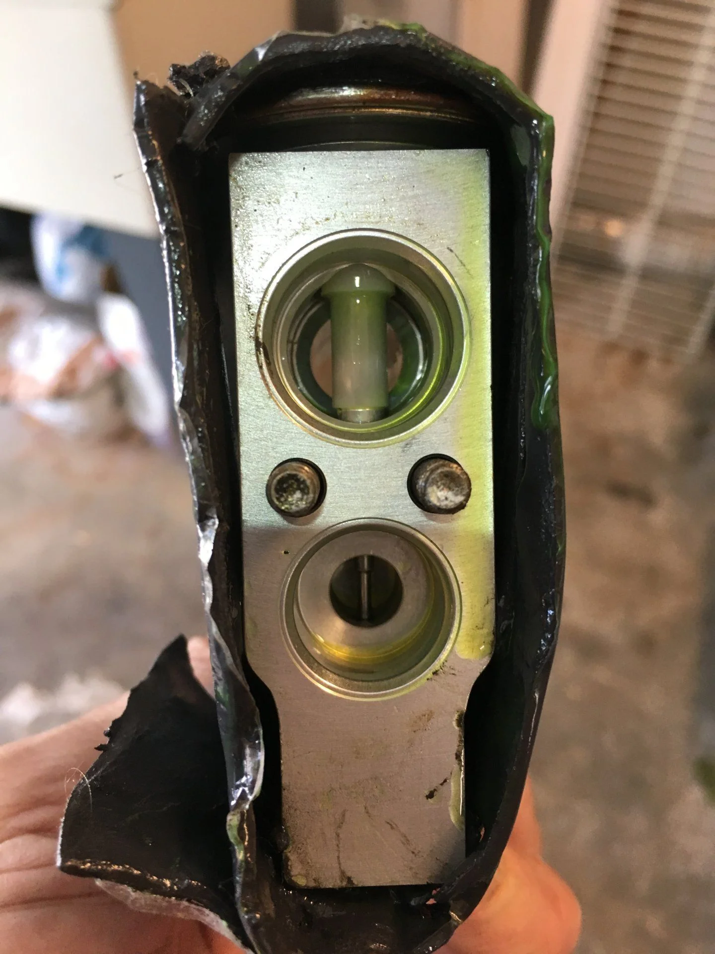

Does the Exp valve come with the rubber? Can’t remove it without destroying it. Do the parts come with O rings? Should I buy PAG oil? Do I need to add oil to system and how/where?
Lots of questions but I really dont know what I’m doing here. Appreciate the help!!
Buy the oring kit, it's like 5 bucks, parts may come with some but probably not all and you want to replace any oring you touch. No need to add pag oil. This is technically the cheap and dirty way to do this, to do it right you need to flush the system, replace all orings, etc, but what your are doing is what I did and I get reasonably cold air out of mine that has the original compressor with 350k miles on it.
Improvise, Adapt and Overcome. Good job.
Yes, perfect. We don't want anything foreign in the system.
Not likely. But you can buy Butyl Rubber tape at most home centers. You will need to seal that area back up so that rainwater/moisture/dust doesn't enter from the engine bay.

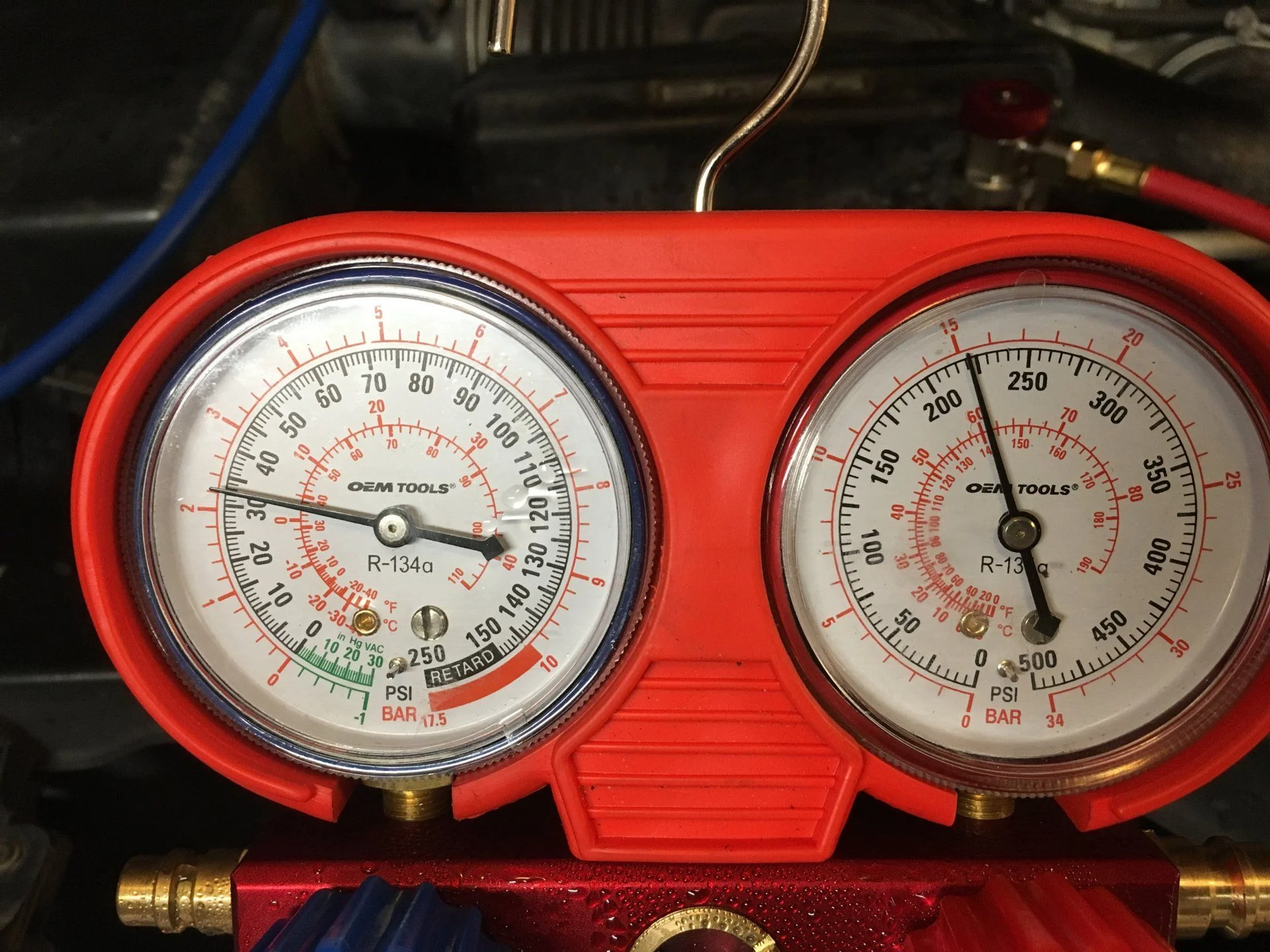

Well here’s the final result. It took 2.5 - 2.75 cans. More than anticipated. But these are the readings I have and look good. I added 2oz of oil and a cap of green dye for future reference.
Took it for a spin and it’s back to normal. It doesn’t seem to blow any colder than before but it’s the same and that’s fine with me.
The numbers are 35 and 225 respectively.
You may try like flint said and get a temp gauge and add a little or take a little out to fine tune it to get the coldest air. Glad it worked out.
