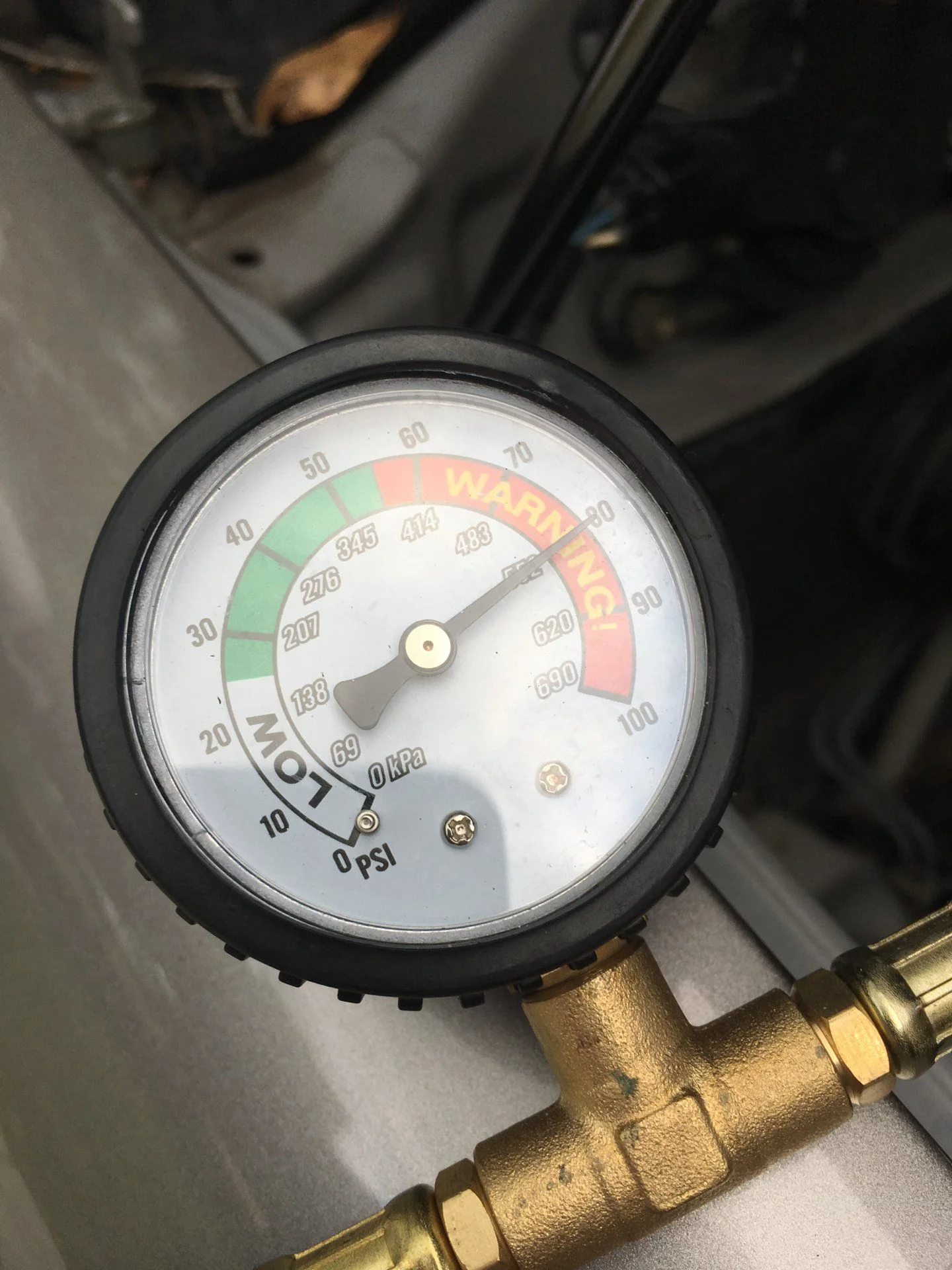

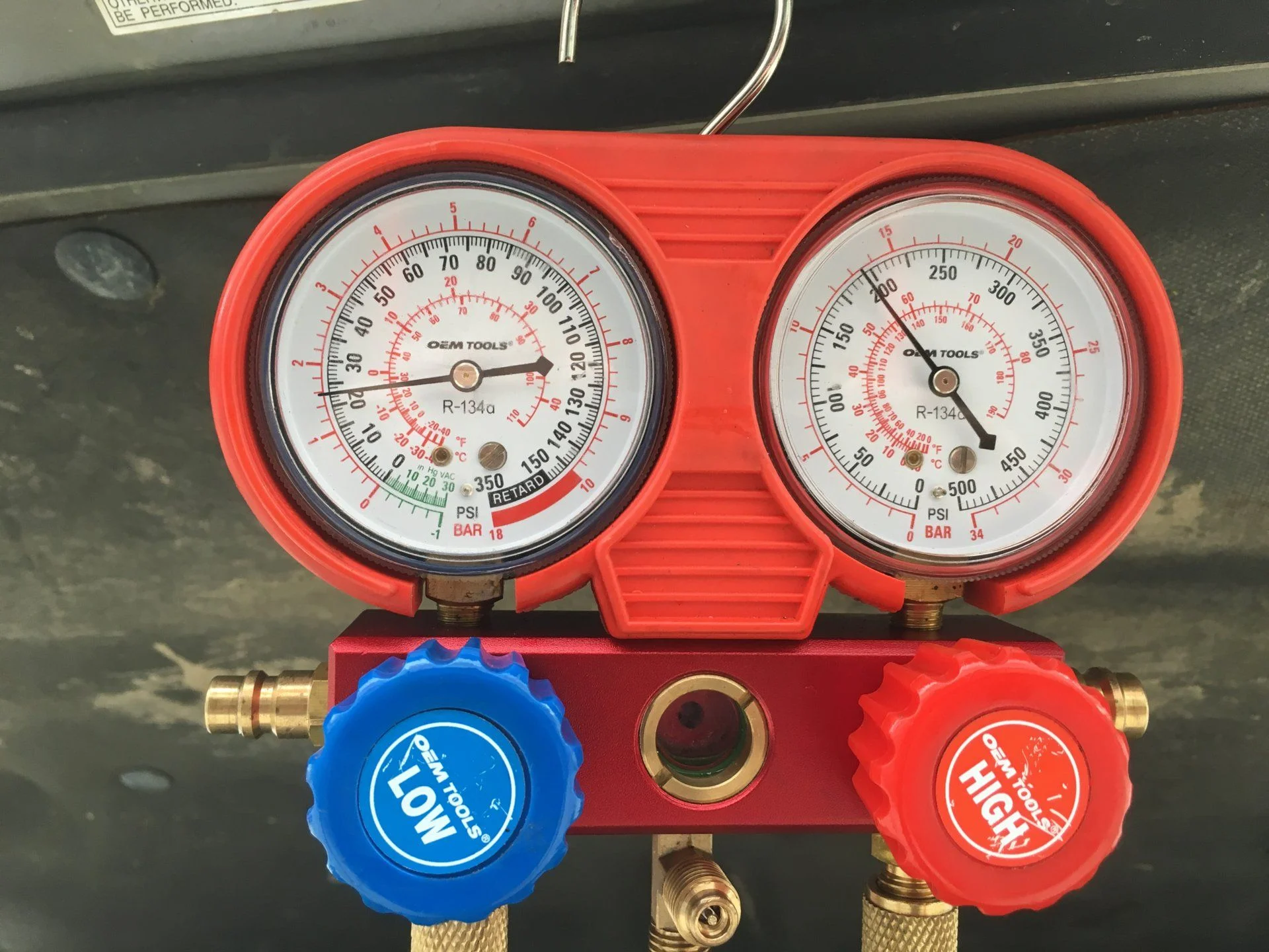

High pressure before AC on and Low pressure after AC on. It’s still blowing cold but it might still enough refrigerant to blow cold. During the original leak the refrigerant lasted two weeks before I had to refill. I’ll check again at end of week or report if it runs out prior.
What are those two pictures showing? 1st is actually on at low port? Second is high side after the system has rested overnight? Both sides should equalize so you can take that resting state reading from either side. What's the temperature outside? That will cause flutuations in your readings.Also, are you using the same gauge set? I'm not so sure about the accuracy of the readings on these things but I image they are somewhat repeatable. If you are using two different sets that could be your cause. Do you park this in a garage?
First is AC blowing high.
Yes.
This is showing just LOA side. Im using a guage from one of those refil kits. It may be inaccurate.
Temp was pretty high today. 96 leaving work, 91 at home when i took the reading.
No. Im using a guage from one of those refil kits. It may be inaccurate.
No, its parked outside.
Ill take another reading in a few days and see where we are.
oh no i thought u found the leak
you need to take two measurements with the same gauge in close to the same ambient temp before the engine heats up. Heat from the engine will make the numbers higher and really hard to do a controlled test with variable engine temps. Now if you take a resting reading at say 90 psi and the ambient temp is 80 deg outside, then another reading 2 weeks later and its 85 psi and its 90 outside, then i would say yeah, you have a leak. Its really hard to compare these numbers after the fact while the engine is running/hot and without controlling the ambient air temp. Thats why you draw the vacuum down and hold it for a couple hours to give you that piece of mind, which I thought you right? Unless you have new leak, I would say you are good.

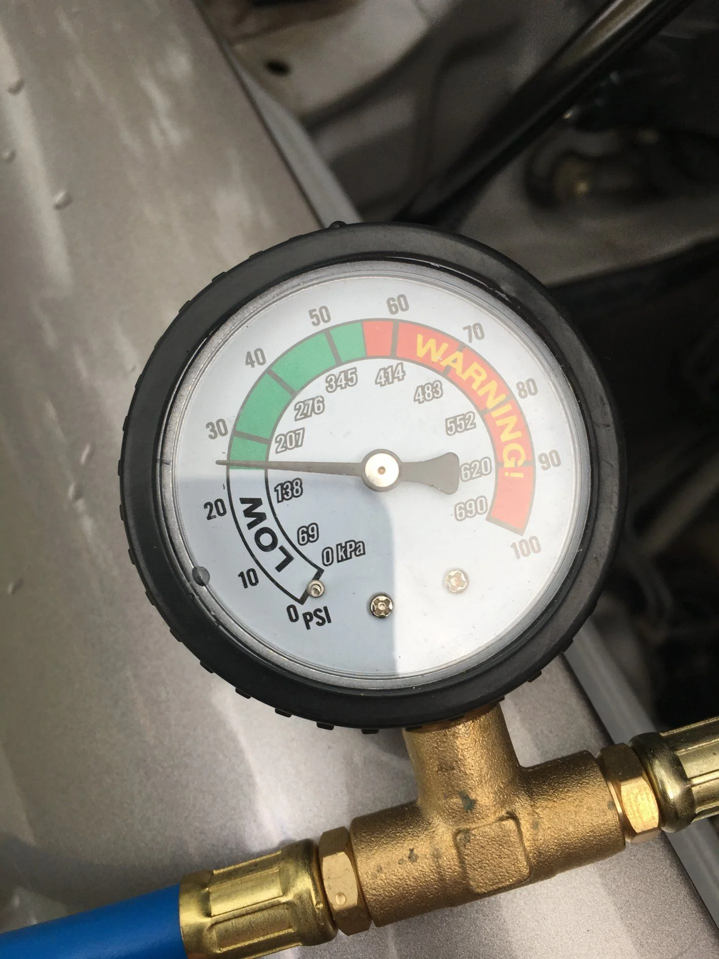

Here’s the readings this morning with engine cold. I can’t tell what’s going because it is blowing cold sill but it takes a little bit for it to cool. I’m leaving work and it’s 95. I’ll check readings when I get home and report back. I don’t have the guage from auto zone so not sure if this is reading correctly.

First pic is engine off and cold.
Second is with front and rear AC on.
Third is just front AC.
Stopped by autozone and got these readings. Shrader valves leaking? Do I need to repeat the process of clear refrigerant, pull vac, test, and refill?
Schrader valve could be leaking. The local garage that evac'd my gas said that they replaced the low side schrader at no additional charge..it was leaking slowly. It seemed fine TO THE UNTRAINED eye. The test at the shop with with the evac and fill was only 40.00. If you're not sure, take it in and then talk to the tech after for advice and "next time" to you'll know for sure.
