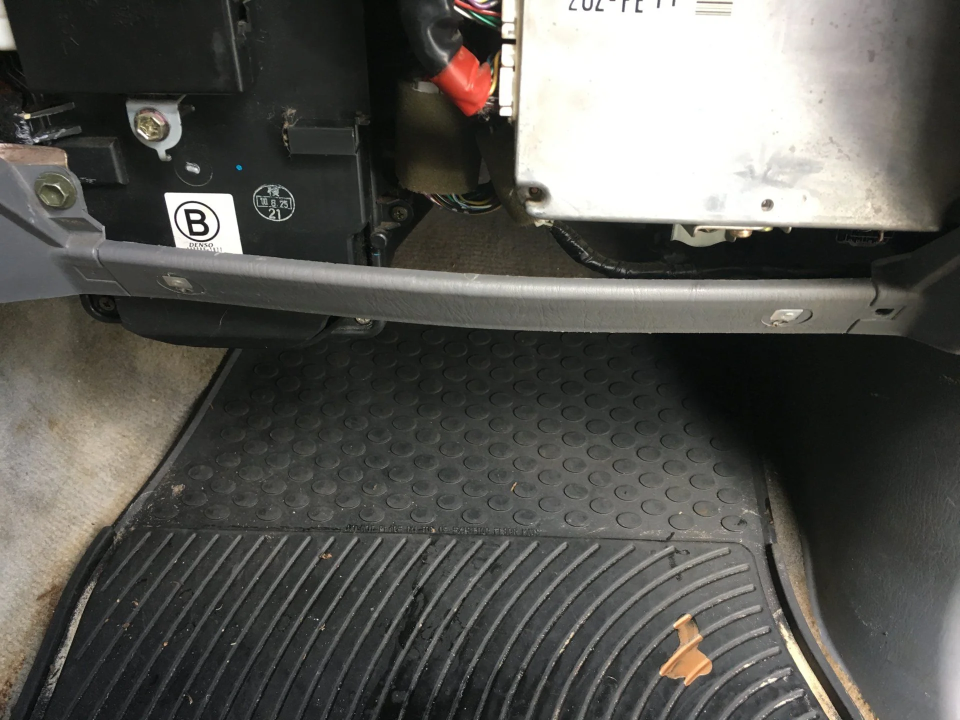

Where did you guys cut and what else do I need to remove from dash to pull evap? I’m gonna try get it done this Saturday and will try to take pics.
Gotta remove the phillips covering the core, there's like 6 or 8 i forgot. Then pull it out and under to expose the core
Right below the bolt that's to the left of the "B" there's a line in the plastic, that's where I cut. That same bolt, is going into a silver metal support, that might get in the way but you can squeeze by it.

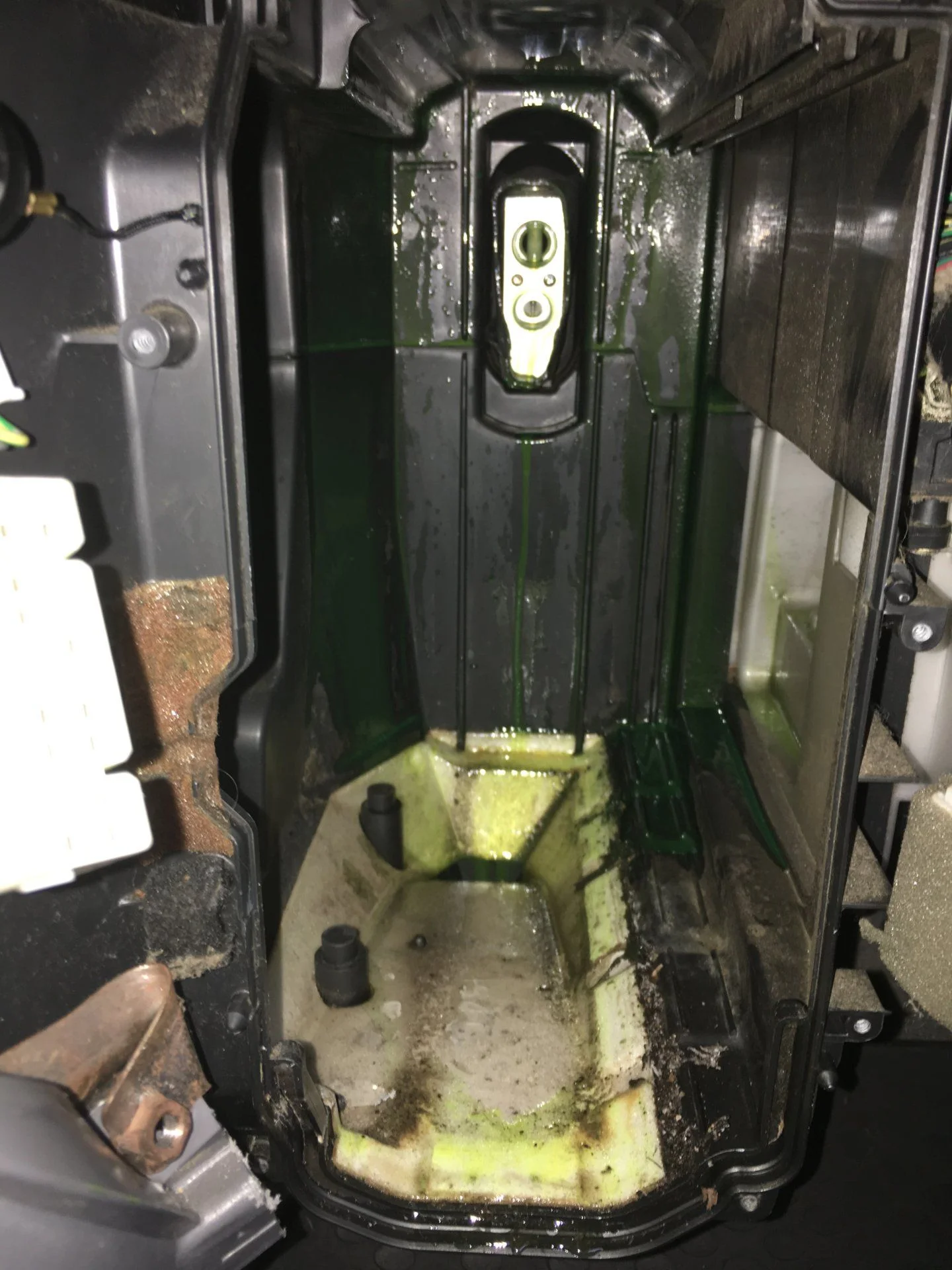

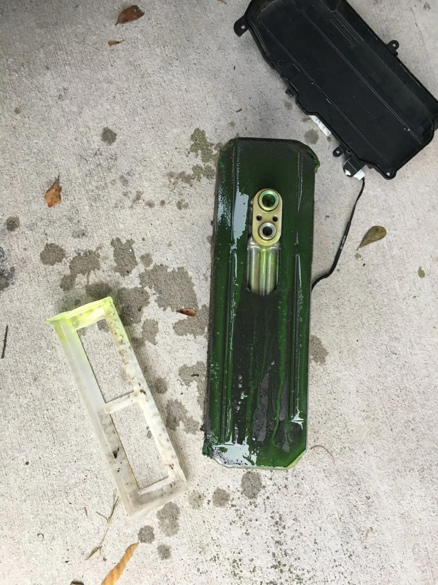

Here is what I have. I still don’t know if the evap is the culprit as it looks like it spewed the remaining dye that was in the system. I can’t see any other leaks anywhere on the evap.
Or this could be all the dye I’ve used leaking here? Thoughts? Expansion valve?
wouldnt that mean the evap is leaking like many people expected.
Looks to me like you took it apart with pressure still in the system and it spewed everywhere! How is there dye all the way up on the top of the front of it? Anyway, replace the evap, thermal expansion valve and all oring in those connections, then change dessicant pack and associated orings, vaccum it down and refill. You are very close to having cold air.
I took the pressure off until I could hear no more. I heard a hiss when I took the evap off. Did you use an evap from local store or Denso?
If you heard a hiss when the evap came off, all that dye came out when you disconnected the evap. Contaminating any evidence of dye from a leak. I just used 4 season on the evap and txv.
Take your uv light and shine it inside the fins and the bottom front of the evap. Do you see dye in there? Or is the whole evap covered and fins drenched.

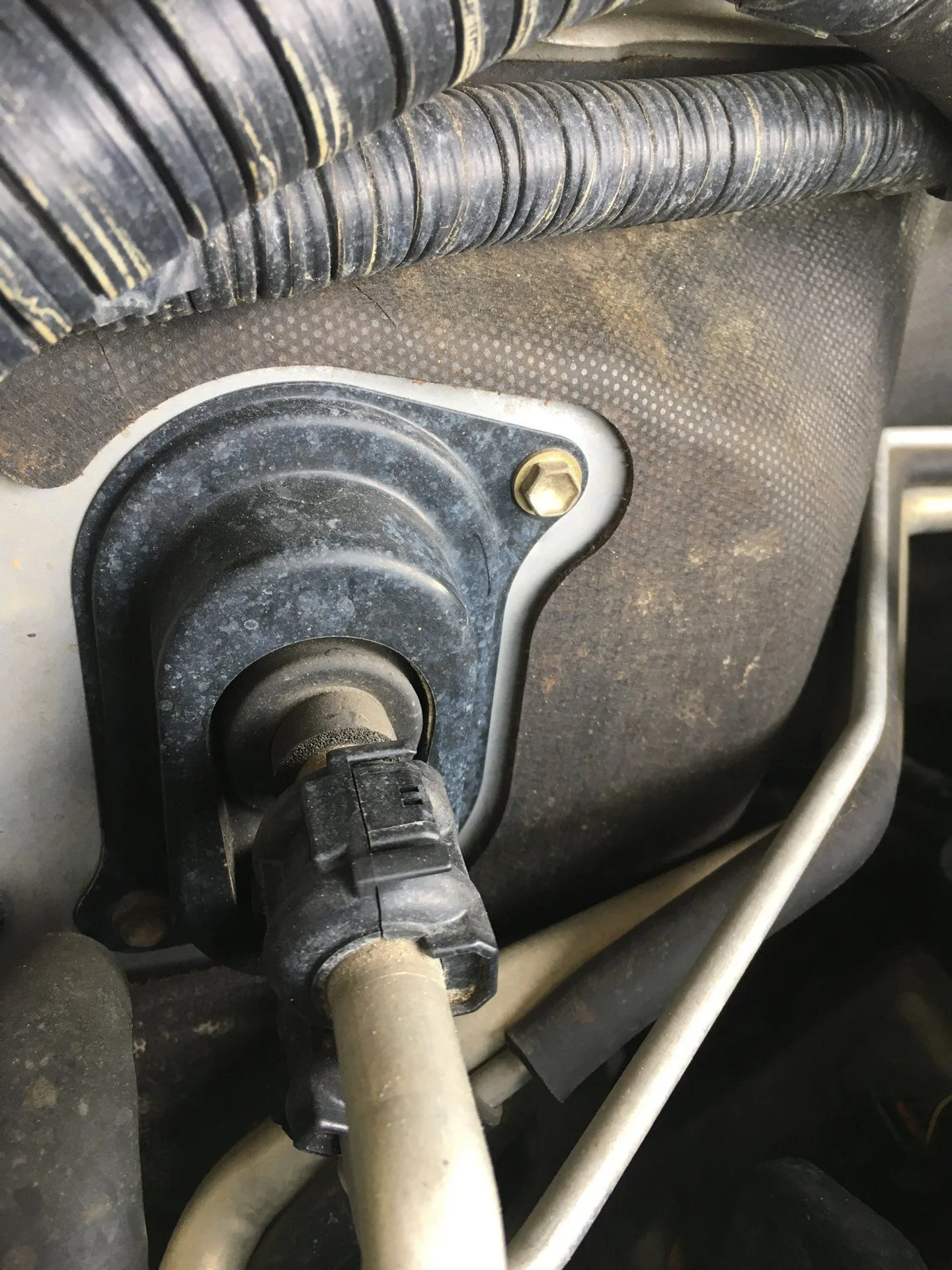

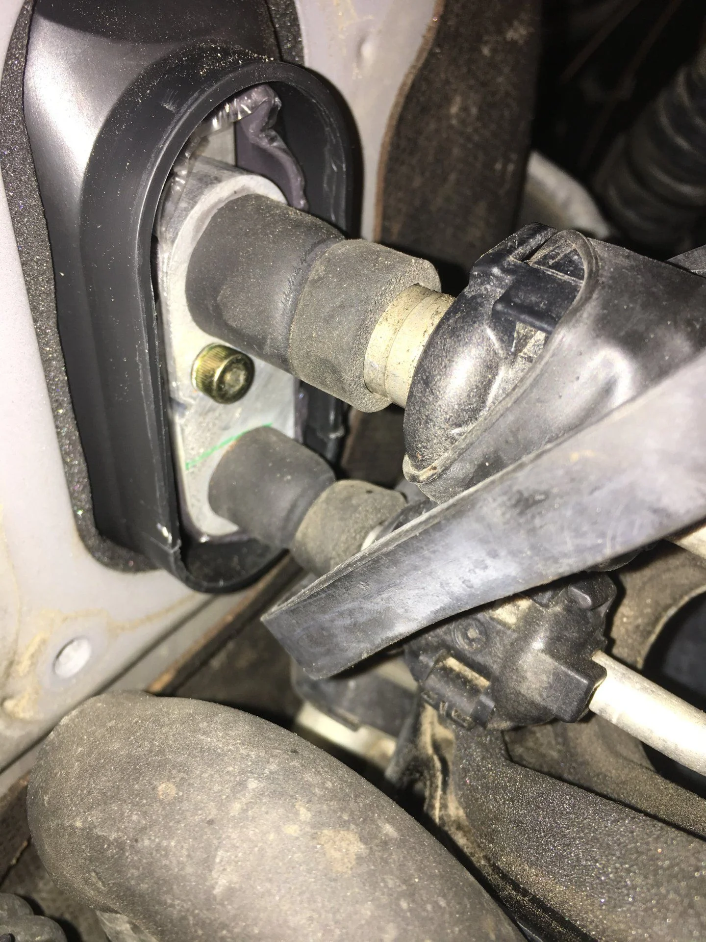

How did you remove the expansion valve? There’s some rubber around it and it’s stuck on pretty good. There’s some plastic clips that hold two lines together. Not sure how or if I need to remove them to get the expansion valve off? How do I remove without breaking?
I rented the light kit but I didn’t see any dye on the fins.
Just take the plastic clips off, use a pick or Jewelers screw driver, I forget if you pry the clips up or push down on them but a little fiddling and you get it. With the clips off push the whole thing through, pull off from the inside.
You can bend a paper clip (or similar) wire over into a horseshoe shape. Insert both ends into the two holes on the anchor clips and it will release. Then slide the tubes apart.
