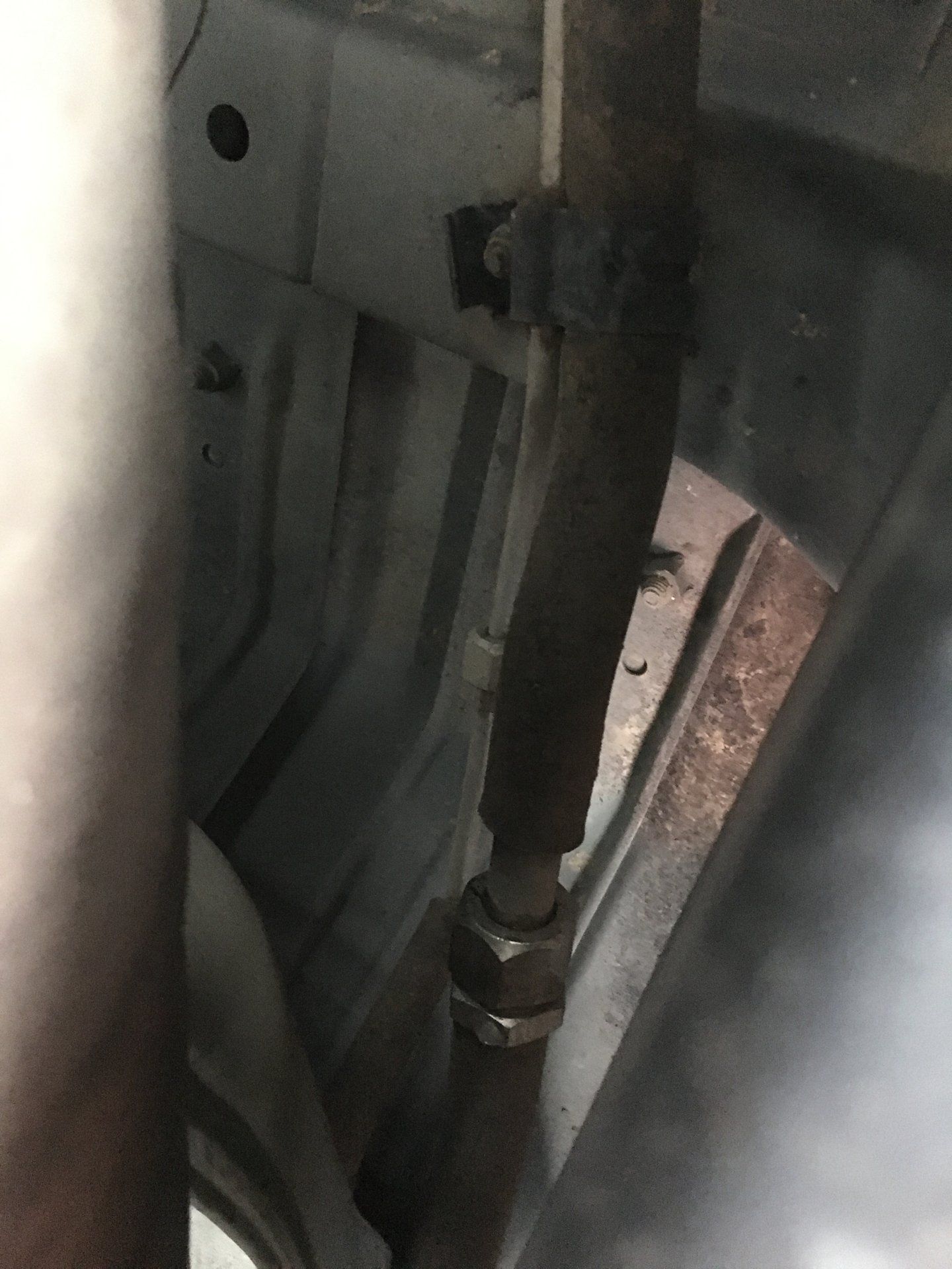

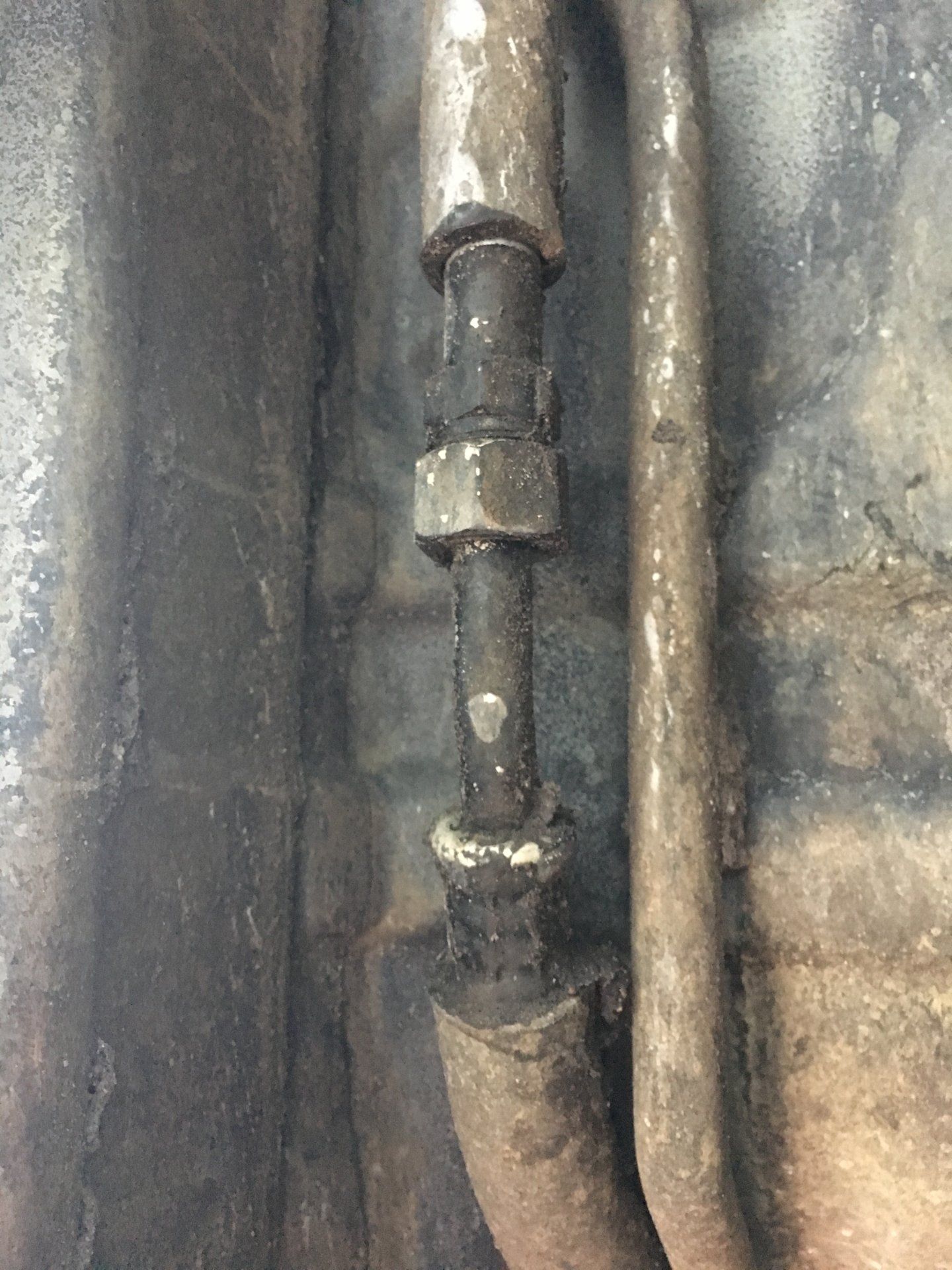

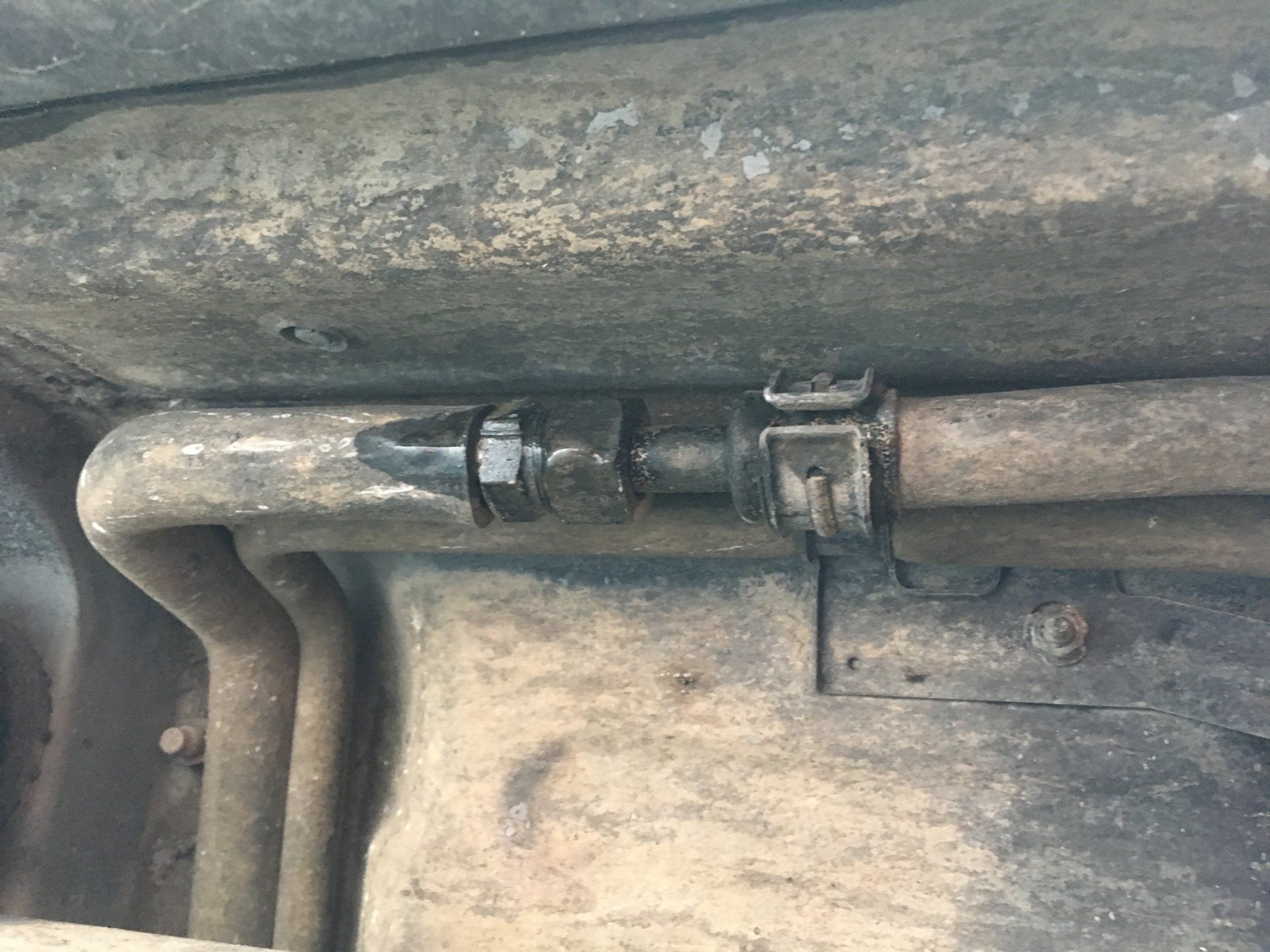

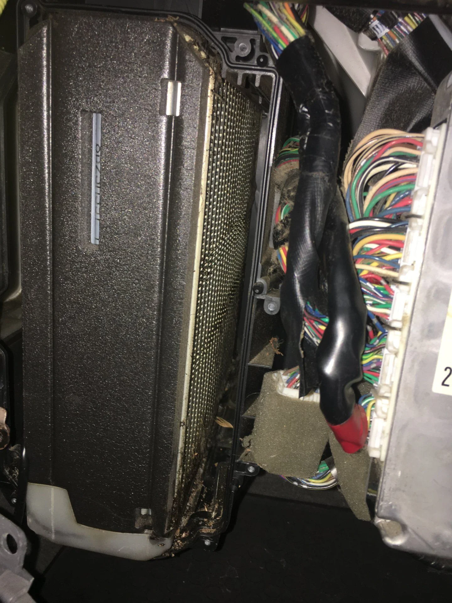

Rented a light kit from auto zone $100. Went thru all the engine tubing, under car and in evaporater. Evap looks really clean with slight debris. Took a pic. Need to see what the rear looks like.
I can’t tell if evap is leaking from bottom since I can’t pull it out. Anything else?
Look at condenser out front. Also trace the rear ac lines next to the Frame to the Rear evaporator.

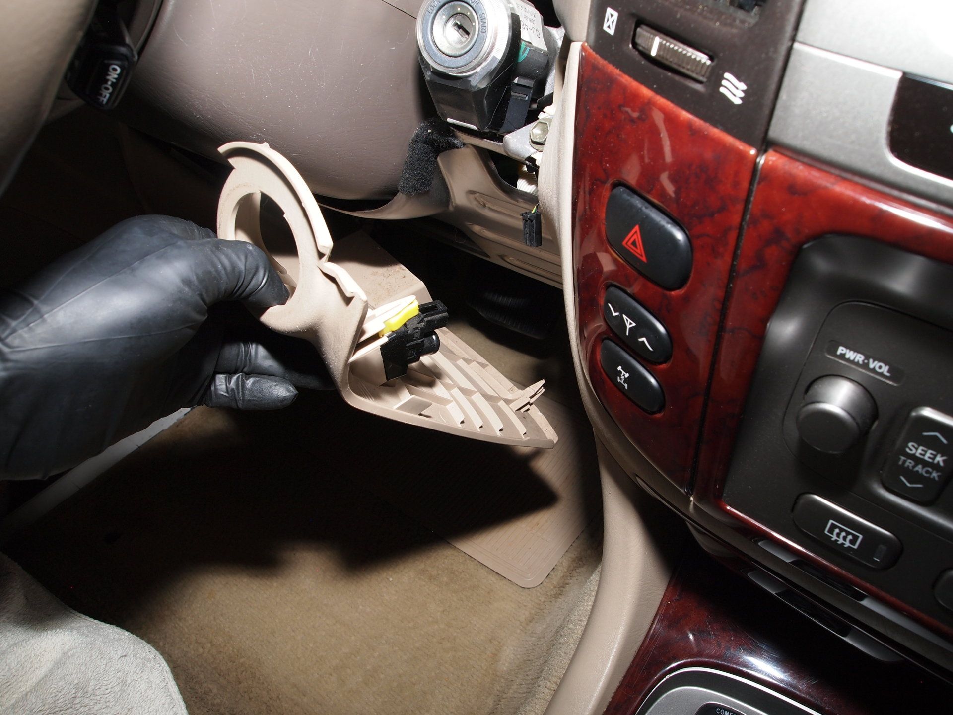

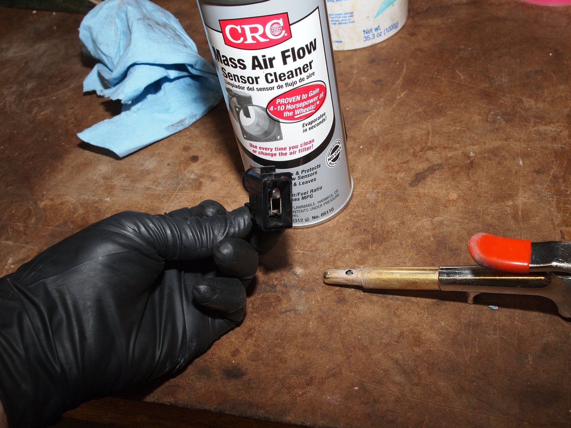

Did you turn AC to cold, not just a low temp. I've seen a few times, the sensore tube falls off. I'll get warm air unless on full cold when this happens.
Just below ignition key is little vent. Behind that is a sensor with tube attached and a wire. The tube falls off sometimes. Then AC only blows cold on full cold setting. Sensor can also fail.
