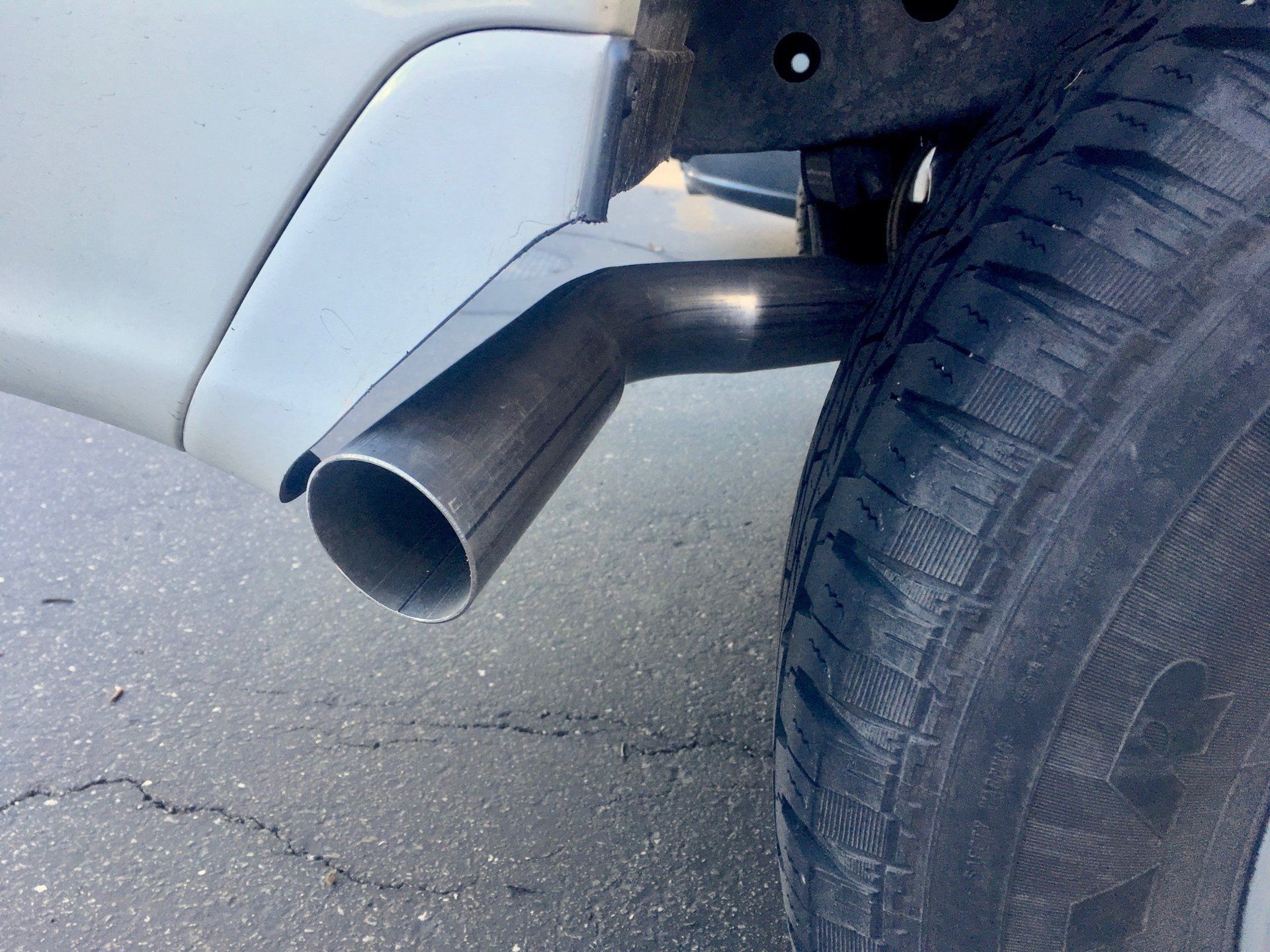

I cut off my resonator near the turn and have it dump into the wheel well for just this reason (and I don't smash it on rocks).

Now my exhaust turns and comes out behind the rear tire so no more worries.

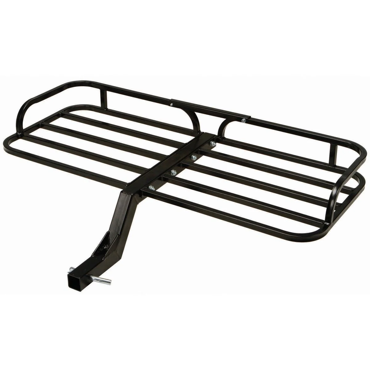

I use this higher mount carrier when needed. Keeps it up and away from the heat. Works fine, $50 from harbor freight.
I melted a camp dry food bin container and overheated two 1lb propane bottles inside it! I'm not sure why I stopped but sure glad I did. The propane bottles were simply hissing due to over pressurizing but if those relief valves weren't working, I'm not sure I'd still be here today.
I too melted a storage bin strapped to a hitch rack. On the back of my '05 LX470. Melted the bottom of it straight through all into the expanded metal of the hitch rack. I think I was carrying bottles of water in it at the time, iirc. No big deal. But, taught me what I wouldn't be doing next time. And then the next time I did need the hitch rack, I was kinda in a pinch so I ran out and bought one of these from HF and mounted the hitch rack up higher. Worked a treat other than sticking out another 6" or so to the rear.
Not sure this would work on the GX470 though with the back door...I'll try it out and report back.
Multi-Use Ball Mount and Hitch Receiver
Wow I'm surprised by all the carnage in this thread!
I was also surprised that it only cost me $80 for a proper resonator delete:
Although our hitch rack is up high it still gave me peace of mind. Plus, like Dan said, harder to smash on rocks!
