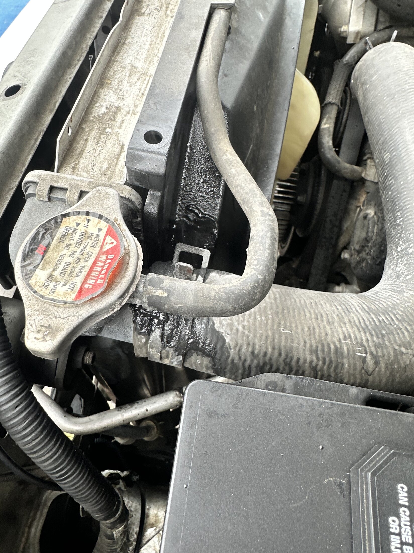

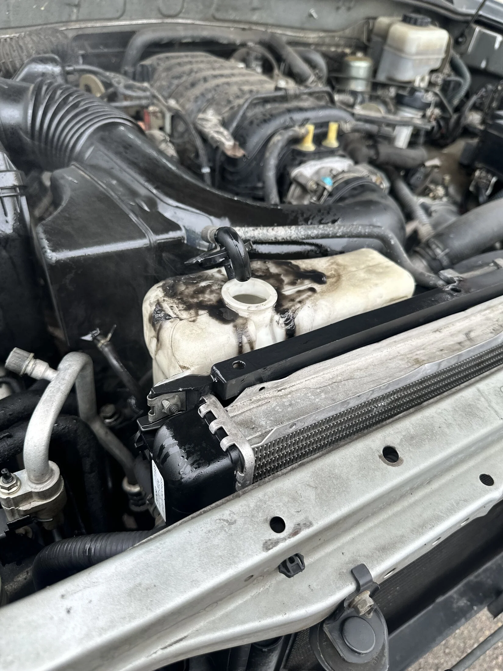

On two hour trip the other day my 2006 4runner v8 w/220k started steaming off coolant from the over flow and neck. The temp gauge never increased.
Quickly pulled off the freeway and shut it down. Called a tow truck and towed it to a shop.

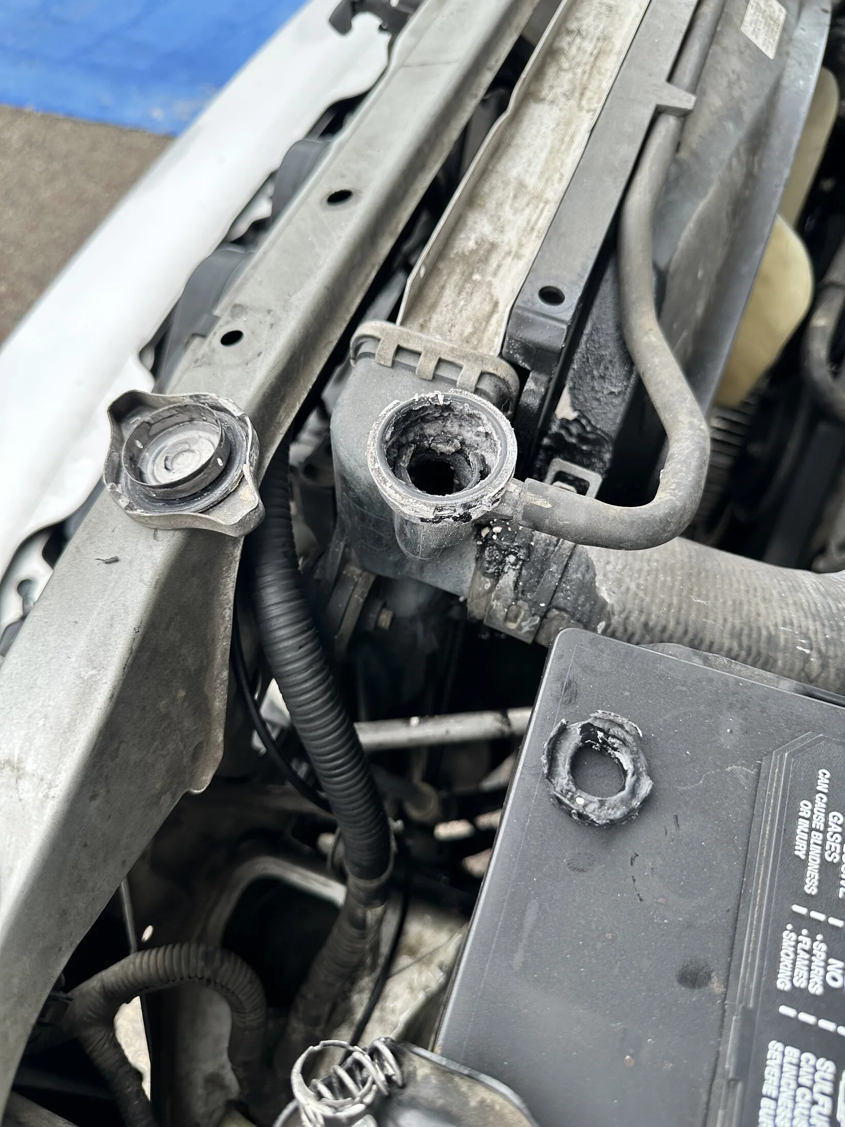

The radiator was two years old, although the plastic was melted on the neck and I’m assuming internally. Oil looked fine, I changed a couple weeks ago. Timing belt and water pump were still with in the recommended interval before replacing again.
Talked to the shop today and they did top off the coolant and ran it for a while. Was a little rough sounding they said. Also, had some bubbles come up through the neck of the radiator.

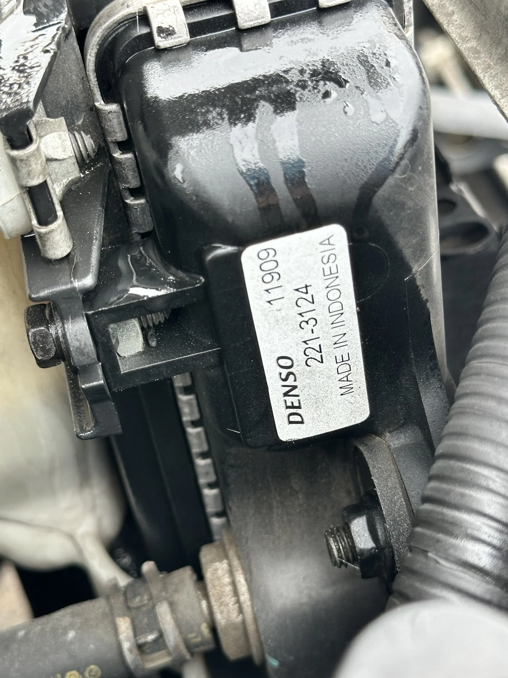

I’m having a new Denso replacement radiator being shipped to the shop along with a thermostat to see if the bubbles still persist, but it does sound like a blown head gasket.

Replaced the radiator, thermostat and gasket. Seems to be running fine with no bubbles. Going to keep an eye on the coolant levels and instal or update the temp gauge

Anyway, the radiator and fan clutch are the first to get replaced if there's no history on the paperwork. Typically, the fan clutch and radiator are cheap insurance every 100k miles when the timing chain/water pump kit is done. And heads up, way too many shops that don't specialize in Toyota really shouldn't even take on the TBWP if they don't use AISIN and go along with the little things, especially on VVTi. I've seen vehicles where customers paid a shop $3000 for the 'full water pump kit' only to have the belt fail within weeks because the shop didn't include a new tensioner or similar part. I've never seen an OEM radiator melt. Ever. I would have bought a dozen lotto tickets after dodging that bullet but you did the absolute perfect thing in a stressful situation. Good job!
